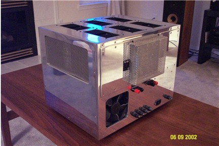

I constructed this case with fan cooling for my A75. The fan is a 24 volt run at 12volt, very quit and cooool. It is pretty much out of the A75 article, the heatsinks were surplus and this seemed the best way to provide for the heat dissipation. If I want to increase the bias I just have to turn up the fan. Plus I think it is a great looking toaster, or that is what most people call this amp.
Bryan

24v DC FBK Panasonic. I used a pass transistor off of the regulated DC power supply with a variable pot at the base to adjust the voltage to the fan. Its been 7 years since I finished the amp and the fan is as quite as when it was new.
I would agree with other posts about the potential for electrical noise to be introduced into the front end, but with proper layout it should'nt be a problem.
Bryan
