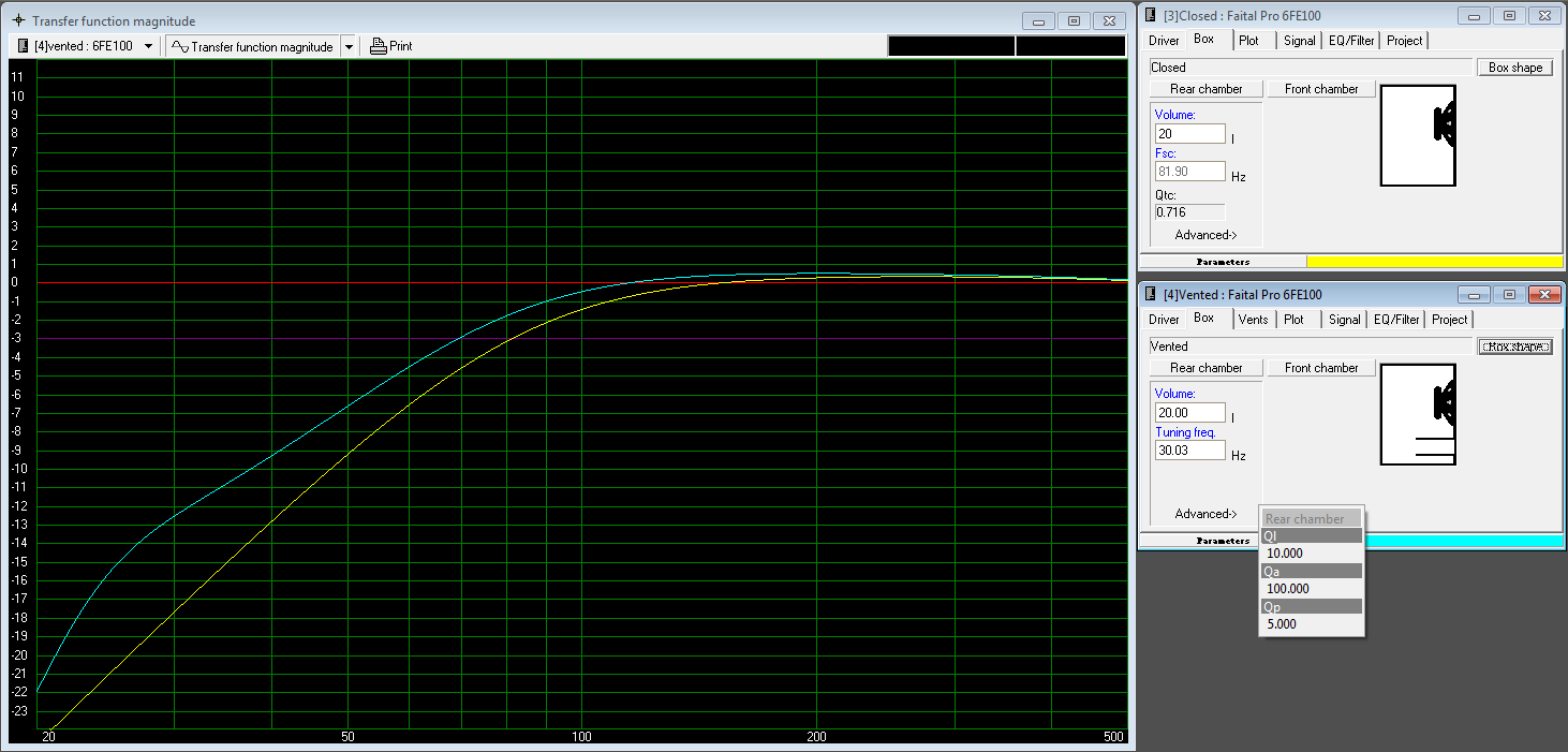

This is something I've wondered about for a while. This might be best done with a driver that already works well enough in a sealed box. Build to Vb resulting in Qt~0.7, add a vent tuned so the obligatory EBS peak is ~10dB down or more, stuff the vent to a simulated Qp~5.0-10. f3 and f10 seem like they would extend an extra ~10Hz in the case here. Roll-off is similar and perhaps a tad shallower than sealed Qtc=0.7.

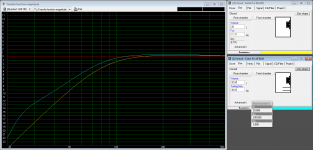

To avoid a ridiculously long vent, it needs to be kept rather small in diameter. I have 1.5" x 6.375" in the below simulation. This would be problematic if unstuffed, but stuffing the vent appears to reduce air-speed and group delay to reasonable levels, where the response is already down 10dB+ by then anyway. Cone motion is generally better on the damped-vent version, except really down low, ~25Hz and less. This should not affect performance too much unless you enjoy huge pipe-organ or dubstep at high SPL or intend to watch action movies.
Faital Pro 6FE100 in 20L:
I don't think I'm the first one to come up with this idea. Is it done and does it go by any specific name? I don't see too much drawback from simulation. Would there be issues I did not consider here?

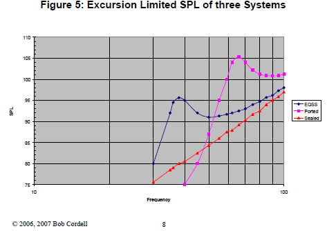

I snipped this from the paper linked in previous message #10

From WinISD simulation, again with Faital 6FE100 in 22L, both sealed and ported to 30Hz, the port being stuffed to Qp=5, I get the same benefit in increased ELSPL, until the vent simply unloads, below 25Hz or so, as also shown on Cordell's above graph.
I think I came relatively from the same place with my idea, but higher ultimate SPL was not my aim as much as lowering f3/f10 a bit on a sealed box. It seems like medium-high Qt drivers, such as the 6FE100 would pretty much require some vent stuffing to mostly kill the peaky output at this frequency. Doing the same with Fostex FF225WK, 19L stuffed versus vented to 30Hz and no vent stuffing (Qp=100), the response is about the same as sealed, ~10Hz lower kneepoint but no port peak output because of the lower Qt.
Can't fool physics and can't re-invent or (hardly) re-discover them. The Cordell scheme pretty much is what I was after, save for his implementation of EQ. I think I'm satisfied with it answering my initial question of "is it being done and what's it called". 🙂
