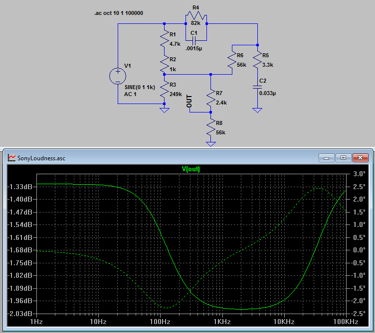

A fixed resistor from the loudness network to the wiper, using a value that mimics the loudness at a normal listening level? Maybe a larger value tied to the input pin instead? I'd appreciate your thoughts...this is giving me a migraine.

Volume controls in the 70's era pioneer receivers i've modded up - always noisy. The sony trick is a great idea.

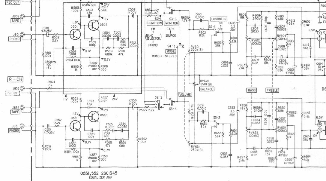

Not so easy with this one...
(scat here: http://elektrotanya.com/kenwood_700c_control_amplifier_sch.zip/download.html)

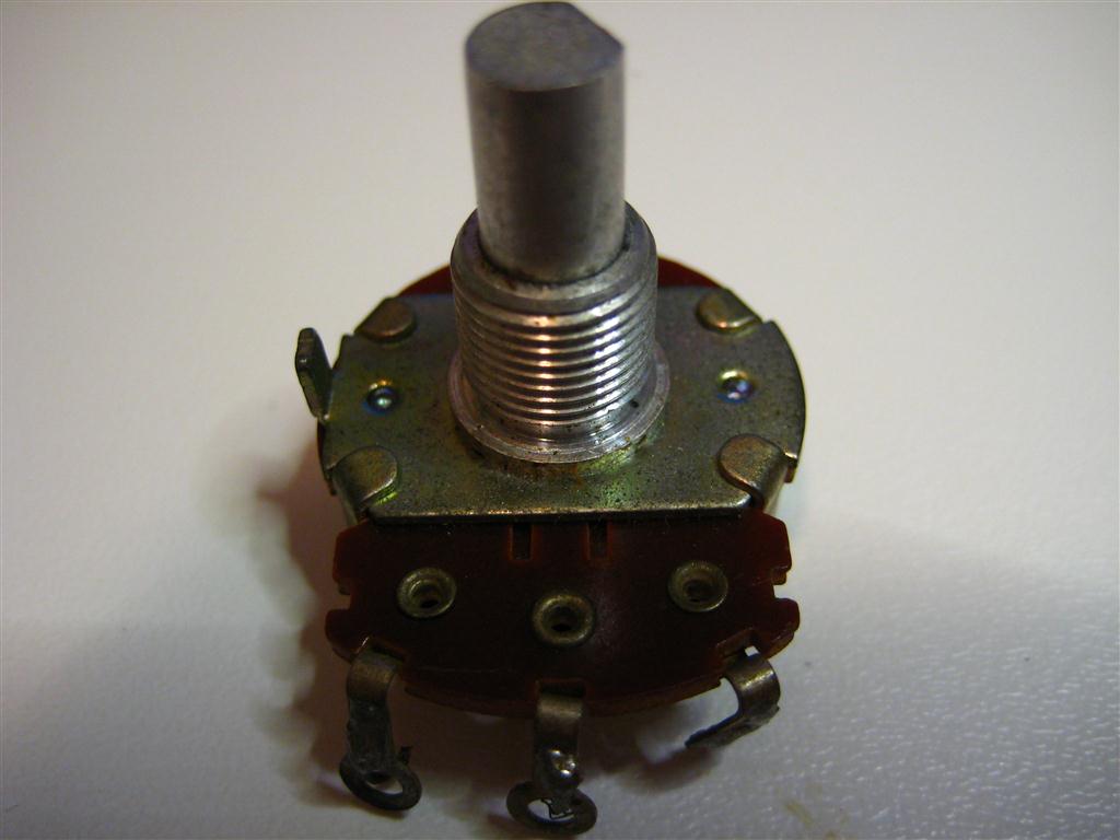

Tried that. Won't stay straight...wobbles like a clown car wheel no matter how I try (and I spent hours fiddling with it). Just too sloppy a fit. Tried wrapping the shaft in Teflon tape as well, and it helped a little, but it's just...well...weak, for lack of a better adjective.piece of cake, I do it all the time, just cut a piece of proper thickness plastic sheet (old credit card is perfect) and insert it in the slot.

Hmm... as above: fill the slot fully and tightly, use whatever you have on hand ensuring that it won't compress under the knob's setscrew pressure.
Wrap/wind the splined shaft with Ali heating duct tape (home depot) until it's built up to the desired diameter.

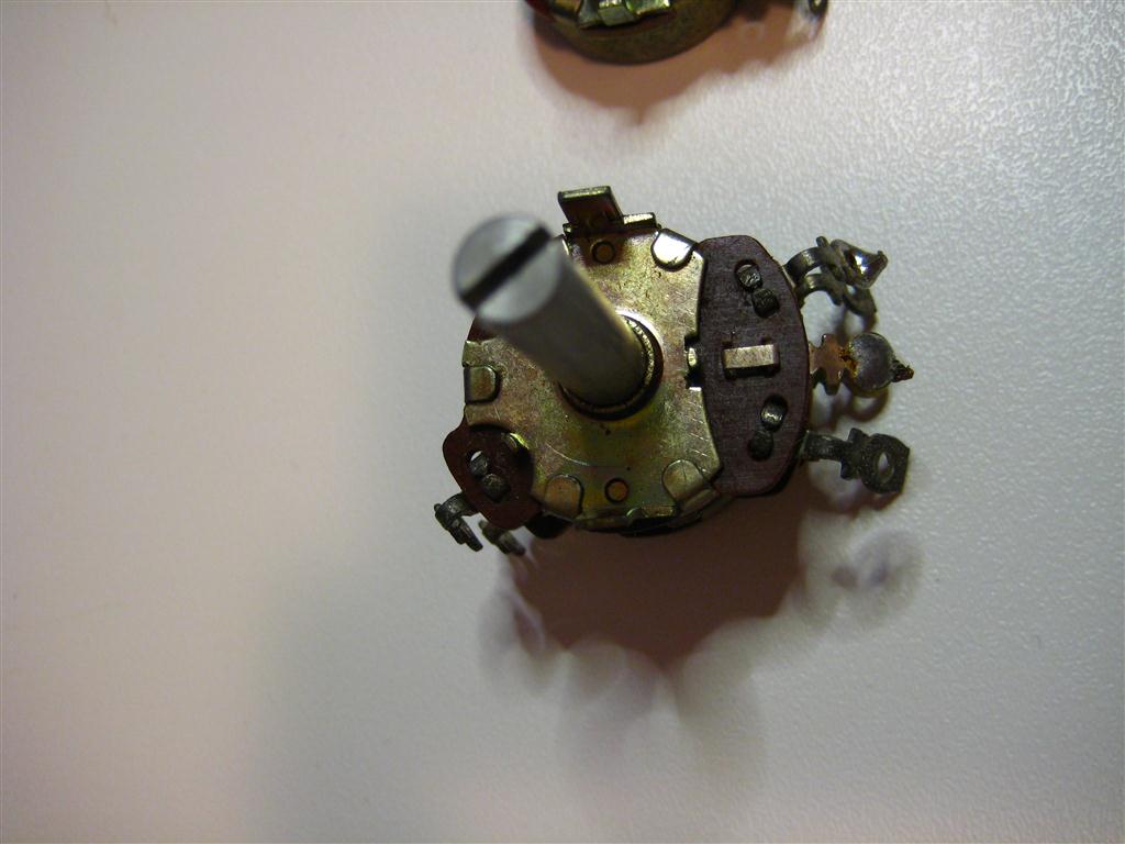

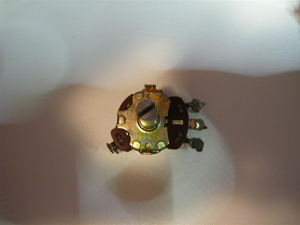

I take it the pot in question is one with the knurled spine and a split shaft. I found slipping a small right angle bracket in the slot is a tight fit and there is just enough room to fit the other end into a vice so you can file or machine a flat surface if that style of pot is what you require. The type of bracket is shown here Metal Right Angle PCB Standoffs Pk 8 | Jaycar Electronics New Zealand.

I've had success not filling the slot but instead making the set screw line up on the slot and tightening it up
I don't get a choice of where to put the screw. Gotta go 'here' if I want the volume control notch to line up with the faceplate display.I've had success not filling the slot but instead making the set screw line up on the slot and tightening it up
I may have found a solution. I filled the split with some dense cardboard, and wrapped the knurled shaft with copper foil that I use for PC board repairs. No wobble if I carefully tighten the set screws evenly.

Model engineering suppliers usually carry thin-walled brass and other metal tubing in standard OD like 6 or 6.35 mm. It may be difficult to find the correct combination of ID and OD but a little ingenuity with slitting the tube lengthways may wind up in a good, concentric fit.
If that is all too hard, heat-shrink tubing should be obtainable in a fairly hard plastic grade and various shrunk wall thicknesses. It doesn't really matter if the locking screw penetrates the plastic and it's not difficult or expensive to experiment with what's available.

You could fit an angle bracket in the slot as I described in post 11 and fix the whole in a vice where you can make a mark on the spline with a punch and hammer and then drill an indent hole wide and deep enough to take the grub screw for the control knob.

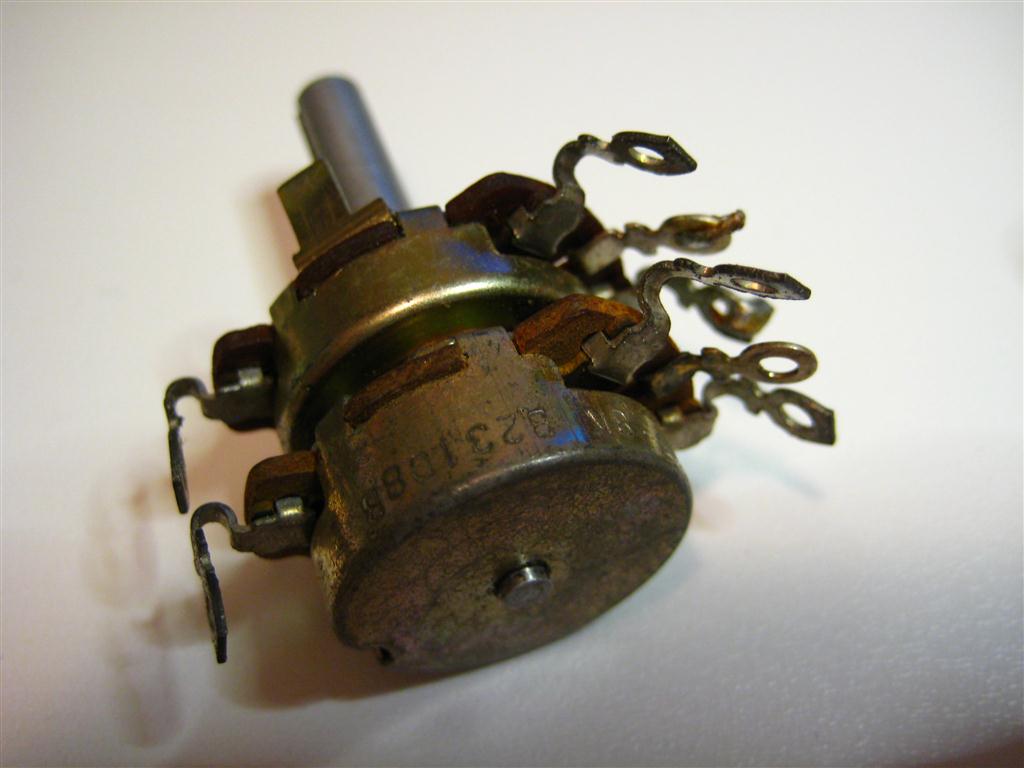

I dug through my bag of old pots, only got this:
50k, dual log pot, 1/4" (6.3mm) shaft, 27mm long shaft (no chamfer but center-split..it's very old, a Ducon made in Australia), complete with a loudness tap. You'd need to change the chassis tab mount over to a thread/nut mount like the last pot pictured, but it may do the job. It's smooth and tracks ok.
Any help?

- Faking a Loudness Tap
