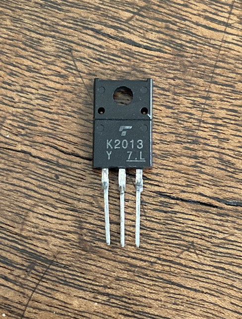

I'm trying to determine if some 2SK2013s I have are genuine or not. The case looks good (although the placement of the 'Y' grade marking is suspect: I think it's usually under the '2').

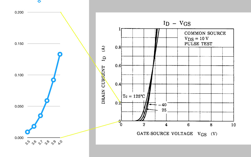

I did some manual curve tracing with a couple of bench supplies. This is ID over VGS, with VDS fixed at 10V:
792698d1573049865-fake-real-fujitsu-2sk2013_curve-jpg
While the curve looks about right, note that it's offset to the right by about 1.8V. I know the curve in the datasheet is only representative, but would there be that much variation in VGS?

My original Toshiba's all have the "Y" under the 2. Also the 0 has a break in it at the 12 and 6 o'clock positions.
As Dennis mentions, mine all test at around 1.9ish volts for Vgs.
Also the lettering is too bright, the originals were always dull and harder to read.

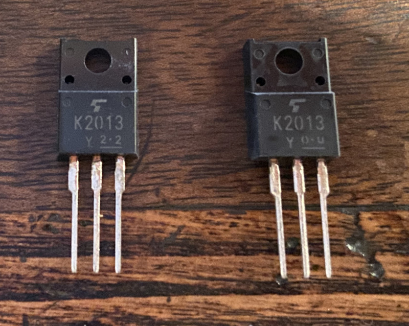

B&D part on left; Quest on right. (Suggested difference in size & reflectivity just down to camera angle.)
attachment.php
Both measure the same (Vgs in the 1.8V - 1.9V range, with similar curves).
And hey, how can you resist a classification of 'Y' followed by a '0u' date code?
Jeff.
