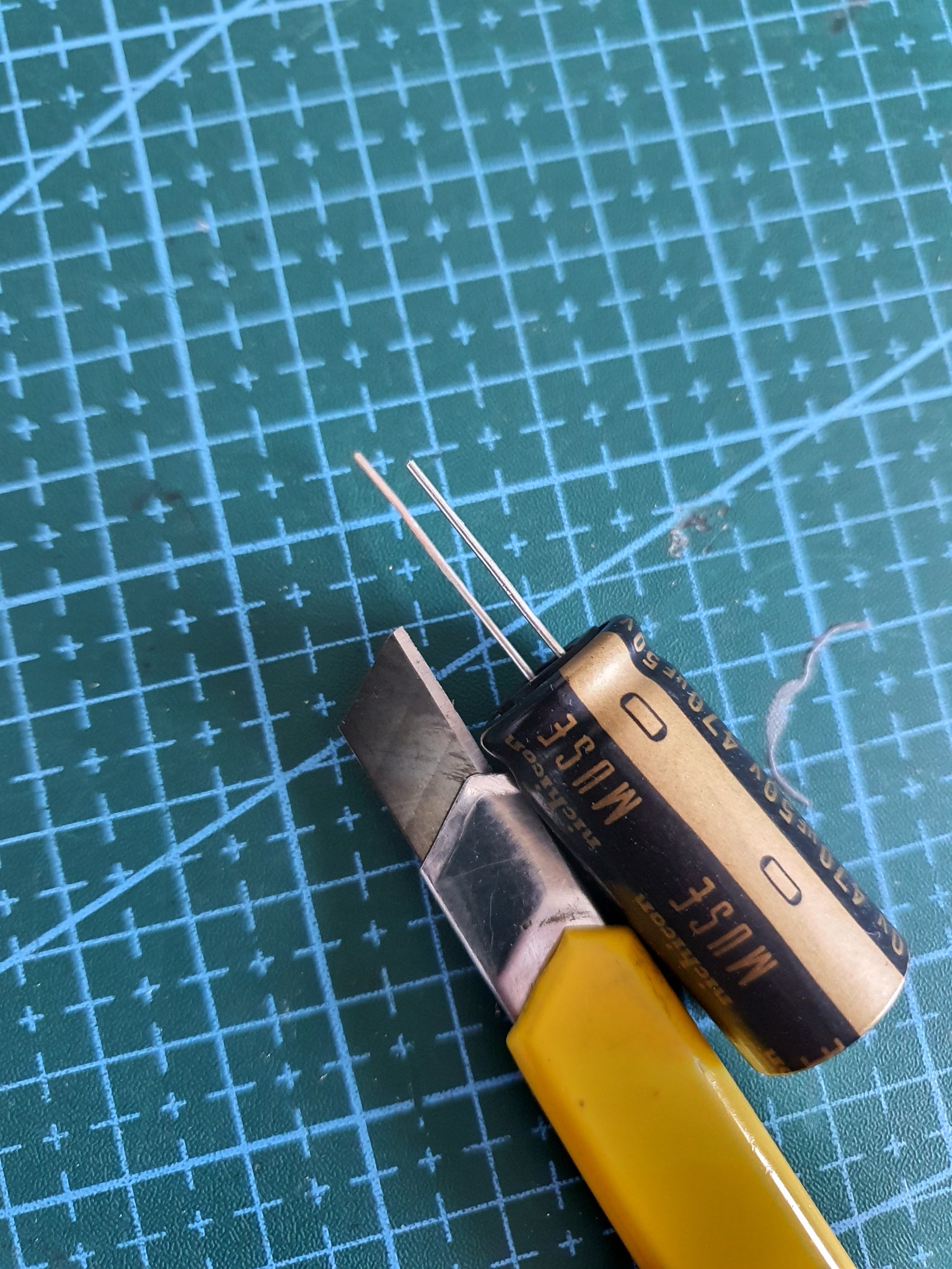

Fake Nichicon?
Don't know about the first one. I don't have any snap in Nichicon to compare. But the sleeve printing looks messy on the second one. In my experience Japanese capacitors, ICs and transistors all have very neat/clean printing/labeling/presentation.
The general consensus is do not get caps on Ebay or AliExpress. (Because of fakes.) Where did you get those two... ?
I can't see the seal on the legged cap and I agree with @kozard - the printing isn't up to the standard of the first one.
My experience here in China is that Nichicon is the most widely faked brand. To lower the risk of fakes, go for the less well known Korean manufactured (but Japanese origin) brands like Samyoung. Just my 2c.

Cant judge about the snap in but the KW? looks rather genuine to me - I compared the printing and the tarnished dark/grey almost black sleeve with mine of the kz. (I usually buy them from mouser). Gold fits also it has almost some green tint. The smaller caps of nichicon are slightly polished less silky and the gold is more brililant and leaning towards more yellow/red gold. As in your imgur second link visible.
This might also help ...for the through- hole
https://www.audiosciencereview.com/forum/index.php?attachments/1574664867105-png.40186/
at least a better fake 😉

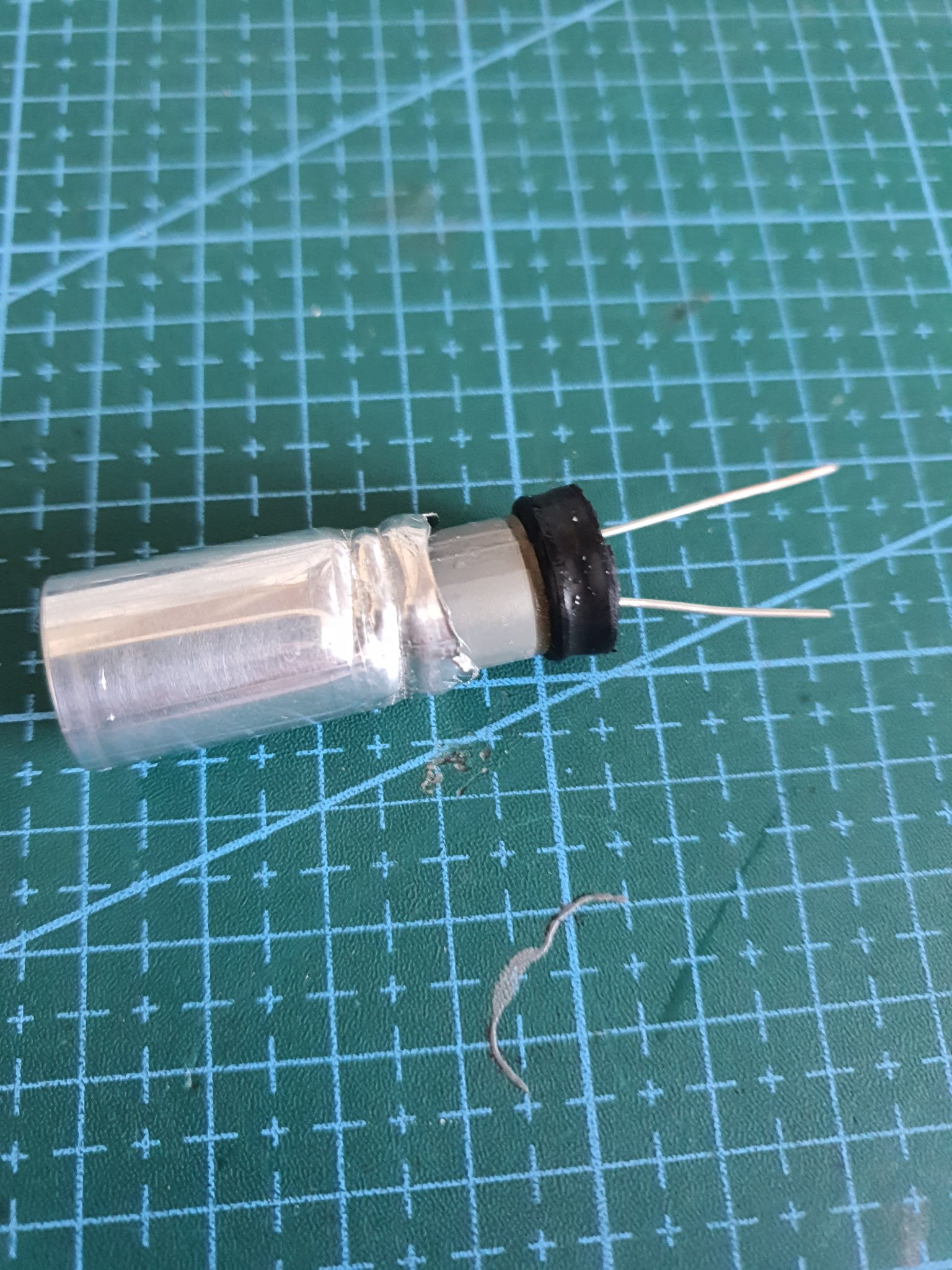

btw. afaik Nichicon uses tinned copper (OHFC even?) wire so a fake might have only steel ones.

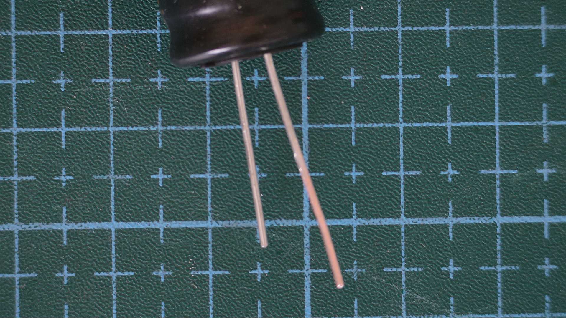

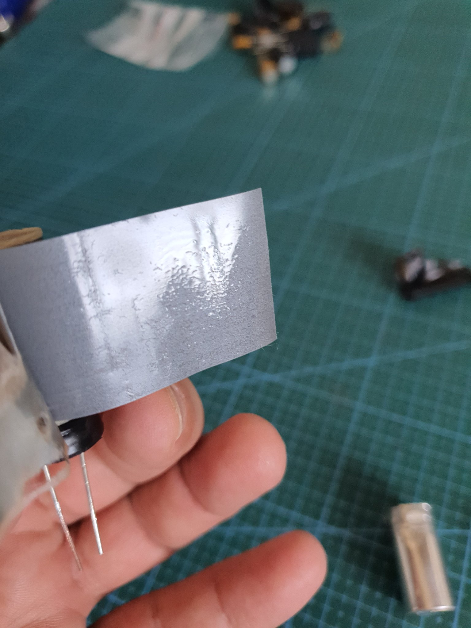

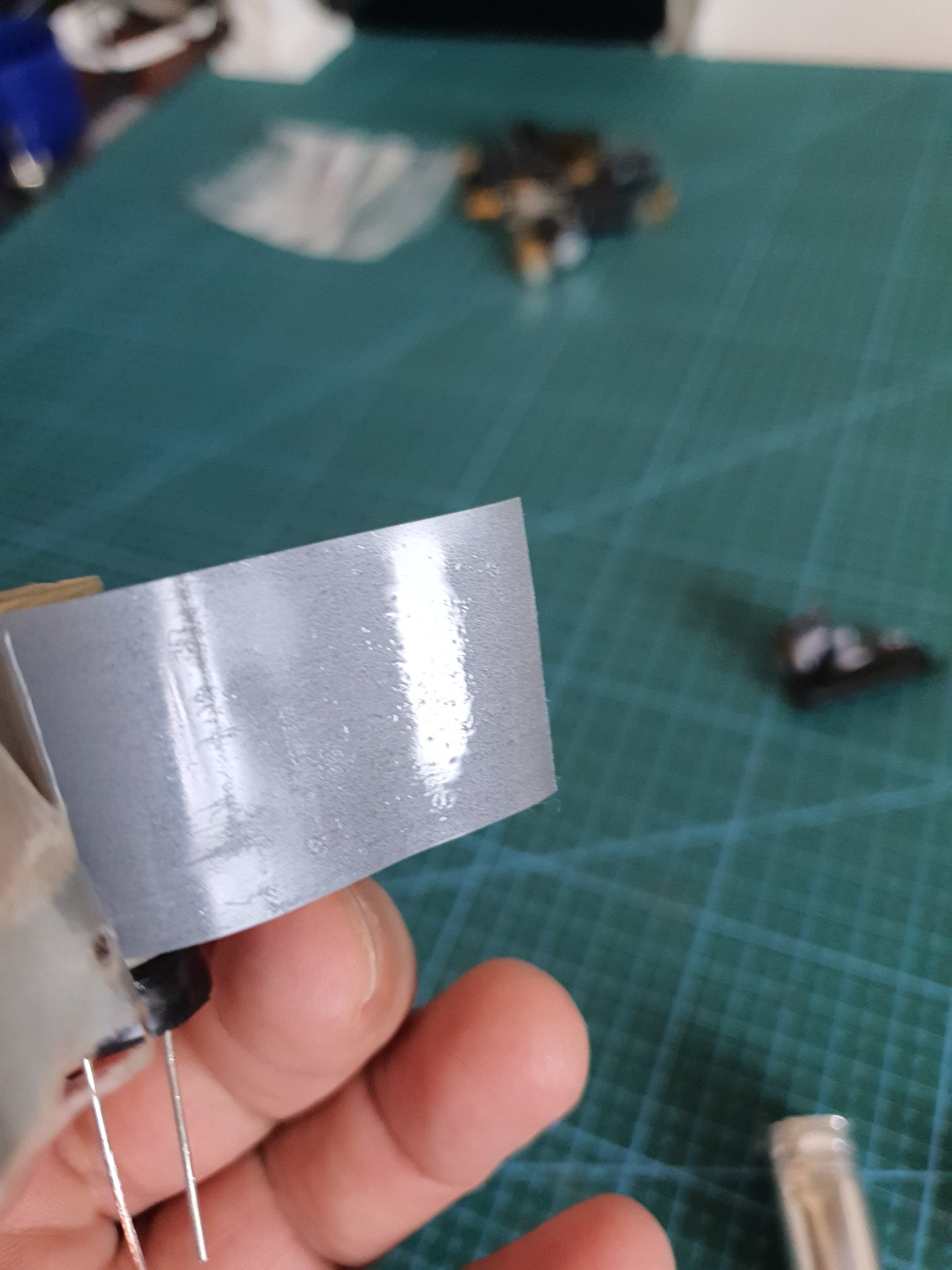

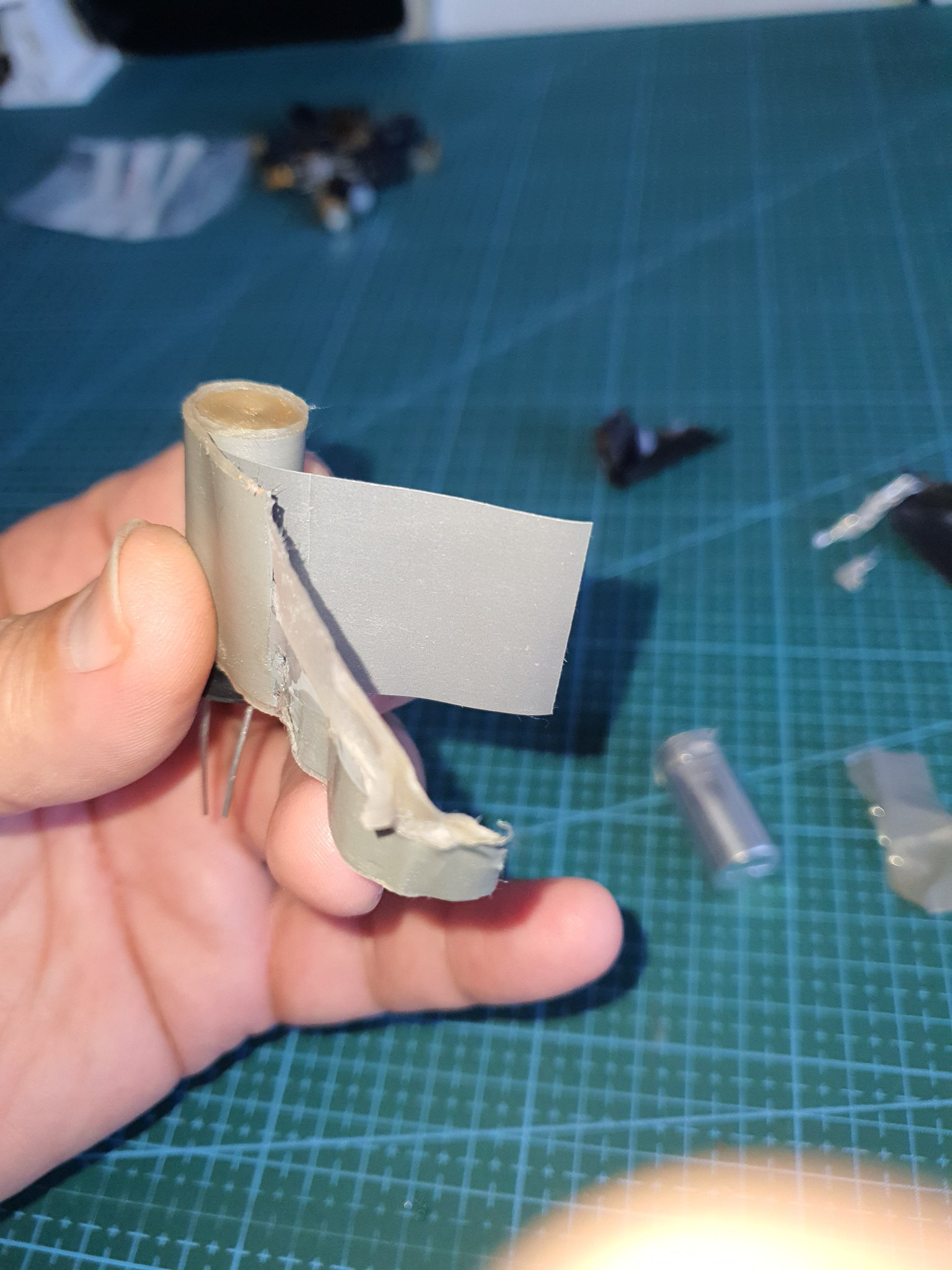

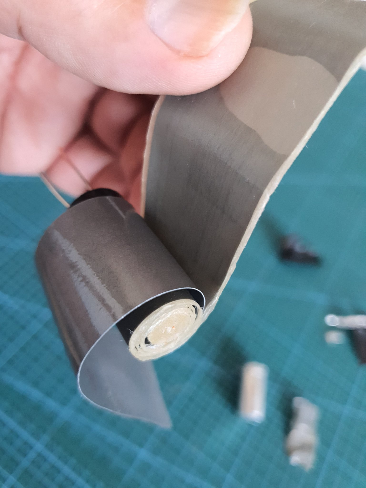

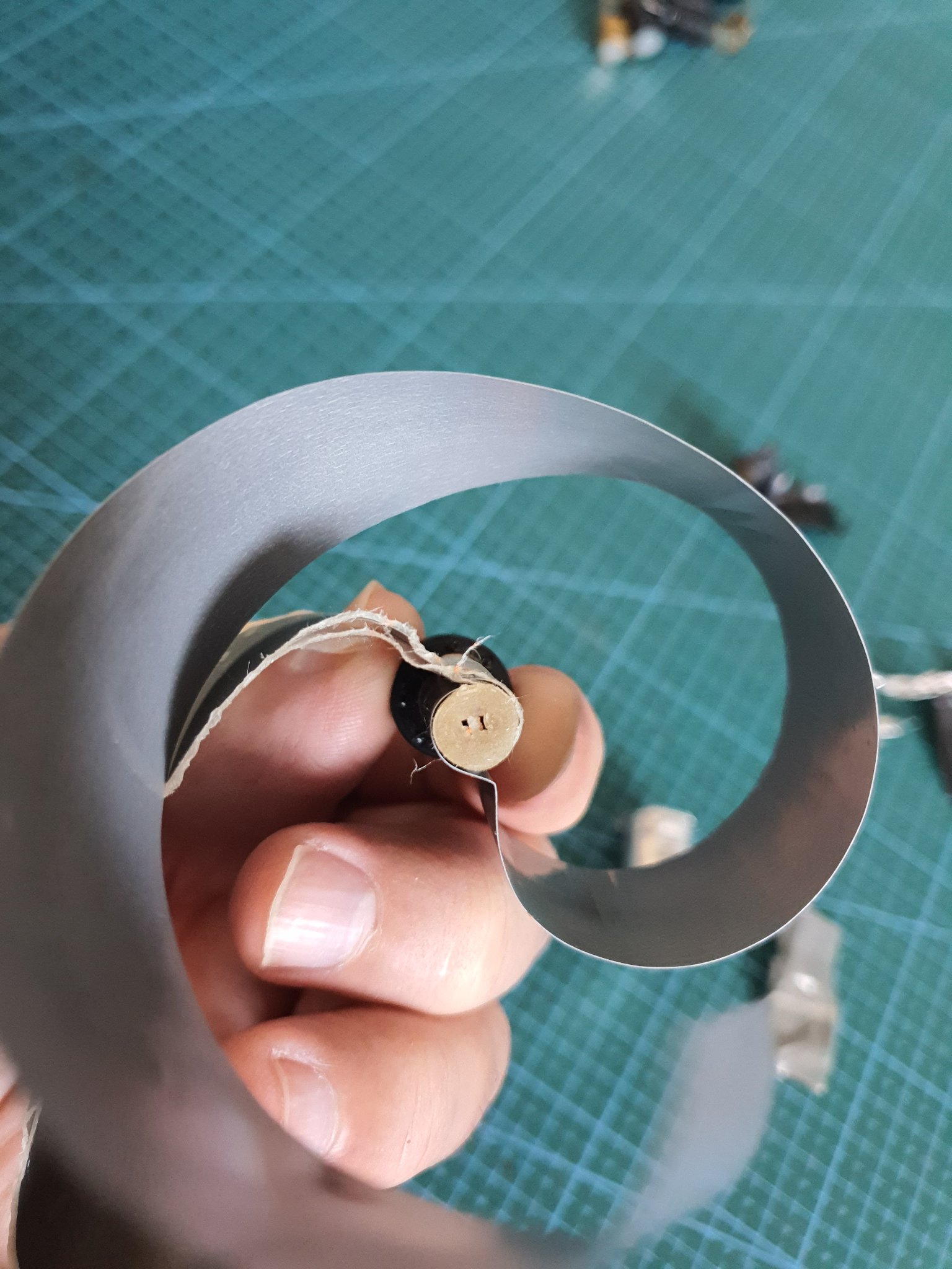

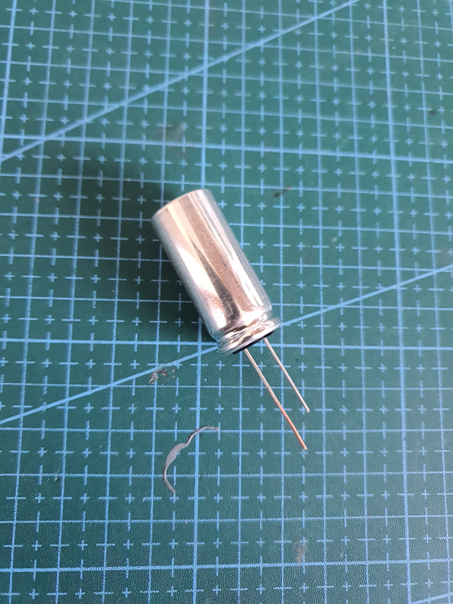

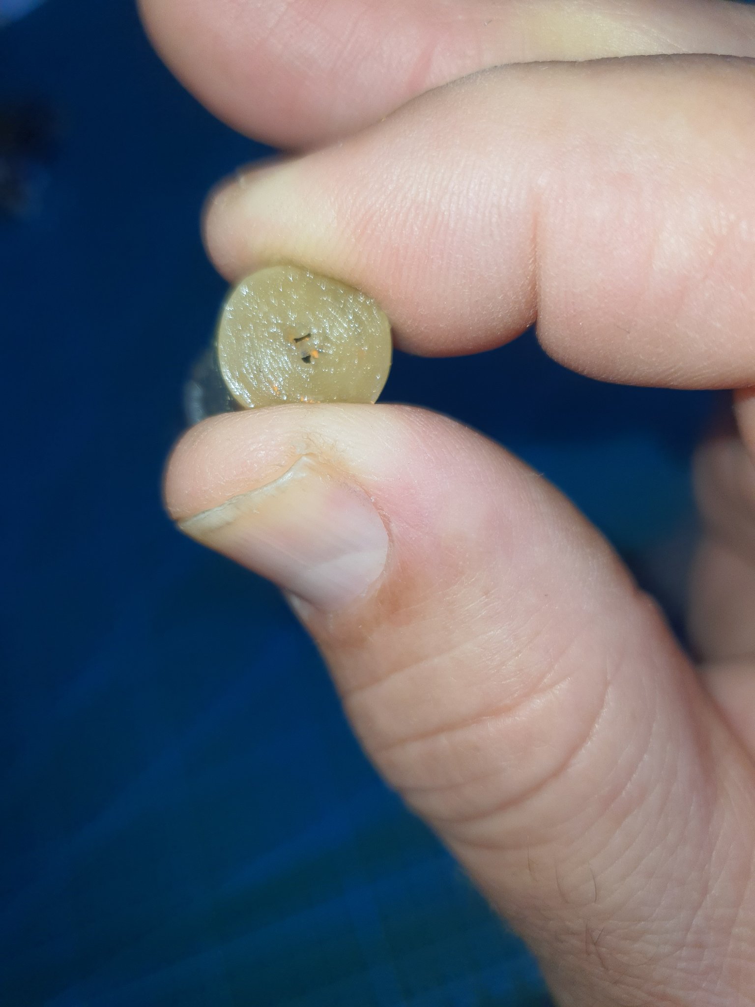

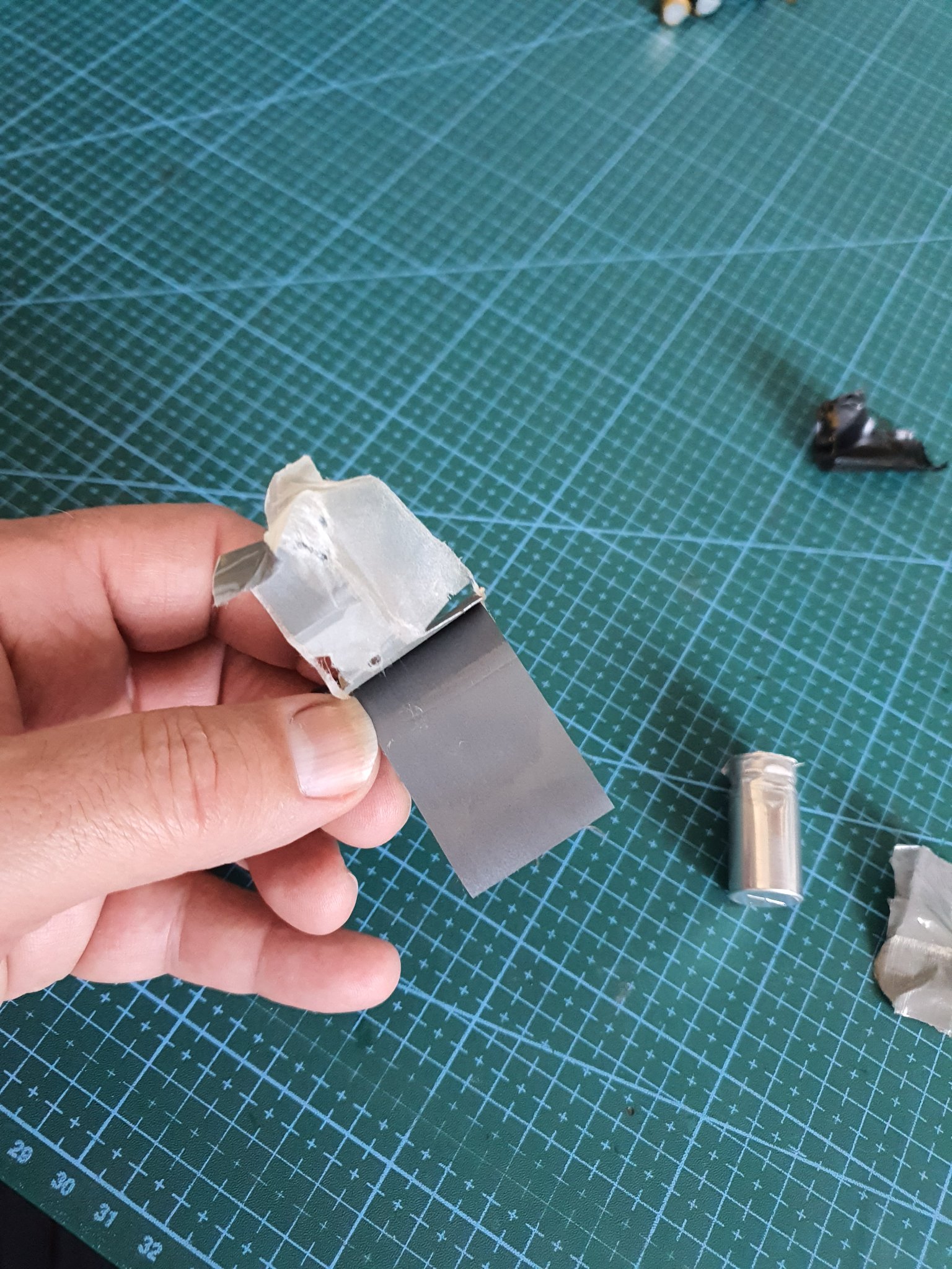

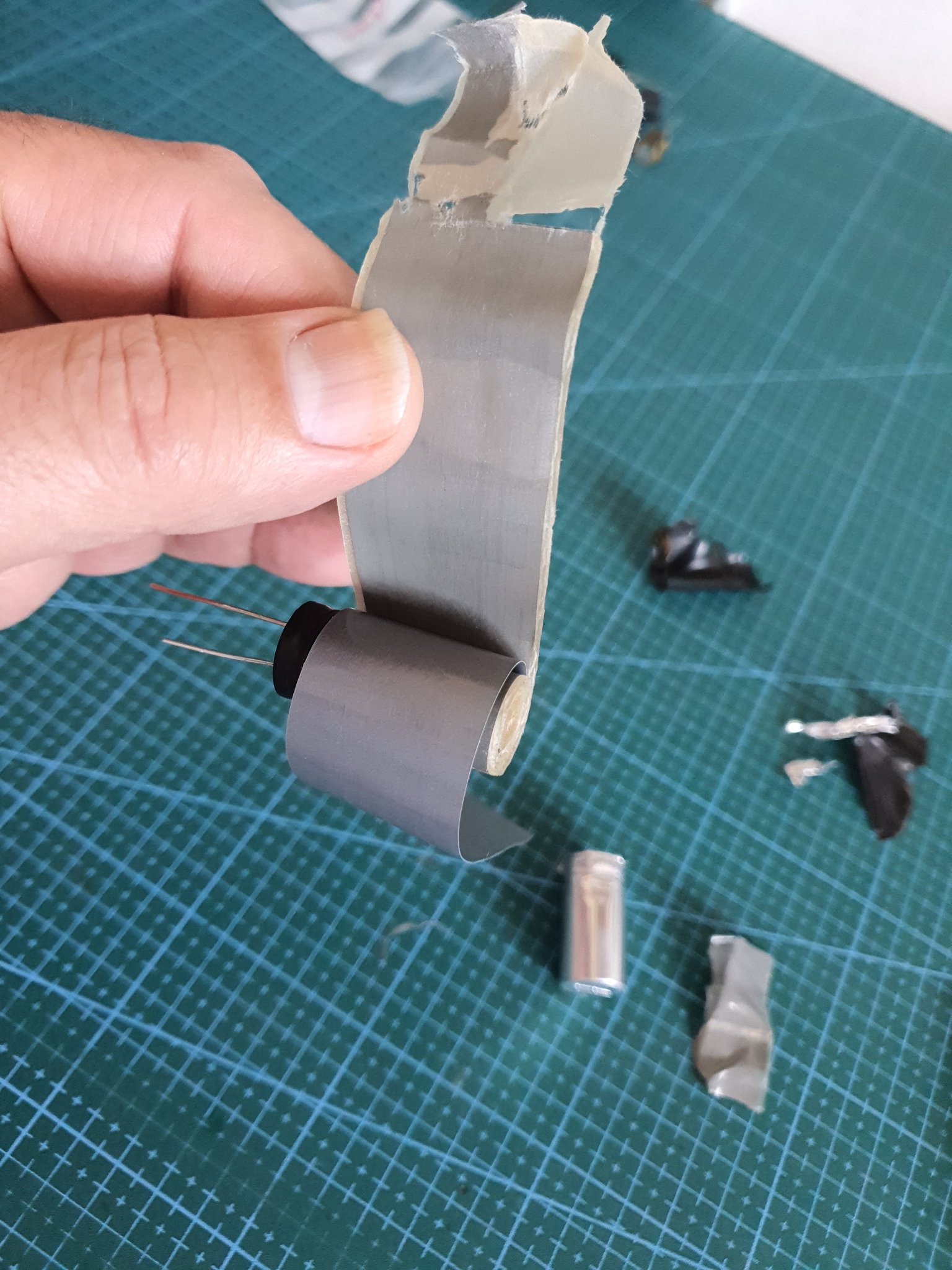

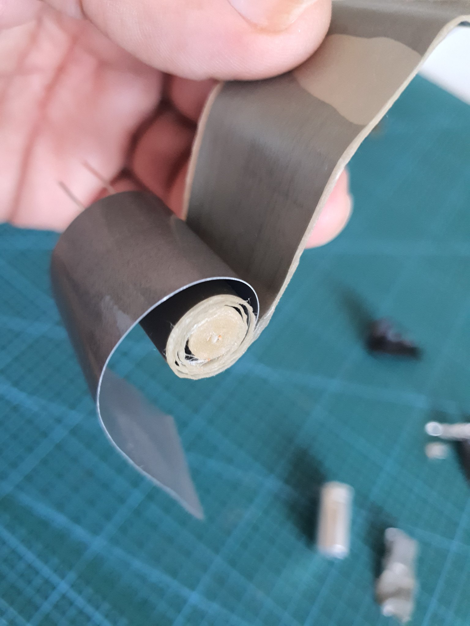

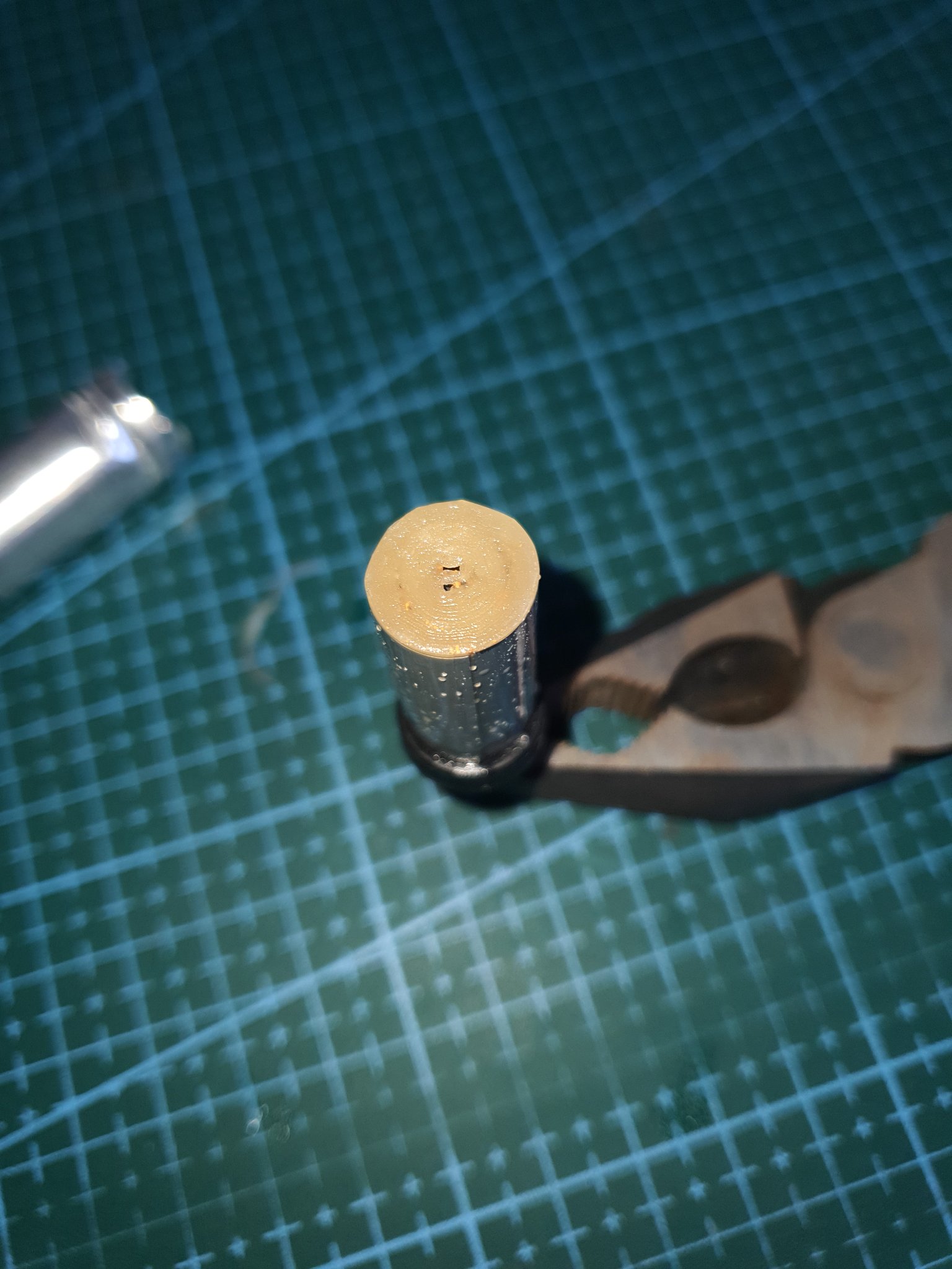

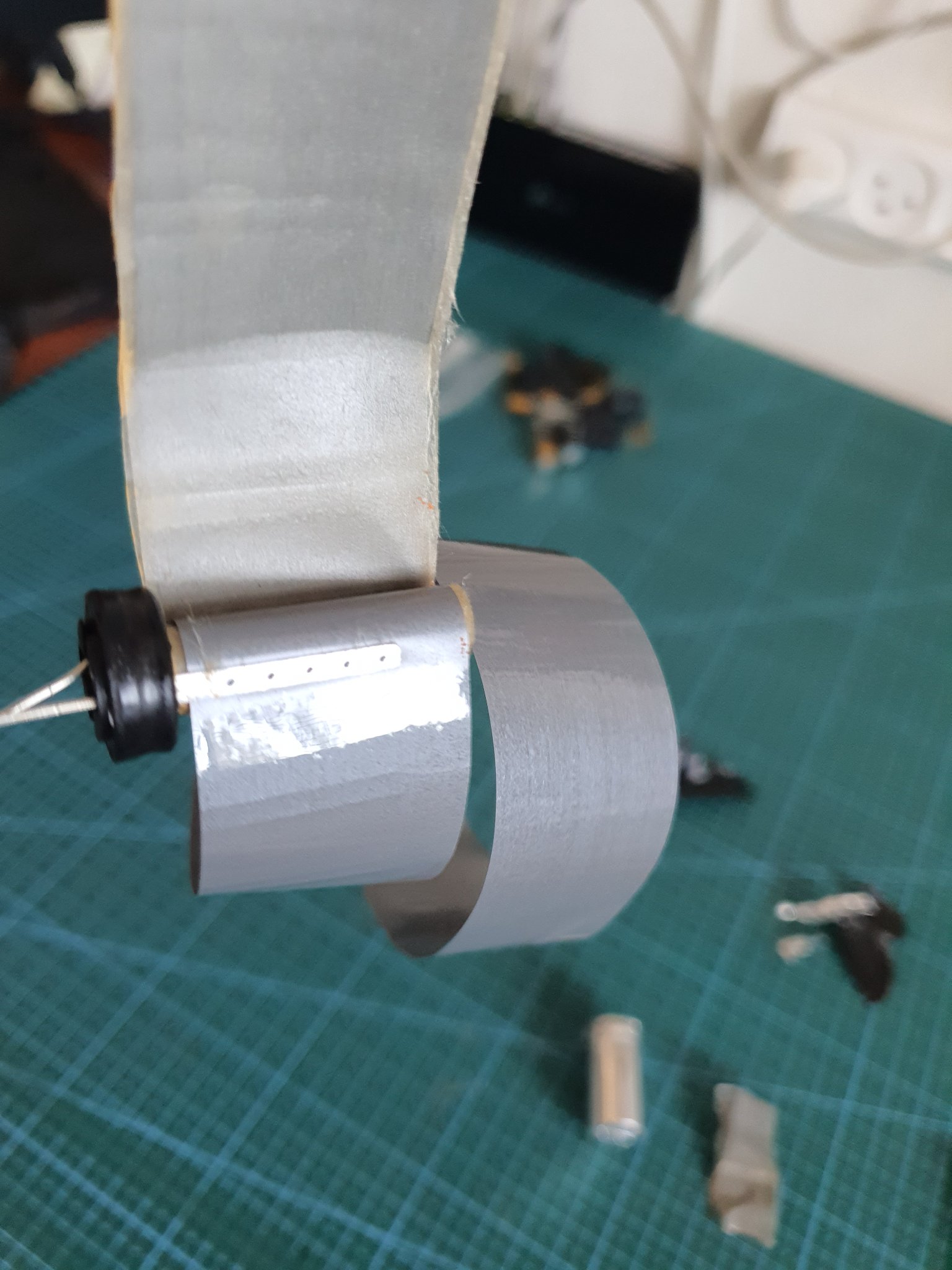

Bought Nichicon MUSE KZ (UKZ) capacitors from ebay (seller: atop_authentic_action) and I can tell you that, that from this seller they are original! I bought some capacitors for my Sansui Alpha AU-907i MOS Limited and I opened the largest one 470uf/50V and I was surprised. The legs are copper made and the interior looks original. You can look and judging by these pictures. I should get also in few days some capacitors from Mouser Electronics and I will open the same cap 470/50V (but instead of UKZ it will be UKW) and I will post again for the deferences.
