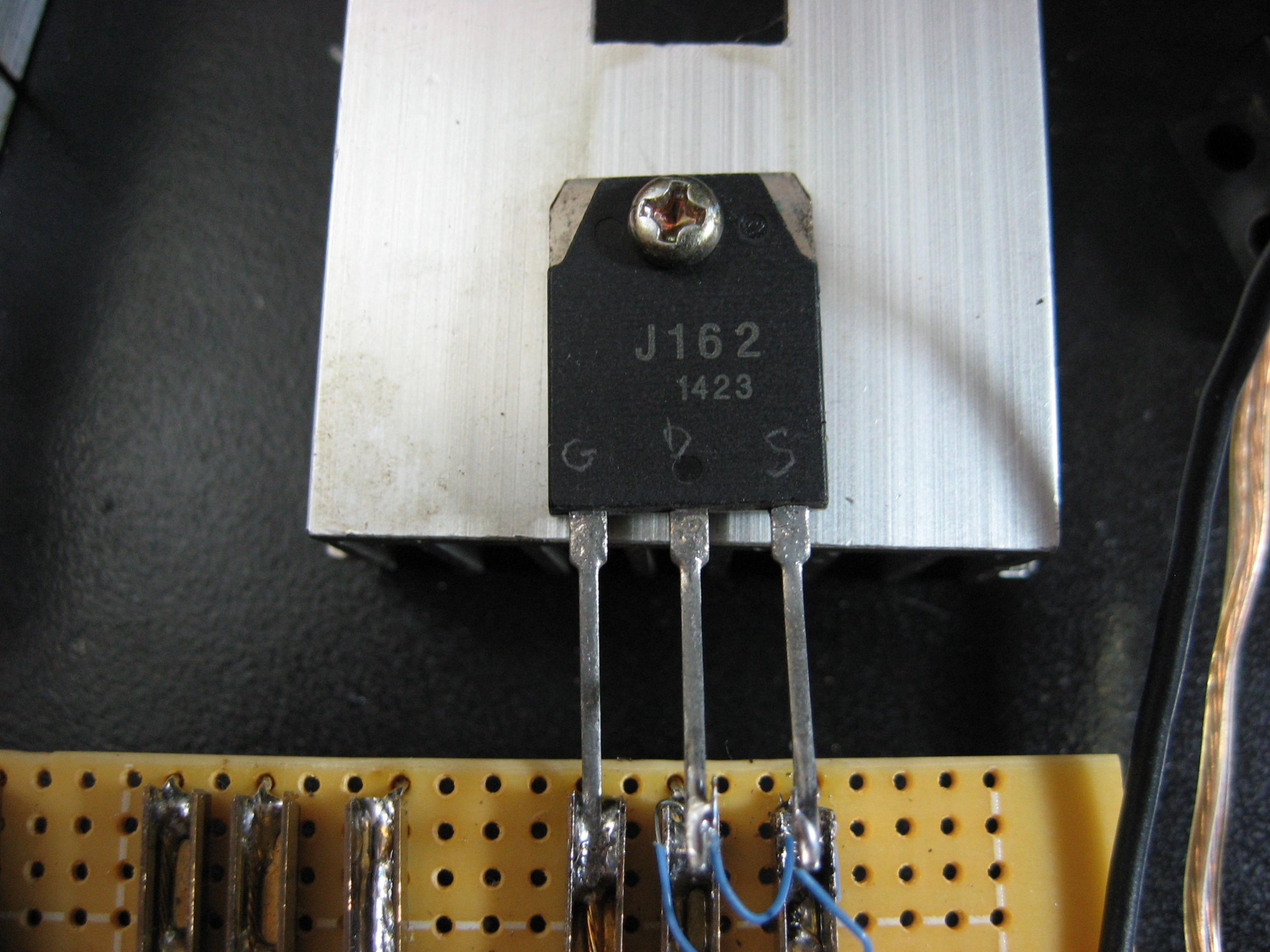

I bought some 2SJ162/2SK1058 pairs, 2 pairs for $10 on Ebay. They look like Renasas but the drain and source pins are reversed. I noticed the D-S diode was reversed and checked them on the component tester, which duplicated the DVM simple FET test.
Ok so I cross the pins with wires and can't get some crossover distortion out. On the positive cycle, there is a bit of delay in following a triangle input then a sudden 350mv snap on from 0v. Coming back down the output triangle, it drops down 350 mv below gnd then does the sudden 350 mv snap on the negative cycle.
I'm thinking the K1058 must be acting like a hexfet. I have not been able to find any reference to that pair with the D-S pins reversed. Probably fakes.

They're in the wrong packages - a huge giveaway that they're fake. The real McCoy come in a TO3-P package, whereas those are TO264 or TO247.

As said, they are wrong pin order because they are indeed fakes. I've seen and heard of this type of fake lateral mosfet on diyAudio and other forums too, over about 10 years now. I've even replaced a few sets in other guys' DIY builds and a repair, so this is not likely a rare or unusual event.

I had also experienced ordering these Said to be laterals but fake on ebay sellers. they are re- marked verticals. good that I only ordered a pair for testing and comparing with my originals..
100% fake (remarked vertical MOSFETs).... drain and source pins are reversed...
All flatpack lateral MOSFETs have Source connected at middle pin.

Afaik, Hitachi /Renesas 2 SK1058 and 2SJ162 are only available in TO-3p case, not in TO-247. Another aspect, that these are fakes. Refund money!!!!

When the devices are marked with Toshiba, may he received some 2SK1530/2SJ201, there the pinout would be correct. But from this dealer, the 2SK1530 received already a negative feedback as fake.

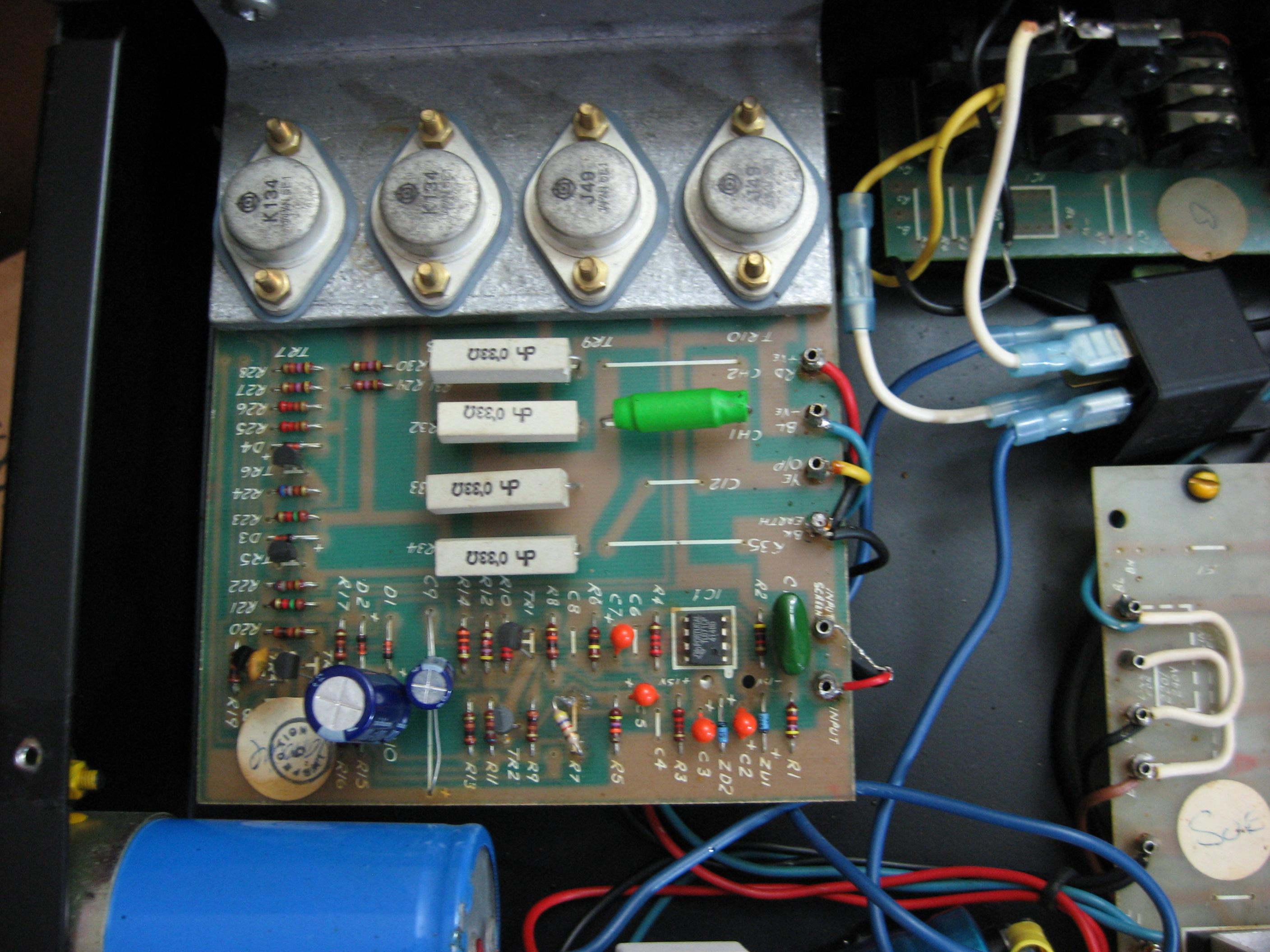

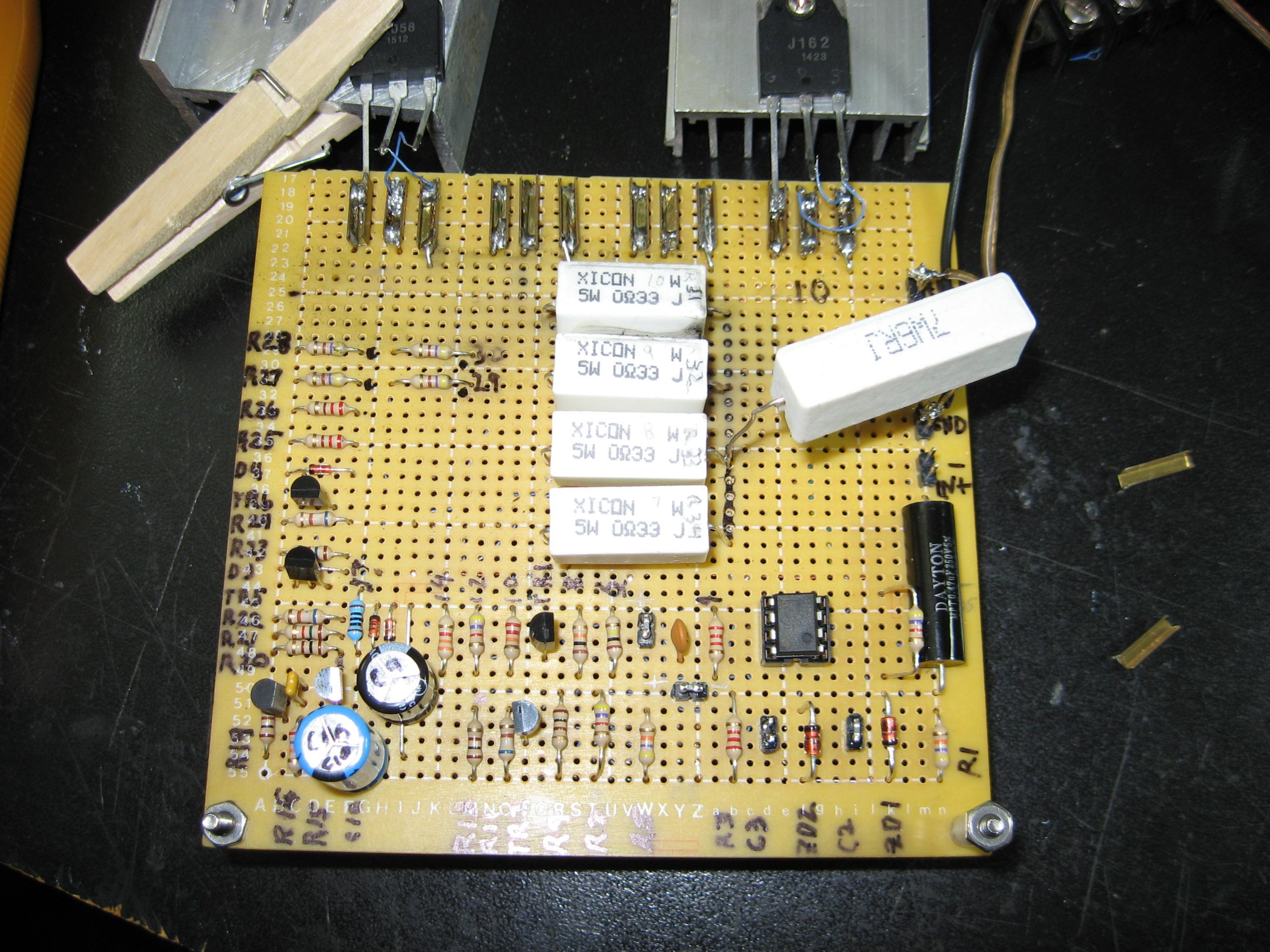

Here are some photos. They go in a backup power board for a Marshall IBS200. It works but I figure since it is 32 years old I would build a backup power amp in case it should fail, I'd have a quick swap and a winter project for study.
It originally uses TO-3 but these plastics can be easily fitted. I like the power transistor connectors I concocted from hobby brass U channel. The two missing transistors are not in the feedback loop and the board is meant to run with or without.
The little black spot ? It was originally tested it at +- 27 volts for smoke testing. I forgot the little auxiliary 220uf caps I tacked on were 35v when I moved on to +- 65v . Five seconds after power on and BANG. Haven't done that for many years. too excited about it. But alas, the problem power transistors became apparent with unusual crossover distortion.
I substituted 2.2uf XR7 chip caps for 2.2uf Orange drops. Pssst, seems to work under four volts.
The clunker resistor is a temporary load resistor.
32 years old and good as new. I want to keep this amp going as long as it can, just to see how far it can go and because I like it.
Some prior owner installed the clunky speaker protection delay circuit. I have plans for an external one to keep the amp historical if I can.

The 0603 caps do not quite fit between the header pins, so I began filing some of the inner pins off to fit the 0603's neatly between them.

A good test, if veritikal or lateral Mosfet, is checking the Gate- Source capacity. If > 1000pF it's vertikal, if < 1000pF it's a lateral Mosfet (not valid for double die versions).
