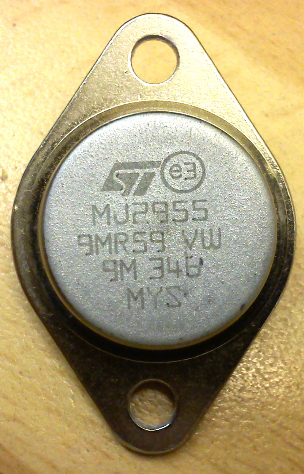

I've just fitted a new pair of output transistors to a NAD amplifier...SGS-Thomson MJ2955 and ISC 2N3055. Also fitted new drivers and bias transistor in heatsink.
Everything seemed fine at first switch-on but when I cranked up the input (1K sine wave from generator) the side I just repaired went up in smoke. It was under no load, just the scope probe.
One of the output tyransistors MJ2955 and all the drivers had blown.
The MJ2955 had failed s/c B-C
I couldn't find anything else wrong so I fitted a different new pair of outputs (mospec) and all new drivers again and tried it..and it works perfectly.
Any chance the MJ2955 was a fake or was I just unlucky?

If the pic is representative of the real thing, it does seem to look correct, according to 2 recent purchases of similar STmicro parts that I made. However, I paid a lot more than some Chinese stores selling what appears to be the same items through Aliexpress, Ebay and similar websites. Some are as cheap as $0.45 US ea, even in small quantities and post free in lots of 10 or more! Buyer beware if your retailer or kit maker is buying these parts to resell to you.
The question of fakes won't be settled by guessing about authentic external details though - it's the seller's purchasing reputation that's in question as much as ridiculously cheap selling prices for alleged new products.
The number isn't recognised on the STMicroelectronics web site but is listed by Farnell with a data sheet dated November 2013!
You could cut the top off the TO3 package and see how big the chip is.
If it was significantly cheaper than Farnell (£1.72) I would expect it to be fake.
Does this amp have output stage emitter resistors? Some of those old NADs don't. Using modern 3055's without them is playing with fire. Adding 10 ohm base stoppers is the recommended fix (base stoppers add a bit of thermal feedback, but keep the crossover characteristics of the original design).
No, there are no emitter resistors as such, only one which is normally shorted by a solder link but is unsoldered and the mV measured across it when setting the bias.
The new mospec transistors are working fine after a while on soak test and bias is bang on the centre. No evidence of oscillation.
It's not an oscillation thing. The base stoppers are used in leiu of emitter resistors, for the same purpose. It's possible that the Mospec units have high intrinsic base and/or emitter resistance. Older 3055 variants did. The modern ON units don't, and if you just put them in there it usually runs away.
