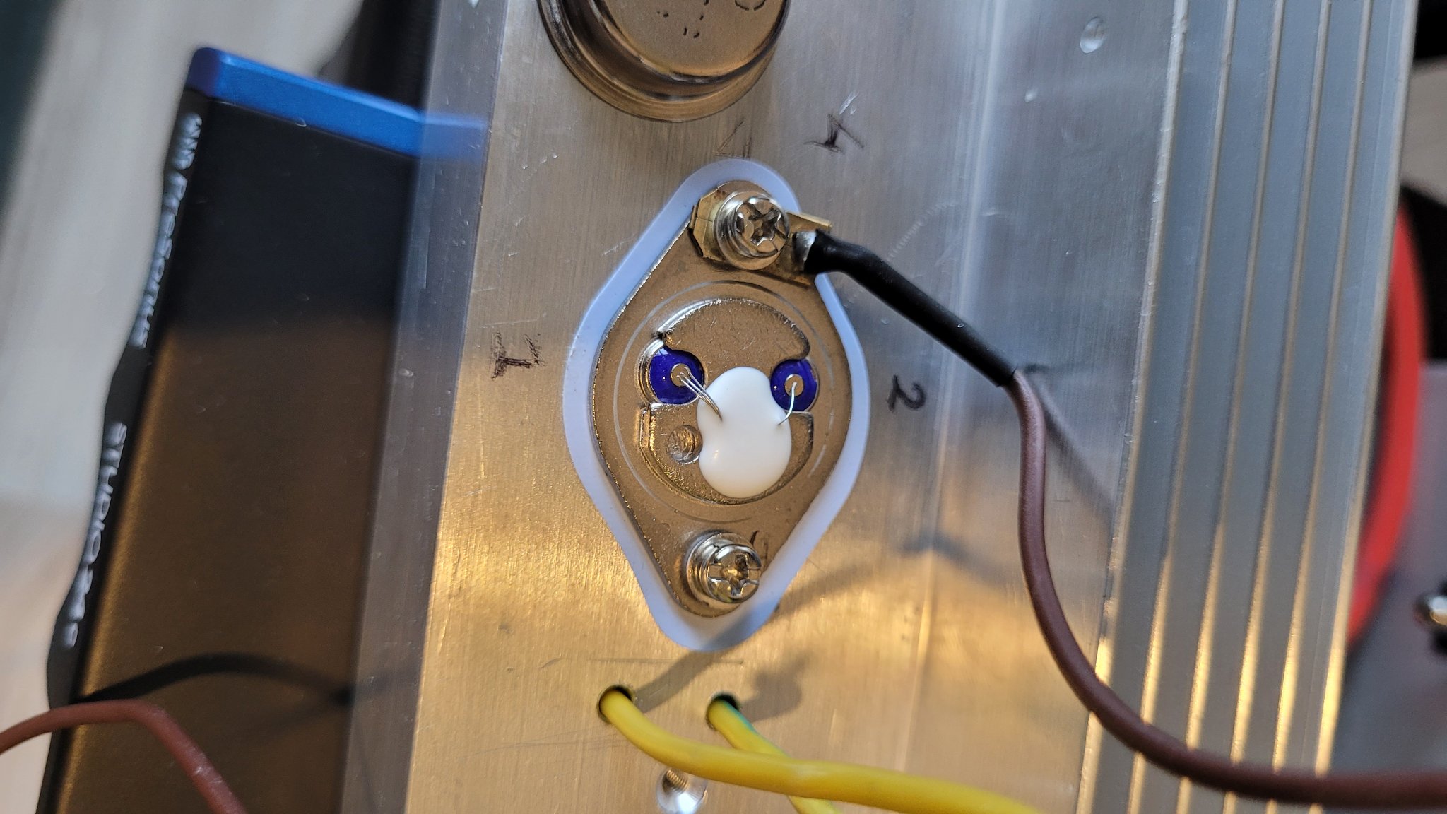

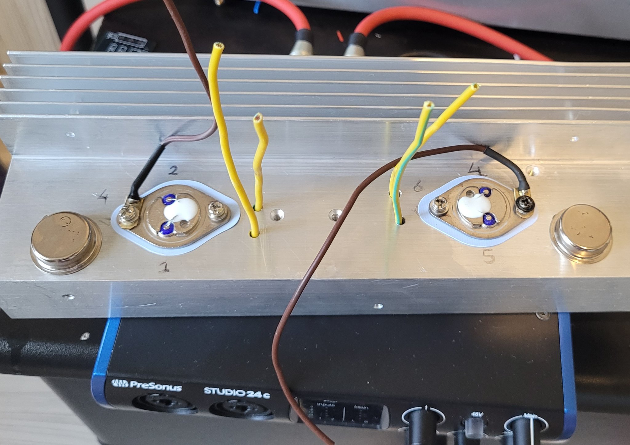

Very fake. The tops don’t come off that easy on real ones. If it said “ON” and the markings rub off that’s another red flag.
I contacted the place I bought it from and returned it. I think it's fake too. They increased the amperage resistance by connecting 3 different small transistors to each other.
I can’t see what’s under the goop. I’ve seen two dies before, haven’t seen three. That would be a first. There are a handful of types out there that are supposed to have two dies, but MJ15003, MJ15024, and 2SC3281 aren’t among them and I’ve seen two die fakes of all three. MJ15024 has two bond wires on the emitter, but it’s one big die.
Some real makers (Non-ON) use the white or clear goop, but the tops still take an act of Congress to remove.
The blob of white goo on the die is also a dead giveaway... I have some good parts I scored from one of Papa's early giveaways at Burning Amp.
I always wonder which ink they use on the originals? Very hard to remove.
The goop is a dead giveaway if it said “ON” on the package. Many older Jap parts and some new Taiwan sources have the goop in their TO-3’s. But the top hats are just as hard - if not harder - to get off in one piece as real Motorola/ON. Ever tried getting one off an old Sanken? Takes a pound of C4 or a miracle from God. And real epoxy packaged parts, regardless of who made them, never used the goop.

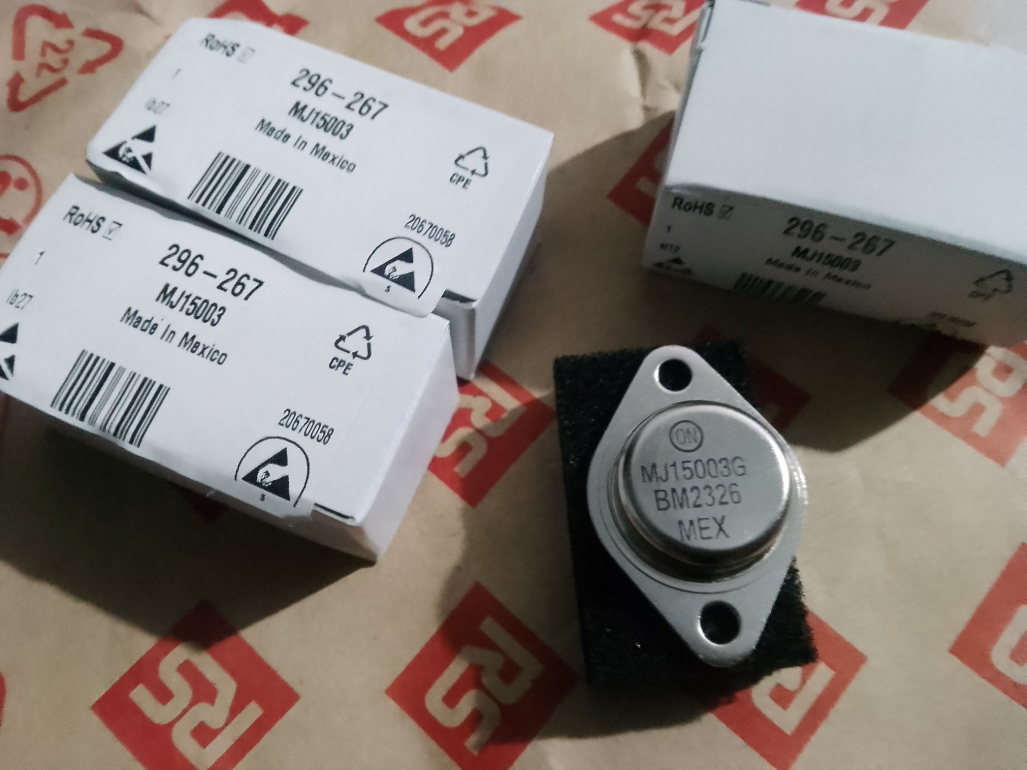

I paid about $12 each for the MJ transistors. I had bought a fake for the real price. Because I bought it for real. You can never buy real components cheaply!
