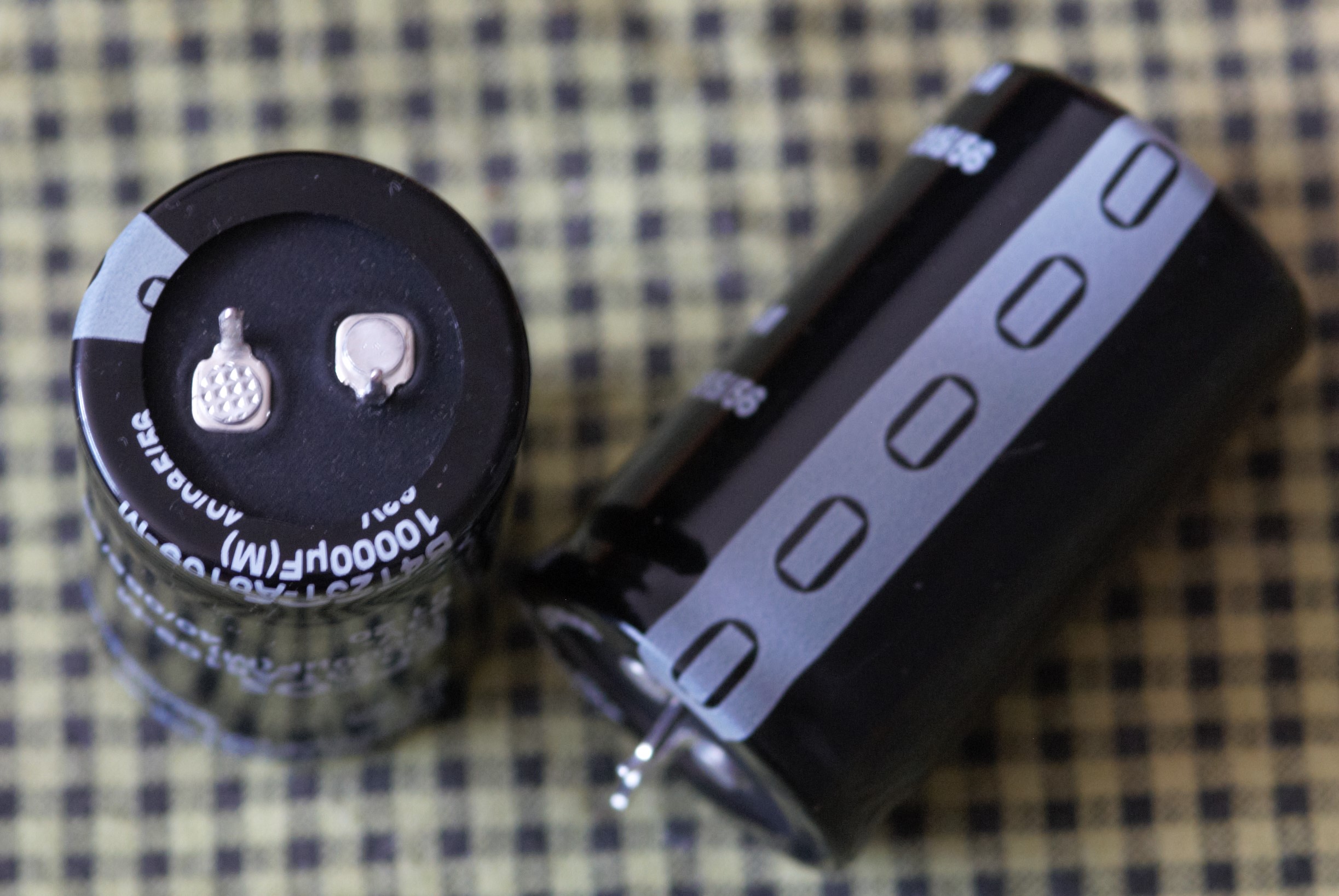

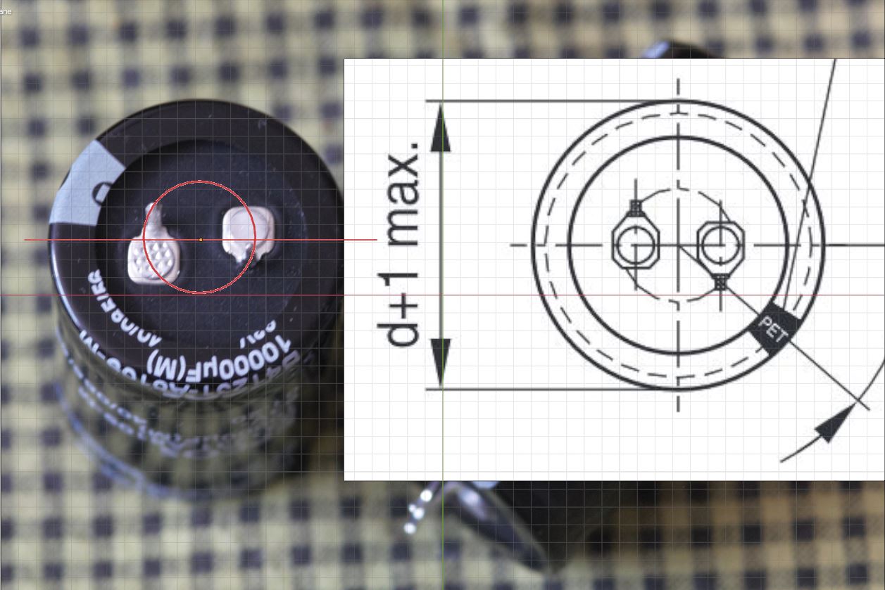

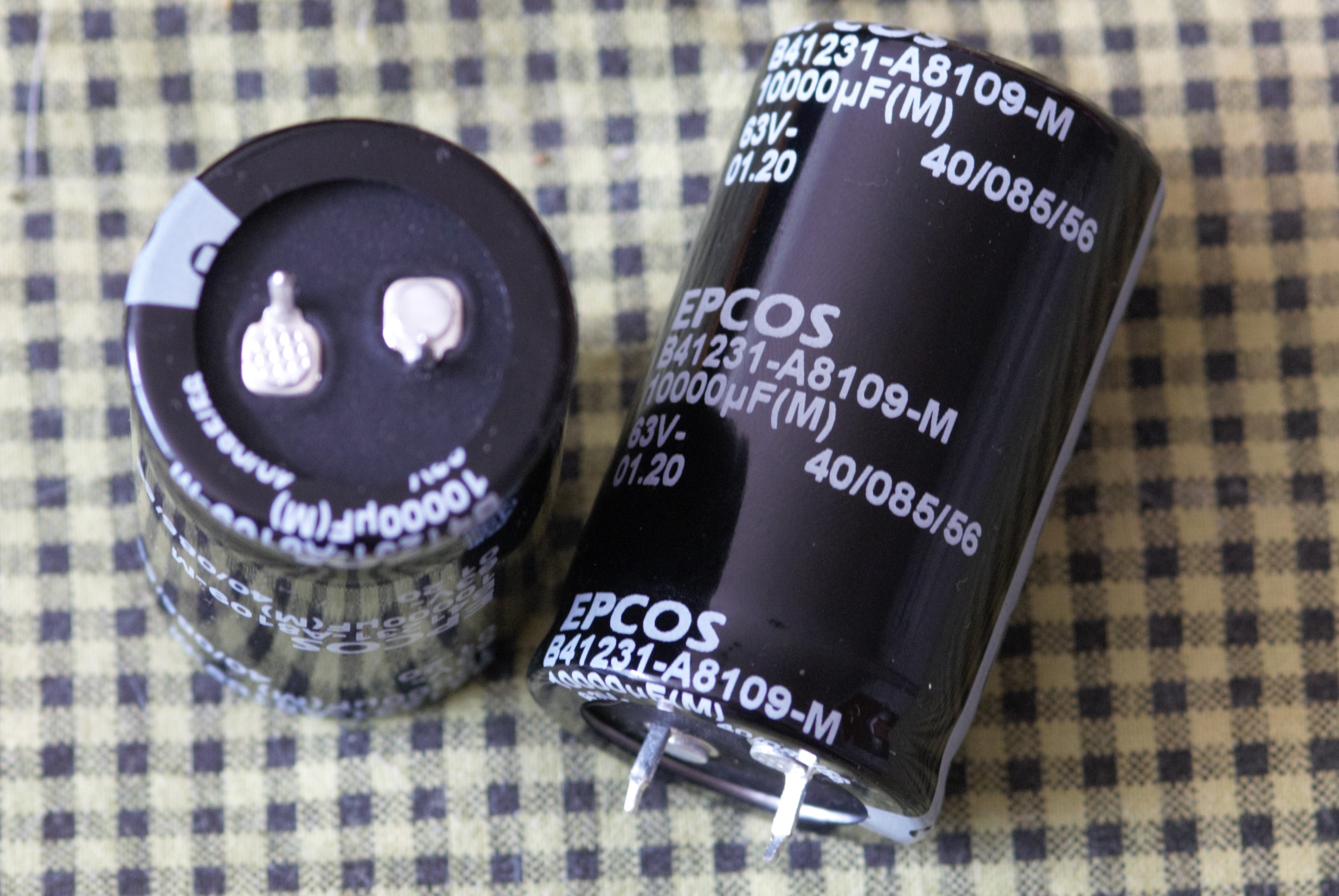

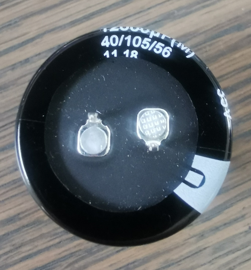

So recently i purchased some EPCOS capacitors online from a local store which is not an authorized distributor for TDK, but seems to have lots of different known brand items in the store and is well reviewed. When the capacitors arrived, i noticed they deviated a bit from the datasheet. they don't have the "PET" marking on the sleeve as described in the datasheet, and the pins are attached to the capacitors in a different position. I'm attaching pictures of the capacitors in case any of you are familiar with the brand and have purchased confirmed originals and know if they look like these or not. At the moment i don't have a way to measure them, and when i contacted TDK, they basically told me to look at the datasheet, which i had mentioned to them i already had.
Thank you!

Also I'm not sure that it isn't genuine.
Are the terminal pins the correct distance apart (10mm from memory) - I don't recall ever having seen the letters PET on an EPCOS cap either (I buy from a reputable source, RS Components) so that may be a red herring.
I'll see if I have any pics or any in stock.

EDT: quite certain "PET" means the white strip showing negative terminal.
Which is clearly seen both in your picture AND in the datasheet image , and in the exact same angular position, on the same diametral line joining both terminal tips.
Quote from TDK Techinfo section 3.8.1:
" PVC insulation and PET insulation cap on terminal side
For capacitors with snap-in terminals we offer offers an insulation version with an additional PET insulation cap on the terminal side, which is placed underneath the shrinking sleeve to increase the creepage distance. This is a special design for applications with uninsulated live parts under-neath the capacitor, where higher grade of insulation is required. Dimensional details are given in the detailed specification of the corresponding capacitor series. While this design offers improved characteristics with respect to creepage distances, but it is not to be considered as functional in-sulation."
link - https://www.google.com/url?sa=t&rct=j&q=&esrc=s&source=web&cd=&ved=2ahUKEwiVqqOg09TsAhUKVBUIHWUoDrsQFjALegQIAhAC&url=https%3A%2F%2Fwww.tdk-electronics.tdk.com%2Fdownload%2F185386%2F5f33d2619fa73419e2a4af562122e90c%2Fpdf-generaltechnicalinformation.pdf&usg=AOvVaw1simyl0ct4FoLOvmmuEoG9

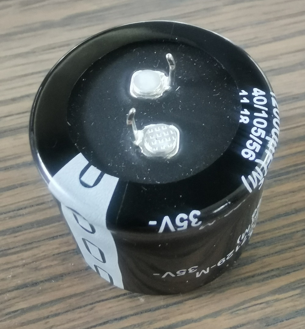

This one is from Mouser. Its different version, but your looks good to me.
thank you! those pins looks like mine, and also missing the "PET" marking. i guess they just deviated from the datasheet with those details.
And regarding the other replies here, the datasheet clearly mentions the letters "PET" being printed on the sleeve, which was where my wondering came from.
