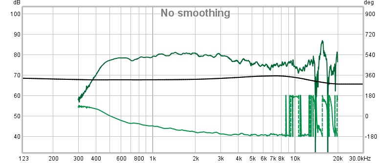

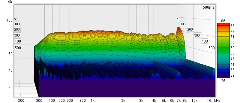

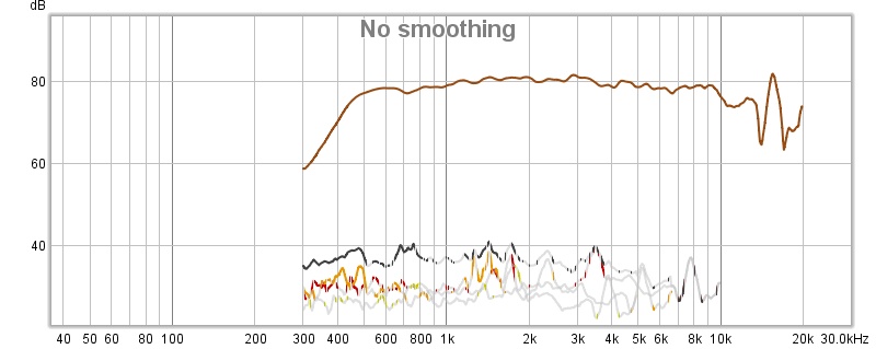

I finally drug some gear outside for REW measurements. I'm sharing the Faital Pro LTH142\HF140 set. Looks really good to me.
Note: the 7K resonance is most likely crickets. I couldn't get those damn things to quite for a minute.
