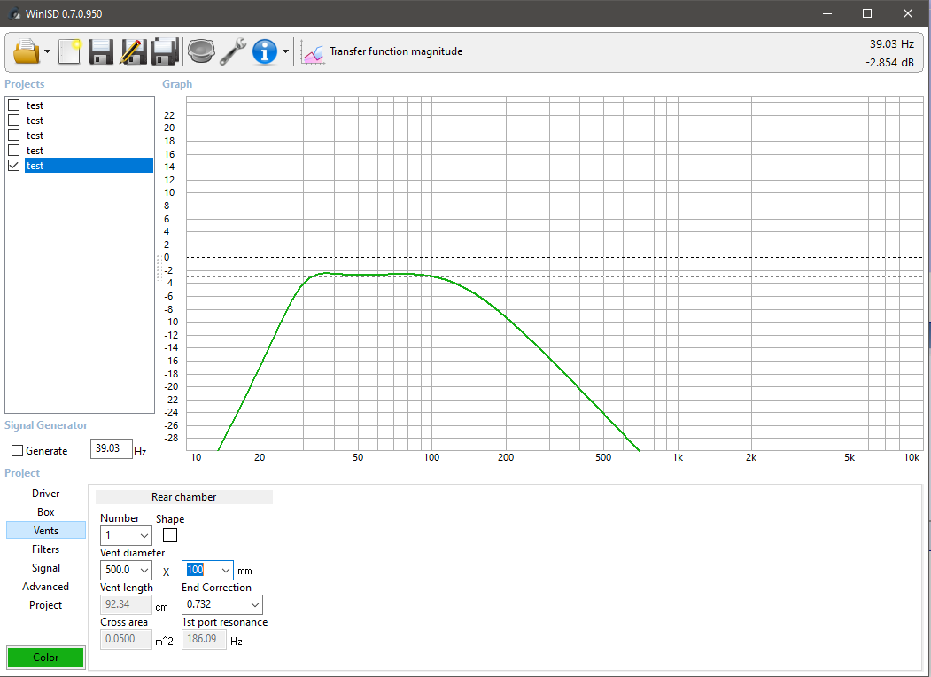

Hi, I am going to build a ported sub with a 18xl2000. I have made one design in WINSD and Simens Solid Edge
Box volume: 260L
Tune freq: 27Hz
What box volume and tune freq whould you use in a ported design with a 18xl2000?

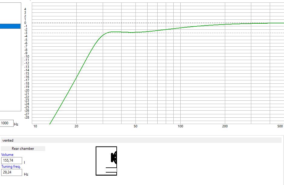

I would not tune it that low, more like to 30Hz with 150L cabinet and a big slot port (like 50cmx10cm and 93cm long). crossover at 125Hz (or lower) for this result. You loose 2dB sensivity but got a more or less flat response in this alignment to 30Hz.

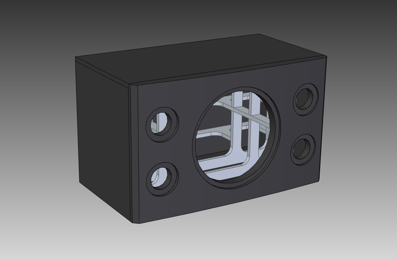

I will use the sub for HT and music, but I will prioritize music.
My room is 8mx5m, so the lowest mode will be 21,5.
But I will probably move in a year.
I will change the design and use 2 big ports in the front close to the floor, and the ports will be 3D printed (so I can test different shapes).

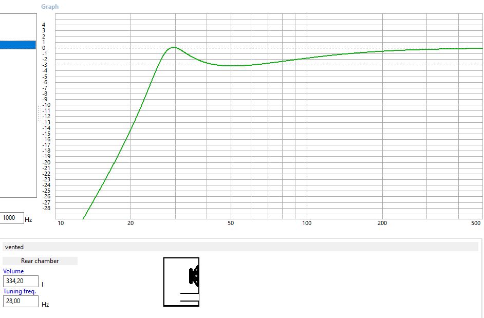

Maybe use Vb=vas/1.44, Fb=Fs and try different shapes of the ports and see if the dip at 50hz can be reduced?
