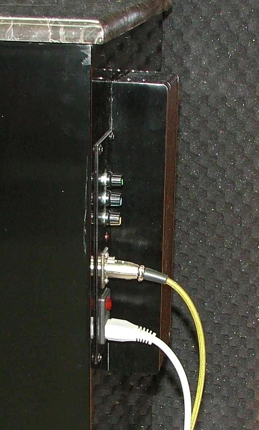

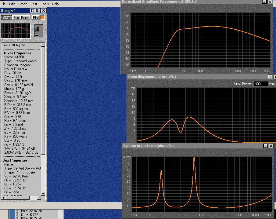

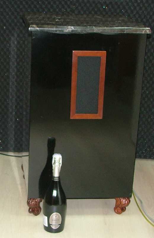

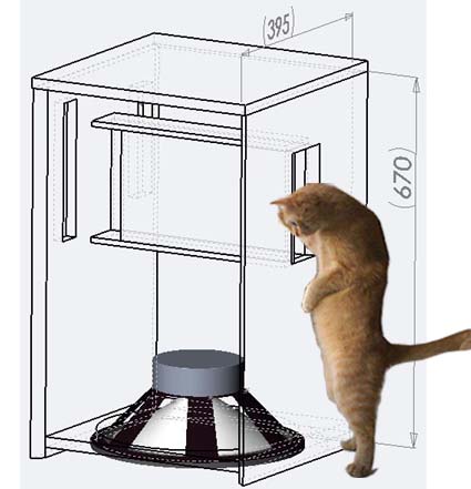

Fairly good and bright 15" sub.
hola gentlemen!

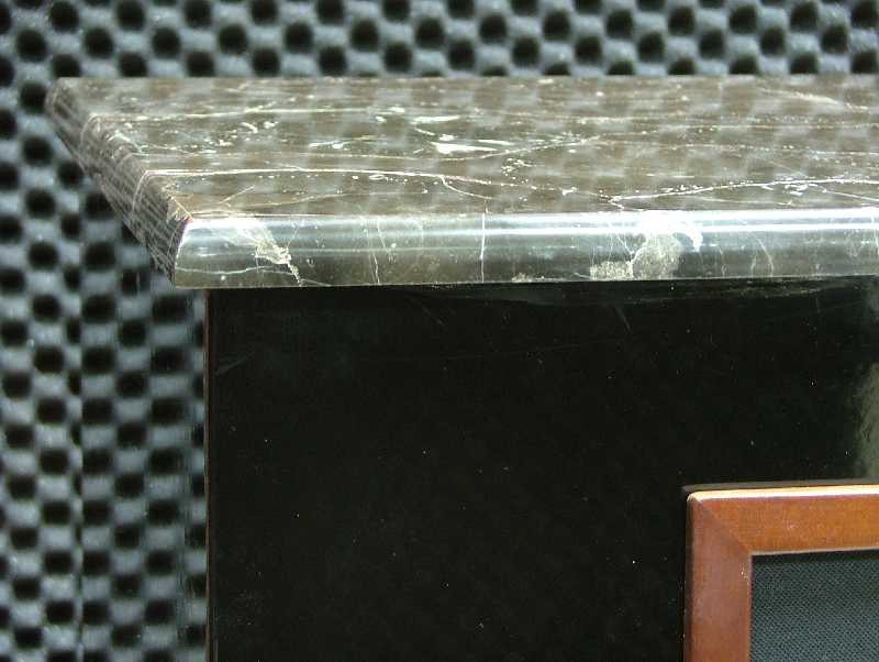

One more marble sub appeared. not total marble, but top part is enough for make it substantial and it shouldn't jumping through the room.
I choose Pro-audio 15" woofer, made in according of my request, couse I don't like long-stroke things.
it will be able to take 1kW RMS, but for home use 200W is enough. :smash:
Cats, women and neighbors approved that audio equipment. now I even able to tell bass gitar from contrabass and will consider about OB loudspeaker, couse 3 way isn't necessary for that sub. 🙂
