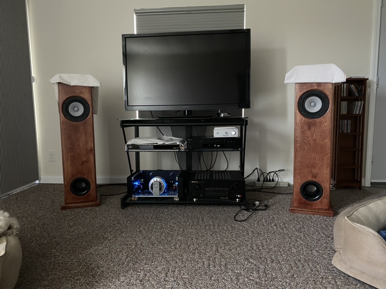

Anyway, I just completed an F6 amplifier and have 15 hours on it now. I have the bias set at 560 mv on both channels. The bias is stable and I’ve only adjusted it from 510 to 560 and only after amplifier is fully warmed up. I’ve been monitoring heatsink temperatures with an IR thermometer and see 51c at pin 2 on mosfet. The temperature varies on each mosfet though I’m not sure how much that matters. I’m monitoring highest temperature before bias adjustment. All that said I haven’t noticed much change in sound quality yet. I suppose patience is in order? I’ve been using my Onkyo CDP C7030 as a source and for the first time last night I switched the source to my Mac mini through my HRT music streamer. It’s an asynchronous usb dac that I’ve had for several years but sadly is my only option for conversion duties when using the mini. The difference in SQ was quite noticeable. So apparently the dac in my cdp is somewhat better than my HRT. My speakers are diy full range using MarkAudio 12p. I’m hoping for suggestions, should I increase bias to 600 mv or just let it run in longer? I do have a diy dac planned but given how long it took to get my f6 going it’s going to be awhile before that’s ready. Suggestions, please

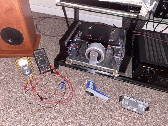

So far, heat hasn’t been an issue. I’ve measured in several different locations and have yet to see more than 52C. Specifically at pin 2 on all 4 mosfets. I can put my hand on the heatsinks and just keep it there. Yes it’s warm but not hot. I thought putting the top cover on would increase temperatures but that hasn’t been the case. I’ve measured in various locations trying to locate the hottest areas but again nothing beyond 52C. Last night I increased the bias on both channels to 600 mv and set offset at .010 vdc. This was after playing for 2 hours. I shut it off after an additional 2 hours. All this without faceplate or top and bottom covers in place.

The bias current has some dependency on temp so you need to do the final adjustment with the case complete with the lid on.
You can clip test leads on the 0.47 ohm source resistor leading to your multimeter on the outside the amp and then just put the lid on top.
Then run it for a couple hours while monitoring the dc offset and bias current. Make adjustments if needed and then put
the lid back on and wait for temp/bias to stabilize. Repeat as required. 🙂

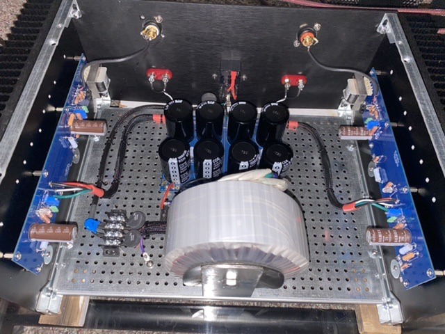

The bias is stable on both channels at 625 mv as is offset @ .02 mv. I’ve not changed either for at least 20 hours of run time while the amp total hours is closer to 60. These measurements were all done with faceplate on and top secured. I’ve left the bottom plate off and likely will never install it. Mosfet temps at pin 2 are becoming more stable as well. I’m seeing a fairly consistent 52c in three locations and closer to 60c in one other. I have begun to notice the amp settling in. I’m not sure how to qualify that except it does seem a bit smoother at all frequencies and some harshness is gone especially so on higher frequencies. So there you have it, at this point I will secure the top and just continue listening
