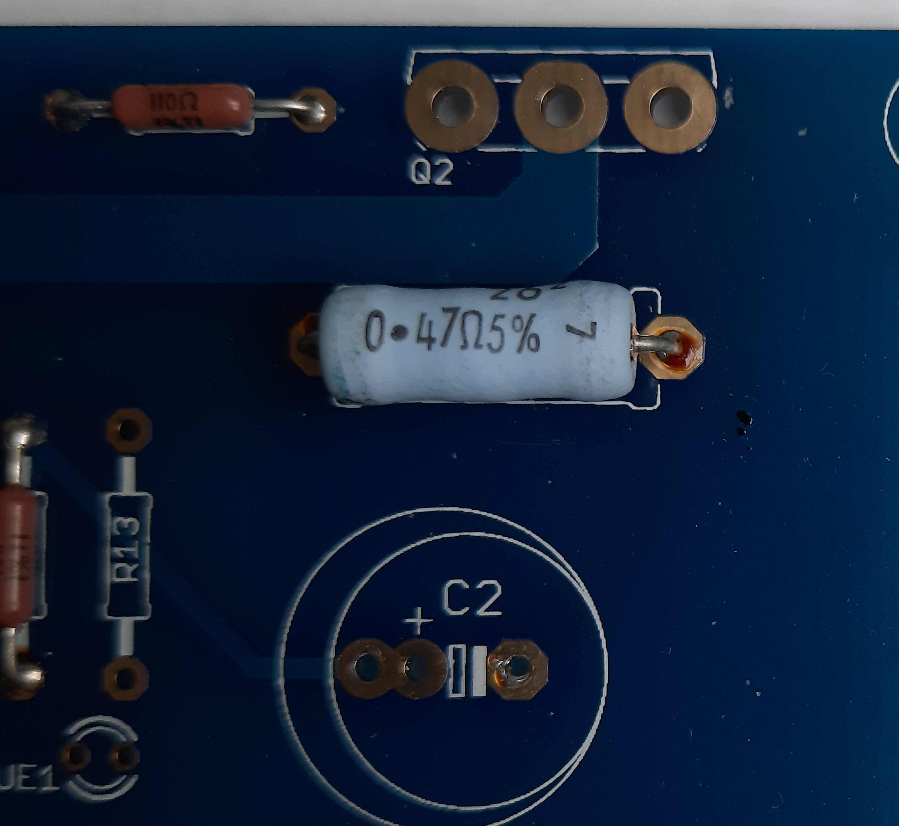

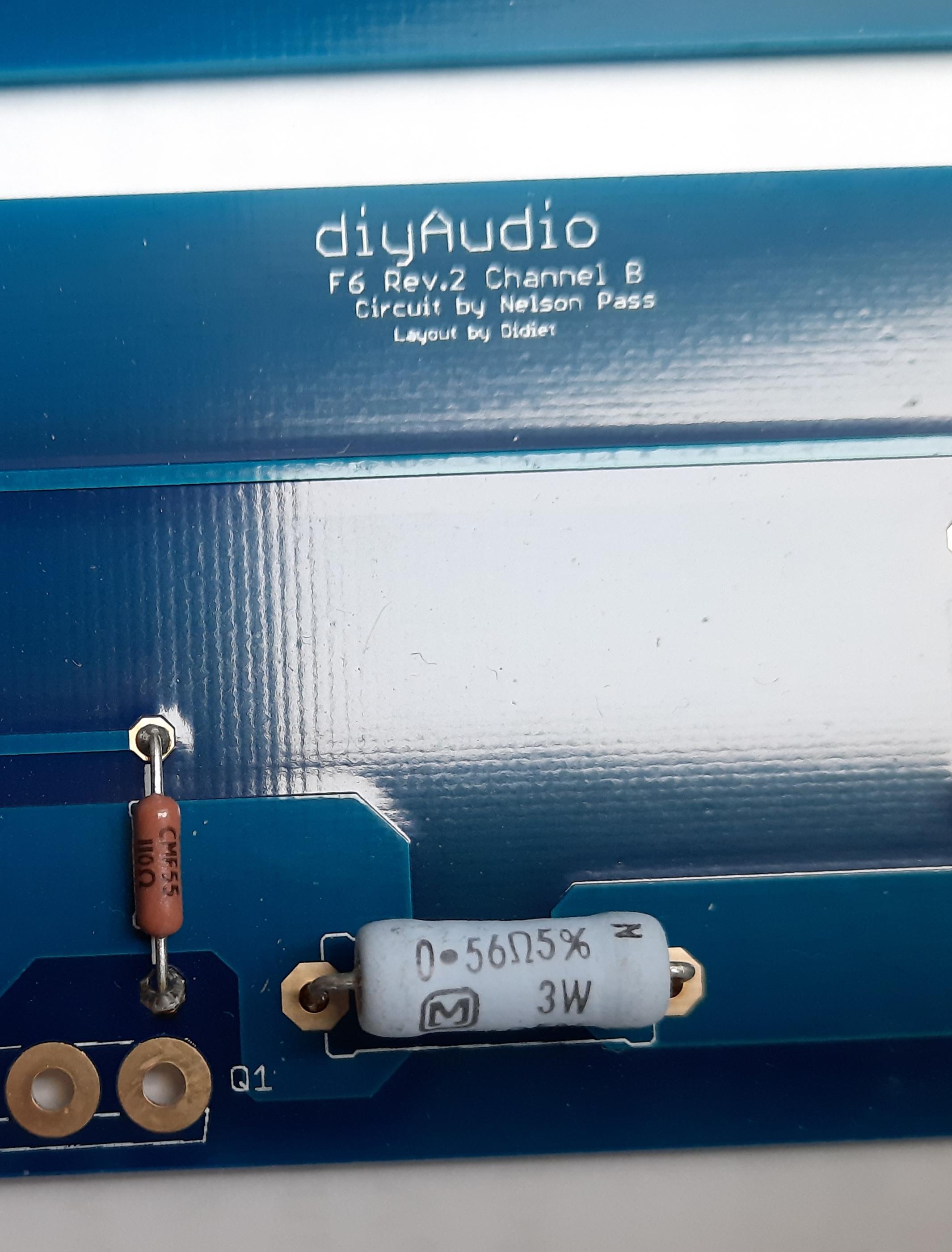

I purchased the complete F6 PCB boards, parts, and transformers etc.. from the DIYAudio Store. I have started stuffing the boards and immediately ran into some things I don't understand and I could use some help.
1) As far as I can tell the board for Channel A has a place for the 0.47 ohm R1 resistor but no place for the 0.56 ohm R2 resistor. And the Channel B has a place for the R2 resistor but no place for the R1 resistor. That makes no sense to me and isn't consistent with the schematic. A picture of the boards is attached.
Both boards contain an unlabeled position that is the right size for the resistor. Can anybody help me understand what is going on? Are my boards defective?

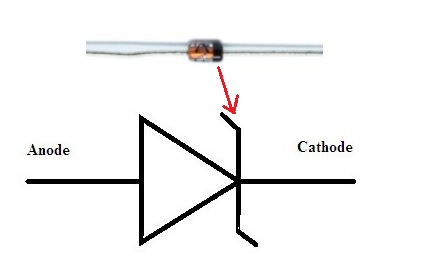

3) How do I orient the Zeners on the board? Obviously they are directional but I don't know enough about them or the schematic symbol to know how they should go. There is a dark band on one end of the Zener. does that go at the base of the triangle or the tip of the triangle on the board?

I may have inadvertently broken the link to the picture of the boards. Hopefully this works.
Hi Paul,
no, we don't see your pictures.
I try to answer some of your questions:
1)
Your pcbs should look like these in the build guide:
F6 Illustrated Build Guide
So they are not more faulty than those.
2) Use the 6.2V Zeners. See linked post above, explained there.
If you have, use 3.3k Resistors, not 10k.
3) Yes. Look at the pictures of the build guides. Maybe you can identify the orientation on some pictures.

OK, so you are saying that I should just assume that the unlabeled spots for the resistors are the place where the R1 or R2 go depending on the Channel? Is there a reason why those are the only unlabeled spots on the board?

Thanks. Have you ever run into an explanation of why those places on the PCB aren't marked? I did search through the build guide without finding anything helpful but it is so large I might have missed it.

For Zener diode direction, the side has a black line is cathode side. Check the datasheet for your Zener

The lack of the resistor markings on the PCBs is a completely planned, intentional and cunning intelligence test, placed there by the global Illuminati many years ago much to the surprise of everyone. You will be contacted soon by the brotherhood since you seem to have devised the answer.
...Or it just never got marked and forgotten about.
The extra zener diodes are included so you can increase the bias voltage if required. Start with the lower value one and change if you can’t get enough bias. As previously mentioned, the black line goes over the funny ‘Z’ line on the diagram.
I did look at those pictures of the diodes but the resolution is low enough that it is difficult to make out which end of the diode has the band but after looking at a bunch of pictures it appears the banded end goes at the point of the triangle not the base right?
Simply human mistake forgot the silk print when drawing the PCB 😛
Or it's an interesting challenge for DIYers - forcing you to read the circuit or ask in the forum and having DIY fun.
