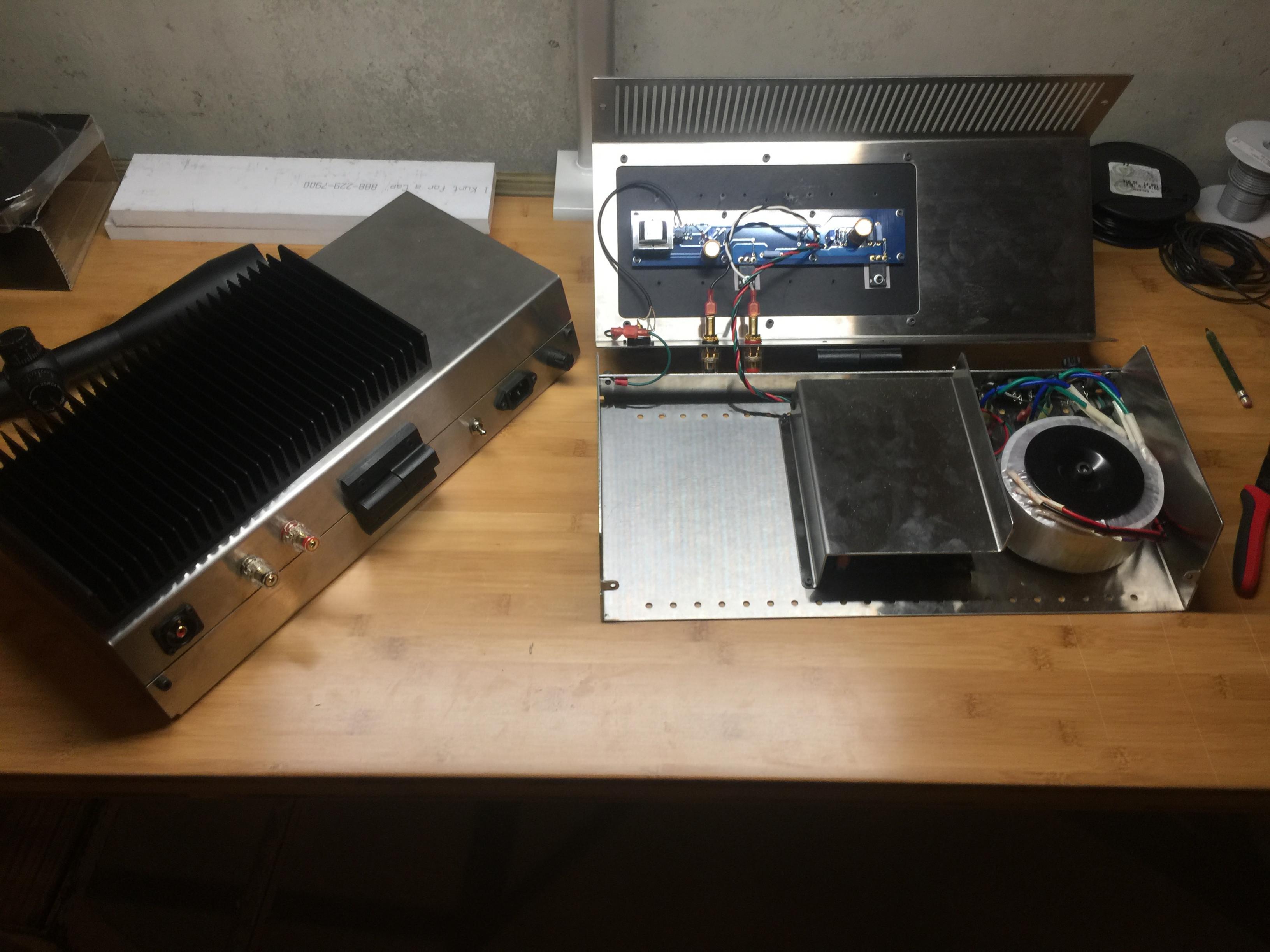

I’ve had my FW F6’s mono blocks up and running for six months or so, and they are great! Still amazed how quiet and detailed they are. The problem is, whenever I switch over to play heavier metal/rock, all sharpness is lost. Guitars lose their edge and everything gets soft/mushy. I’d really like to tighten this up. Before my questions, the following is my set-up:

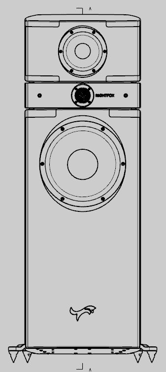

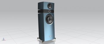

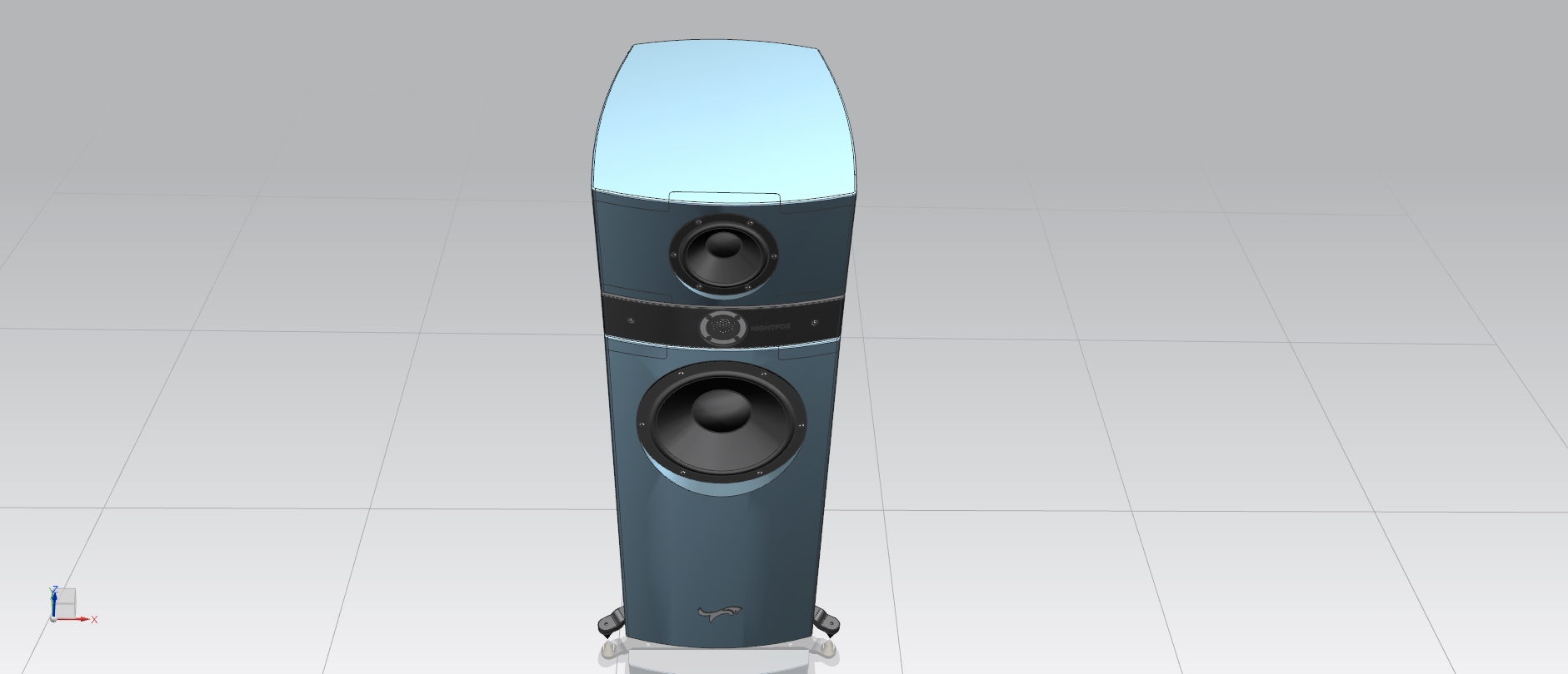

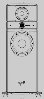

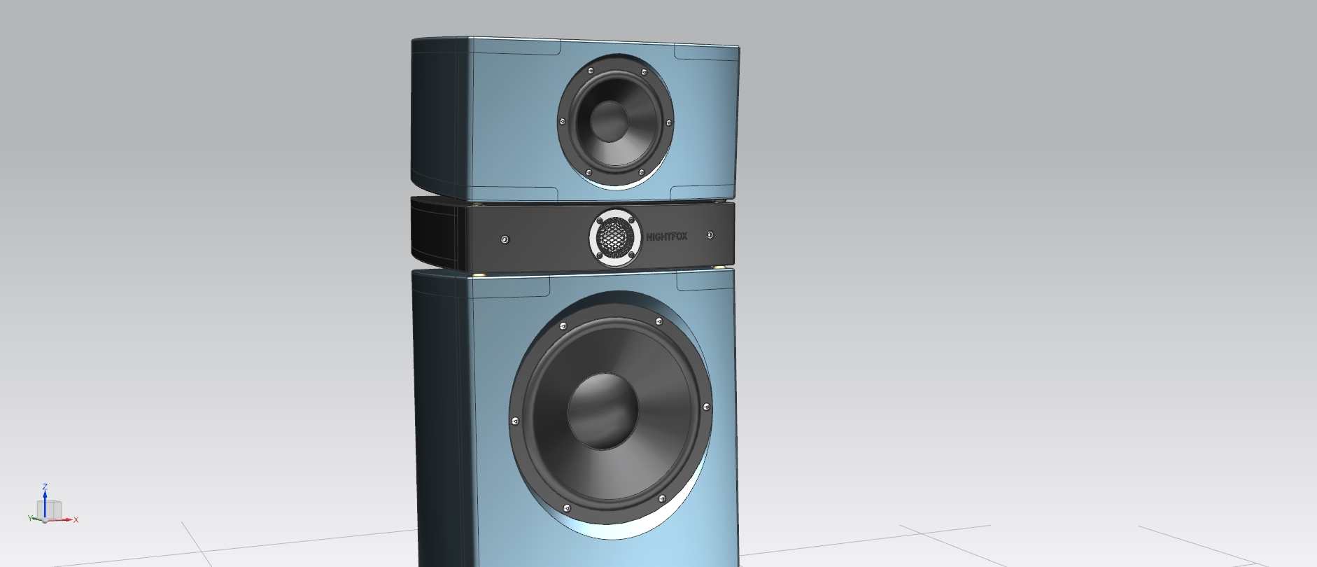

3) I’m mid process of building a Troel’s Prelude speaker (cabinet to copy the look of Focal Scala), and I’m afraid that the situation is only going to get worse with more demand from the speaker. (albeit with slightly better efficiency). Should I save the effort of trial and erroring and simply purchase or build a larger power amp?
Pictures attached for reference and any advice is greatly appreciated.

Definitely enough volume, so my thoughts were in the right direction with bridging. However, increasing the bias may be an easier window to see what is possible. It crossed my mind to do so, but didn't think I could really gain much from pushing the heat limits. Last thing I want to do is risk burning things up.
Heat sinks (300 x 165) run perpendicular to the floor like the 4U chassis and are mildly warm after an hour of solid use. So good there. Perhaps I'll try pushing the boundaries of bias a little bit and see if the condition improves. If they do, maybe I'll redesign the case for more heat sink and bridged layout.

Thank you for your kind words Matthias. The more I age, the more I want to create products that'll outlast me and hopefully look good for years to come. I will definitely report back when it's all together.
For now, I've thrown the full designs up on GrabCad for anyone to use. Mr. Pass shares his designs, so why shouldn't we all! There are a couple revisions on the way, but nothing affecting the layout.
