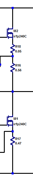

Just thought i'd throw this out there. I had re biased my F6 from 1.3A to 1.5A to see if there was a difference in sound. My speakers are around 87 db sensitivity, 2 ways. I found the sound much darker and compressed sounding,sort of like a veil over it all. I changed back to 1.3A and the sound seemed to open up again. The sound stage wider and a quicker more airy sound overall.The F6 has the IRFP240's and the output degeneration mod. Could this be some sort of sweet spot or am I going nuts?
I've got a couple of sims at the different biases.I think i'll poke around and see if there is something there. I do know that the distortion drops a bit with the higher bias according to Spice,both 2 and 3 go down by a few db.

My immediate idea is that with an increase in current you also get an increase in gain and an increase in negative feedback. I seldom like the sound of negative feedback.
It tends to suck the life and soul out of music-reproduction.

Try it like this on one channel and let me know how it sounds. You'll need to rewire it slightly. M1 has no degeneration, and M2 has a small amount of degeneration.
