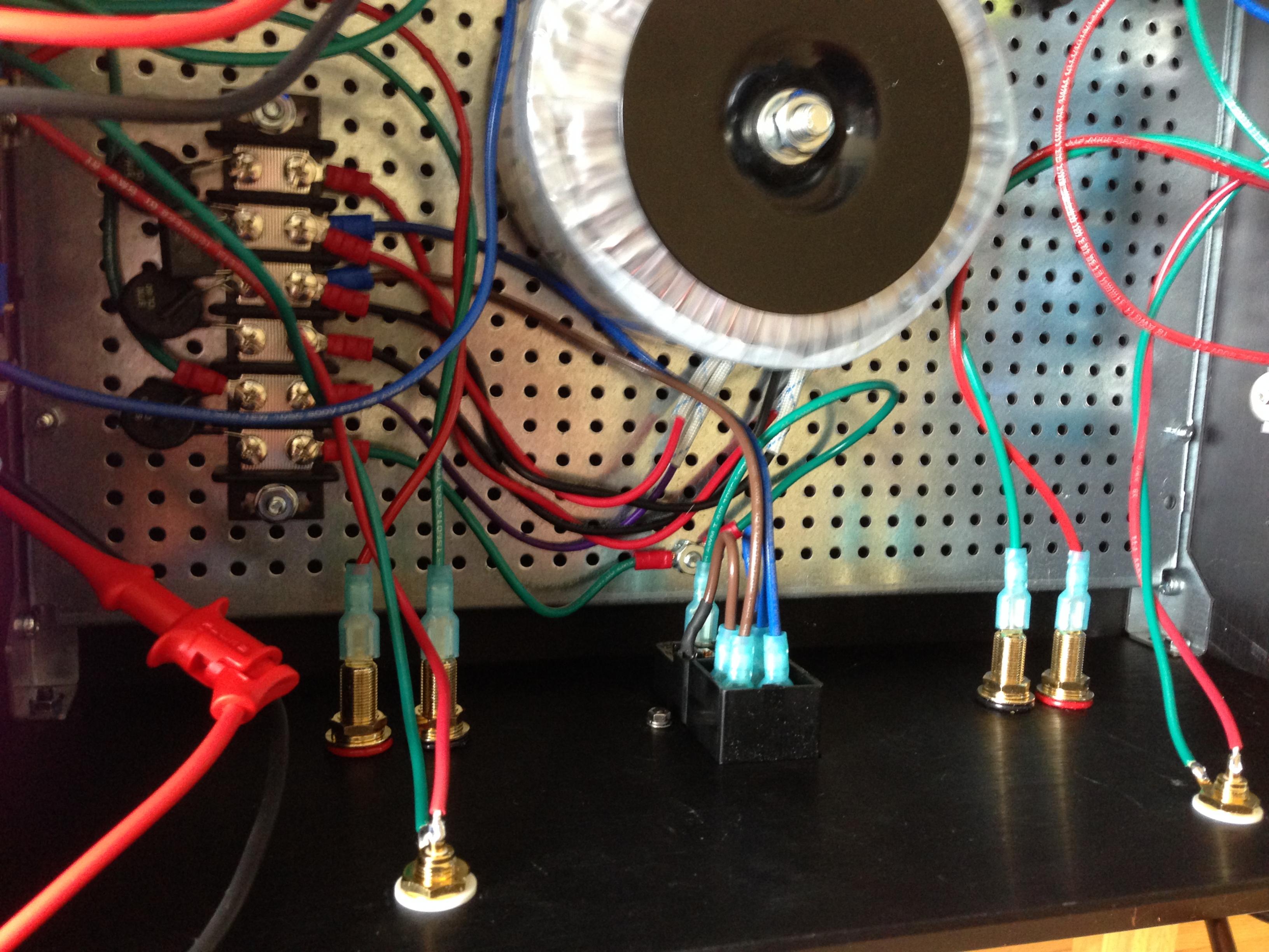

I'm not sure if the polarity of the LEDs changed from v2.0 to v3.0 but I installed my blue LEDs long lead as positive into round pad and it didn't work for me. Flipped it to match the diode symbol and it worked.

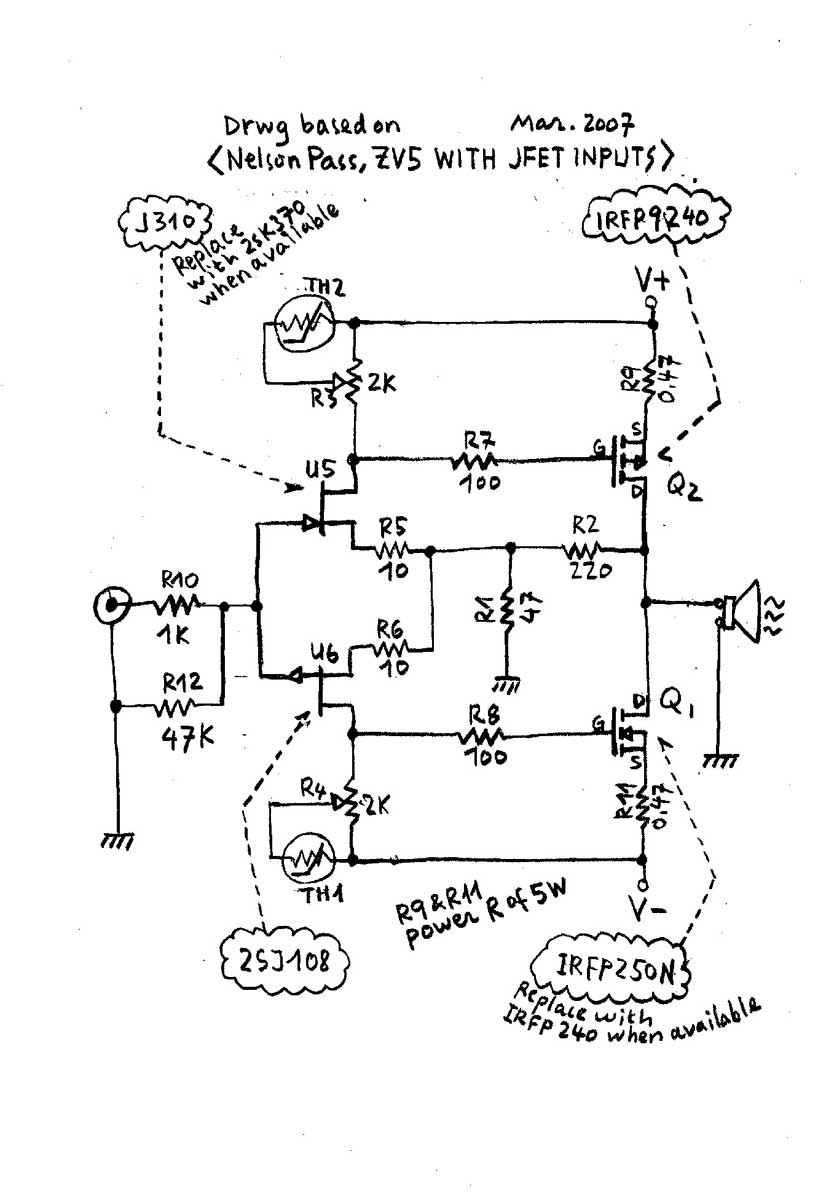

use what you have , in 20-25% ballpark
our dear Baobabwana made his first F5 lookalike with J309 and 2SJ108 years ago ...... you'll get much better match ....... due to balancing nature of circuit

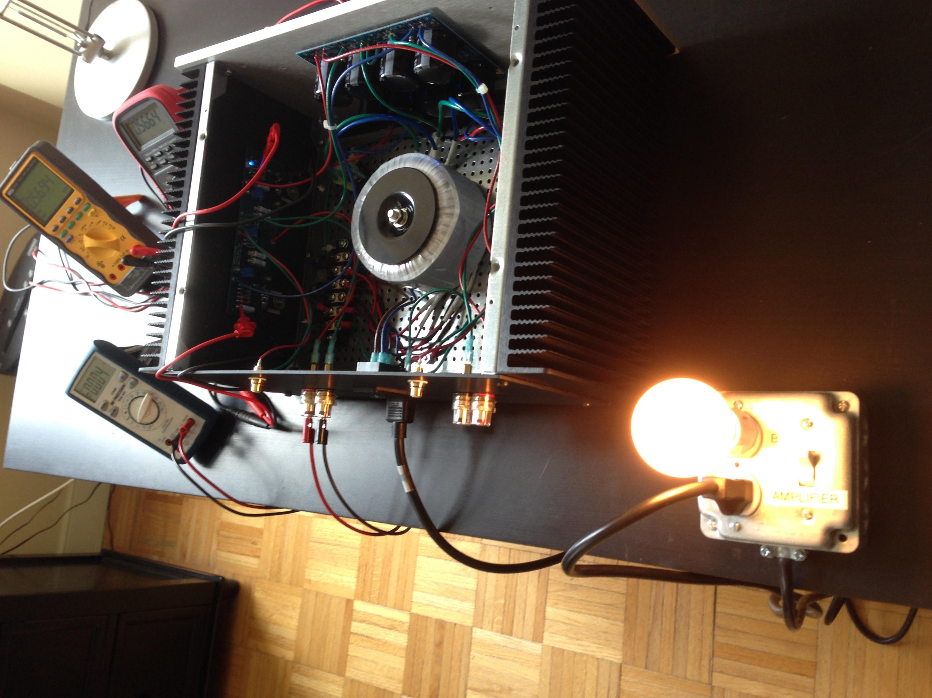

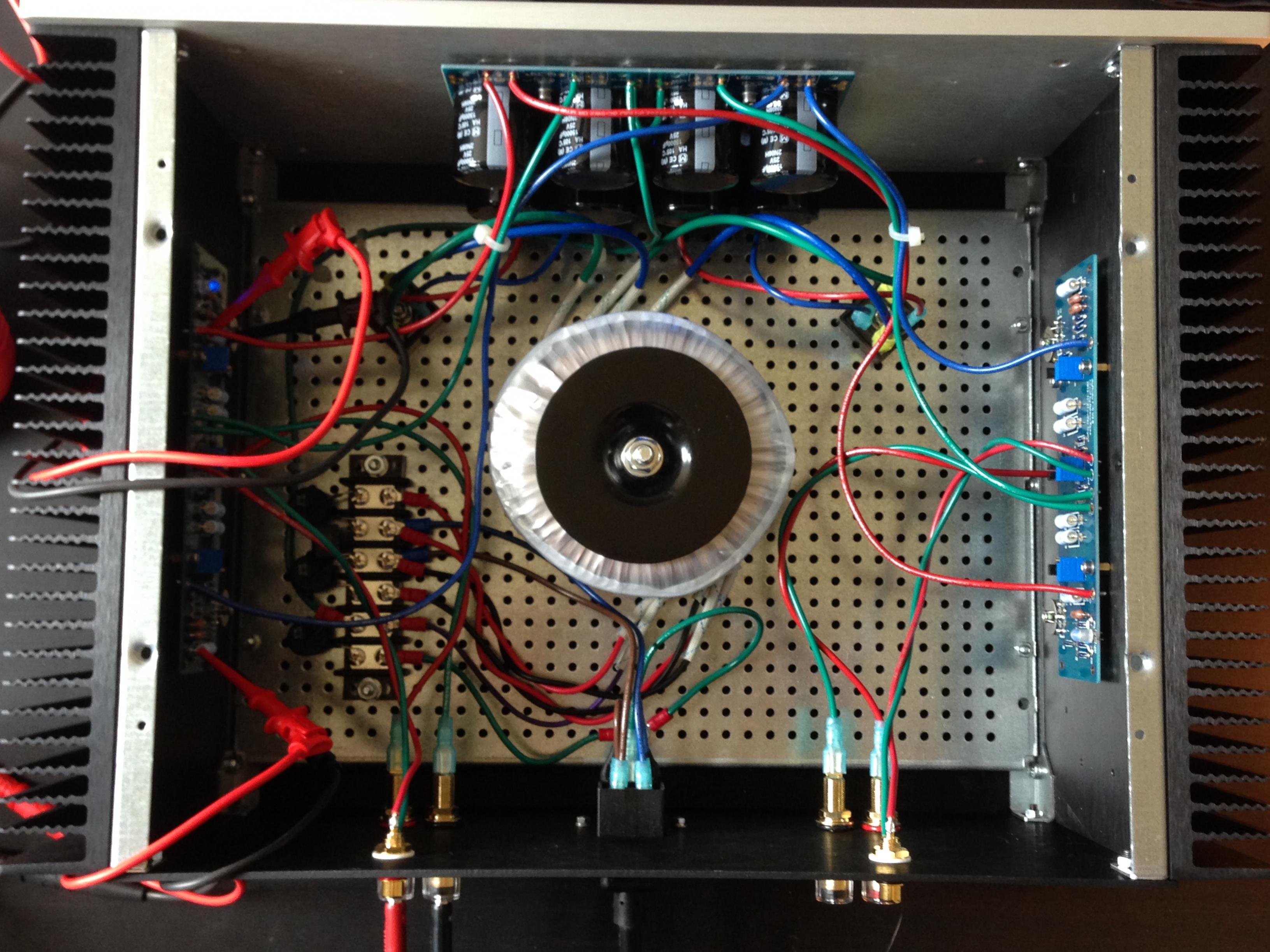

One more thing I forgot to mention. I left my dim bulb tester in place as I set the bias. When bias was at zero the bulb was off but as I increased the bias the bulb started to light up until it was bright. I am using a 75watt bulb. At first it worried me to see the bulb light up but then I figured maybe it's lighted because it's operating in class a. Am I wrong to think this?

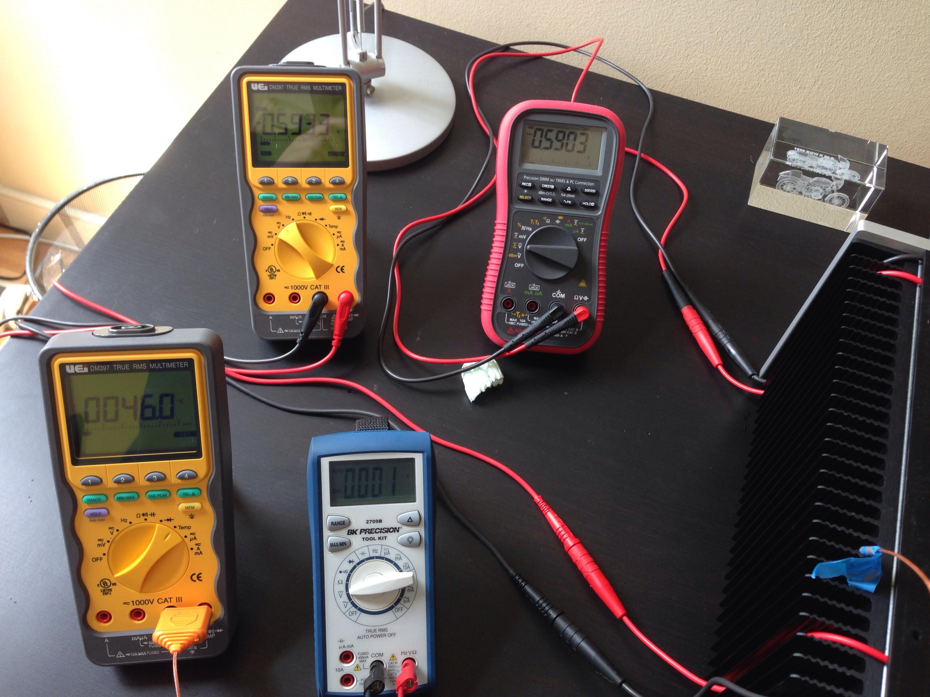

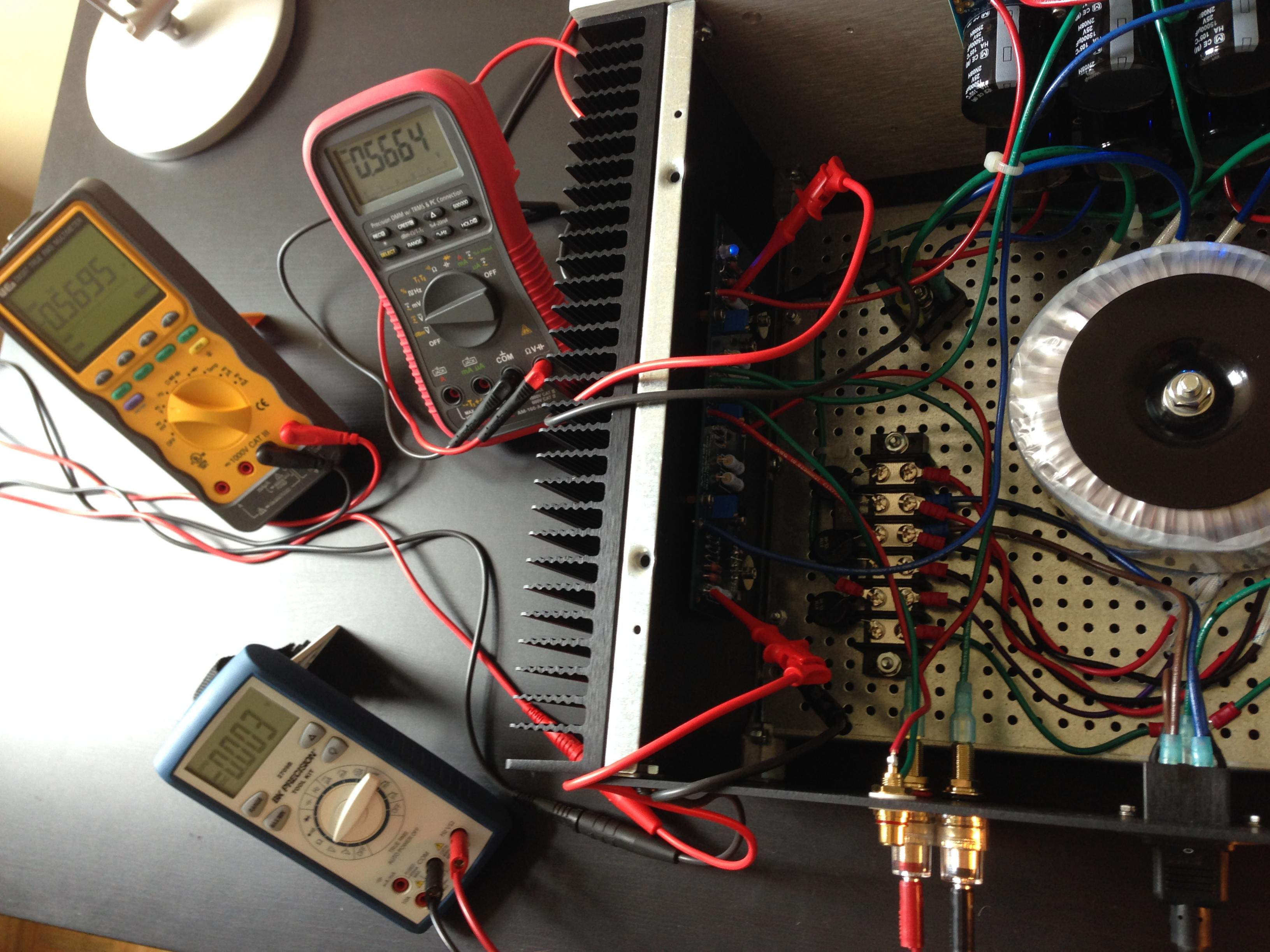

Photos

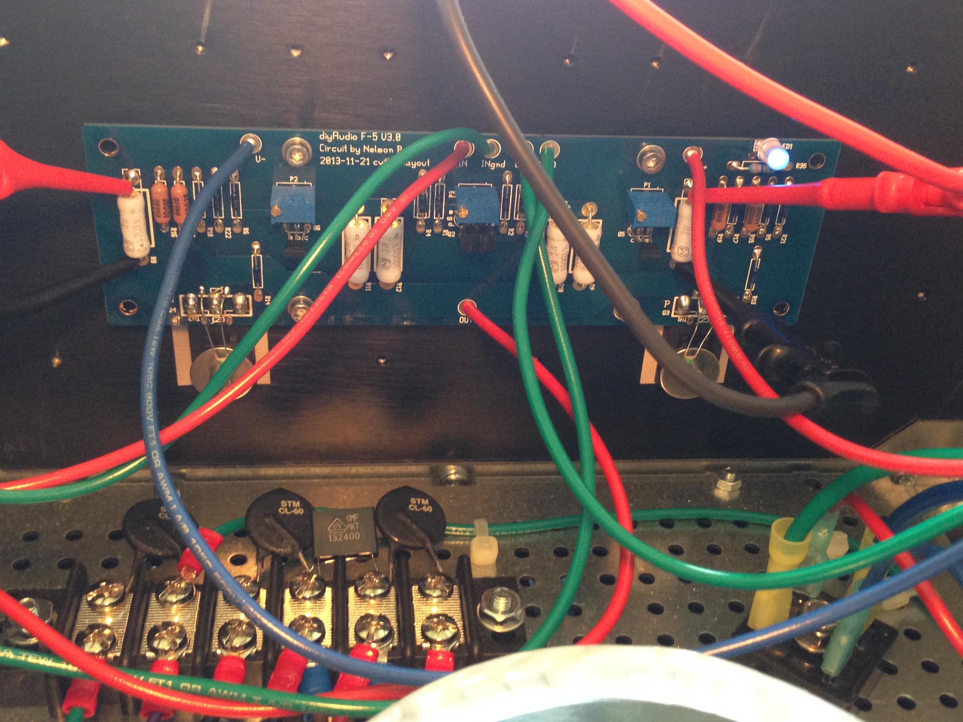

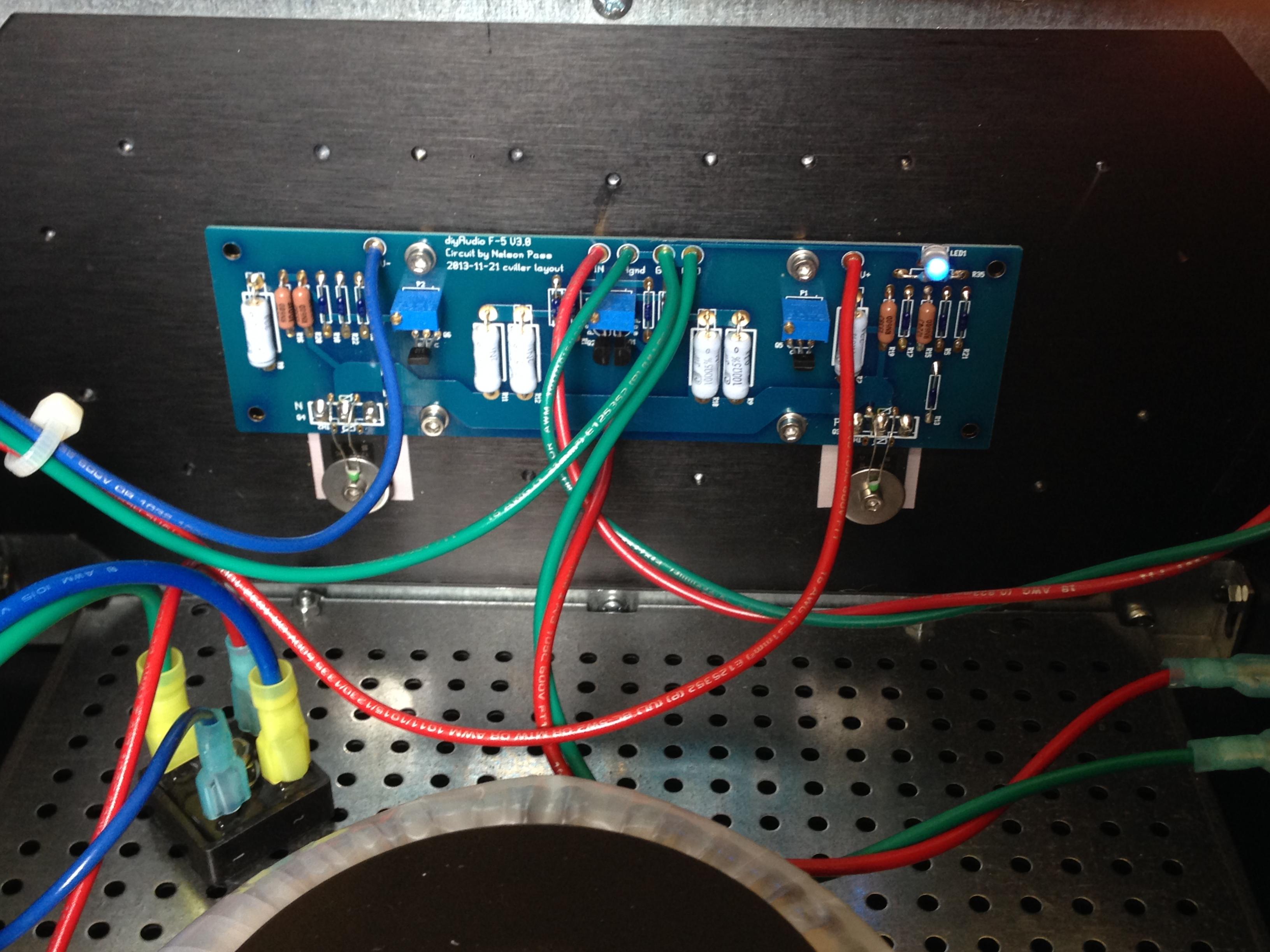

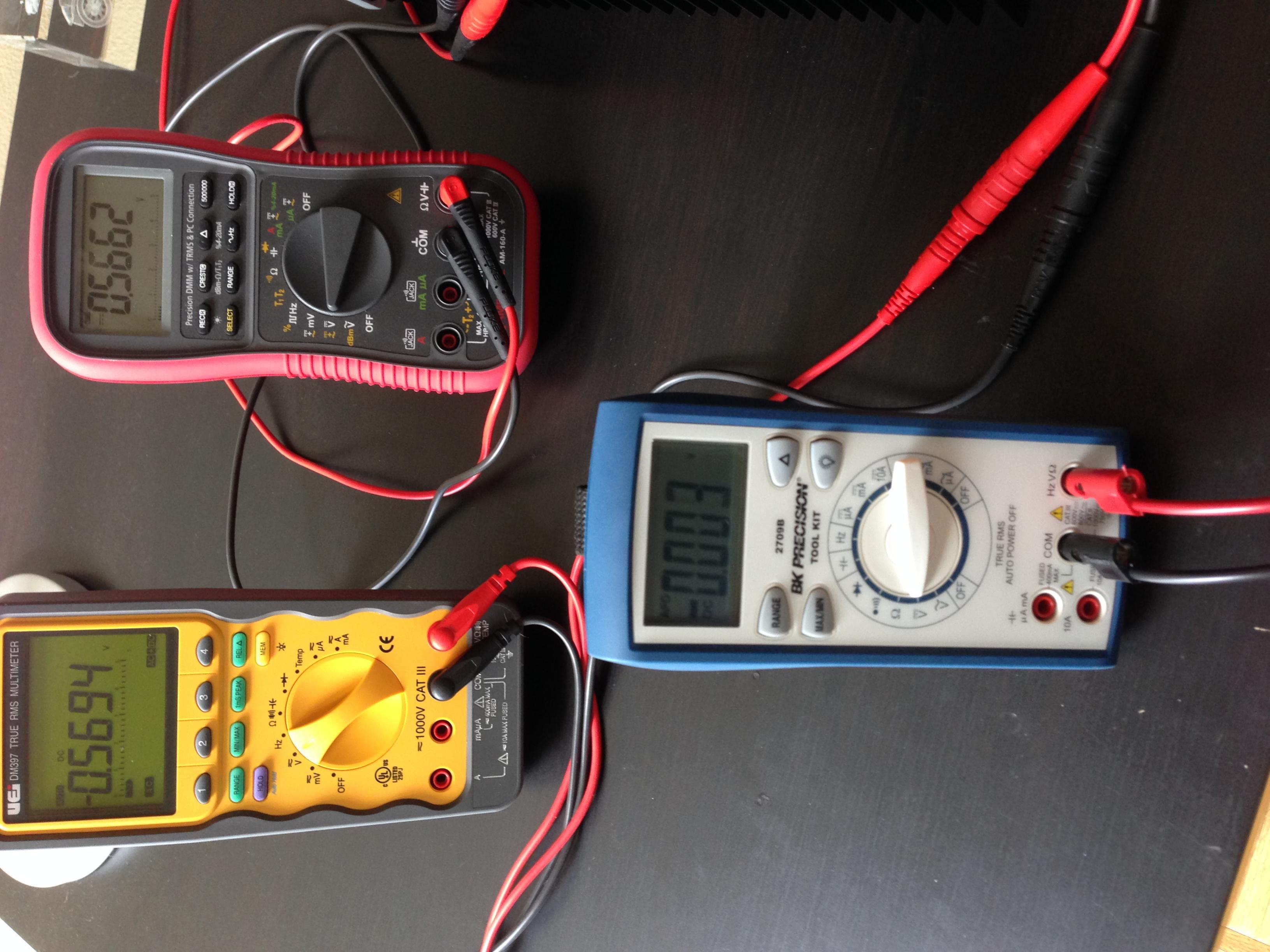

Here are some photos.
Photos show the measurements for the Right Channel:
Blue DMM is the DC offset
Red DMM is P1 R7
Yellow DMM is P2 R8
The bulb is a 75 watt and it only lights up when the bias is dialed up. I'll take it out of the loop as ZenMod suggests.
Also, the temperature of the heatsink is barely warm at .57V bias. Is this normal? I guess I could check the spec sheets to see how temperature ramps up as bias is increased?

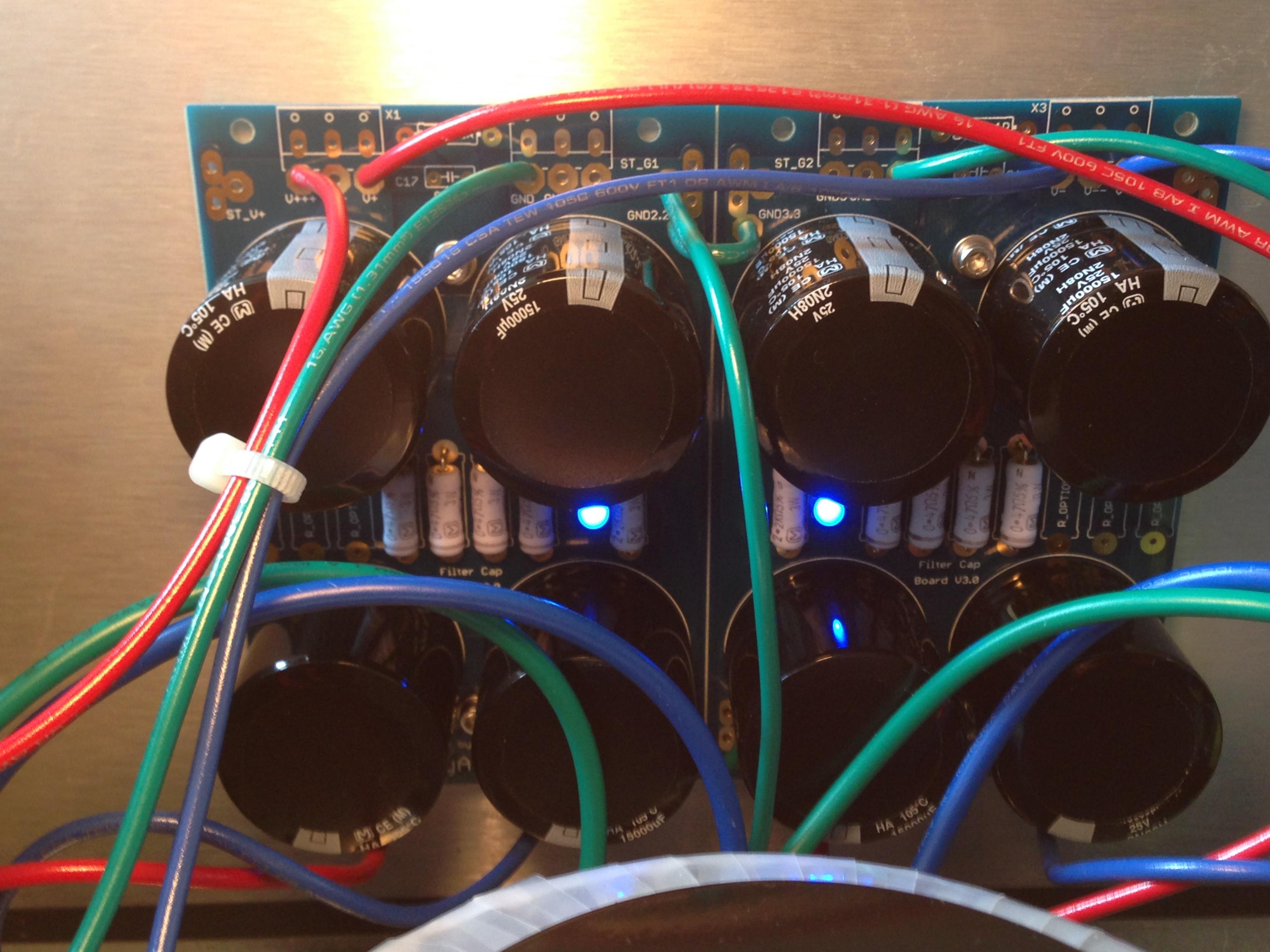

Another little thing, the LEDs on the channels are dim. I used a 33k resistor. I'll probably swap it out for a lower resistor like I used on the PSU to get a slightly brighter LED.

turn the bias adjusters back down to zero.
Power Off.
remove bulb tester.
Power On.
Start setting output bias in stages and wait till each pair of changes has time to heat the sinks to near final temperature.
When you reach 90% of the bias you want wait half an hour, while everything heats up.
Adjust towards the final 100% and attach the lid during each "wait" period.
Check offset periodically while the lid is on.
When you are satisfied that the amp temperature is stable, monitor offset and bias over at least 24hrs BEFORE attaching a speaker.
Not a believer in twisted pairs !
WOW! AndrewT and ZenMod were right about taking the dim bulb tester out of the loop. I use it as my safety net (large fuse) so I don't damage anything but I didn't realize it would affect measurements. I was afraid to take it out of the loop, thanks for the advice.
I reduced the bias down to zero and took the dim bulb tester out of the loop. I powered it back up and I immediately noticed much better bias adjustment (the voltage adjustment increases in larger increments without the DBT in place). At the moment I have it set to .4V to let it warm up a bit. It reached .4V with much fewer turns. I also noticed the heatsinks are now starting to warm up. I'm only working on the right channel for now. I'll set the left channel once I have the right channel sorted.
I'll keep everyone posted on the progress.
