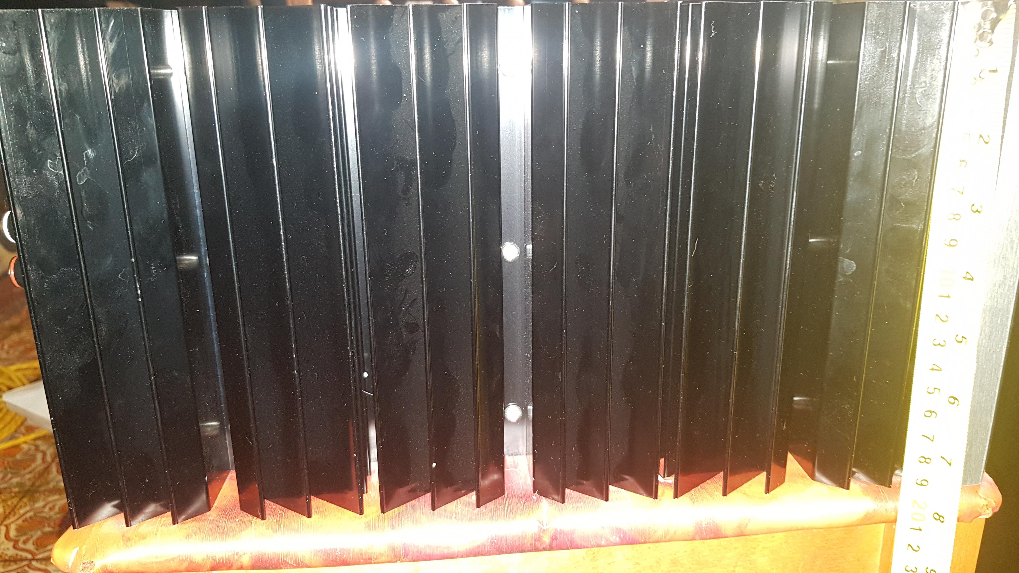

I read through the design spec and notes regarding higher wattages. I have read that two limiting factors to consider are the power supply and the heat sink. It is easy enough to beef up the power supply BUT my questions are about the heat sinking required. I would like to have a max power output of 100-150W and will be driving an 8 ohm speaker. How much heat sink is required to handle say 120 Watts. The enclosure I have has 14"deep X 8" high X 2.25" wide heat sinks. There is 1 this size on each side. It's a lot of heat sink. I am thinking of doing a stereo version but need to know if this heat sinking is enough. If not then I need to go monoblocks. The cases are expensive so if I can get away with one that would be best.
1) IS the described heat sinking enough?
2) I am going to use a thermostat - what temperature should I use for cutoff?

Sounds like a pretty decent sink. Use it and bias the amp up until the
sink settles in at 50 deg C. and be happy.

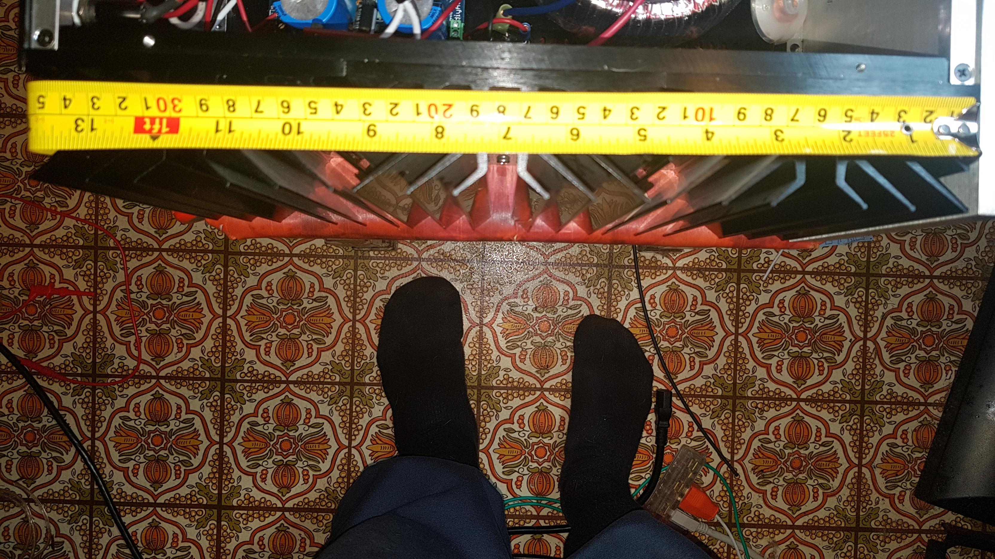

gimme a pic of your heatsinks
take in account , as reference - Modushop 5U/500(deep) case is good for 120-130W of heat per side

I am thinking of somewhere around +/-50VDC for the rails. I am OK with the power supply filtering but just wanted to know what +/- DC rails you have used in your build? Picture of the sinks are attached. Each sink weighs 20 kg.
oh yeah ........ you bought smaller PL knock-off from Aliexpress
you're good for 130W of heat per side ........
