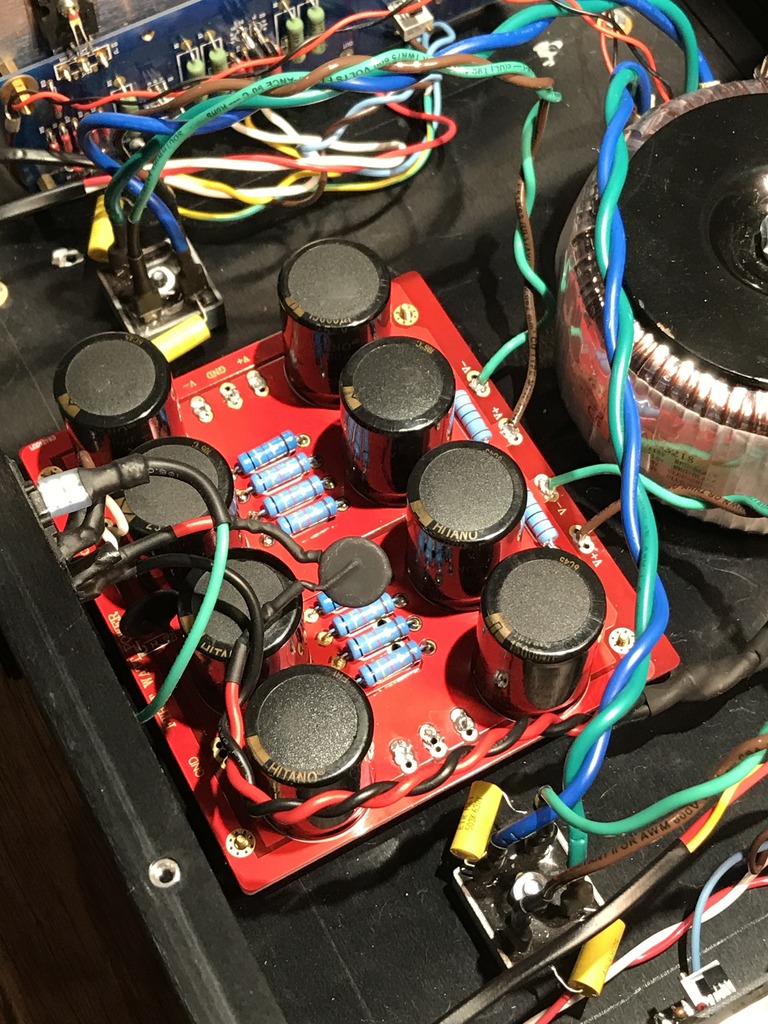

New to the Forum. Trying to finish this F5 build and I seem to have hit a wall and need to seek expert help! I had everything hooked up and was going through the steps in initial start-up and my fuse blew. I began disconnecting the boards from the power supply board and it still shorted out. Next I tried disconnecting one side of the ps board from its rectifier and no short. I swapped sides and still no short, but when I hooked them both up again (to the opposite side rectifier) the fuse went again... ?
So it seems that as long as I only have one side (no matter whichever side) of the PS board hooked up it is fine. But when I connect both left and right I get a Short.
I'm attaching some photos. Any help of advice on where to start troubleshooting would be greatly appreciated! Thanks

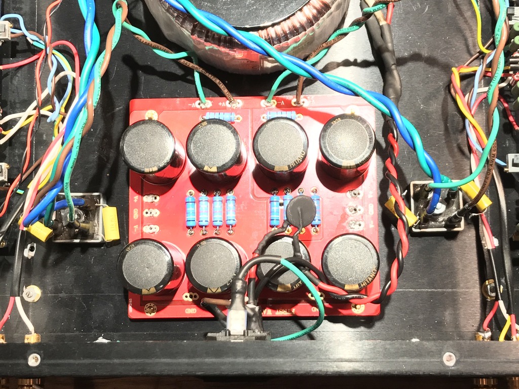

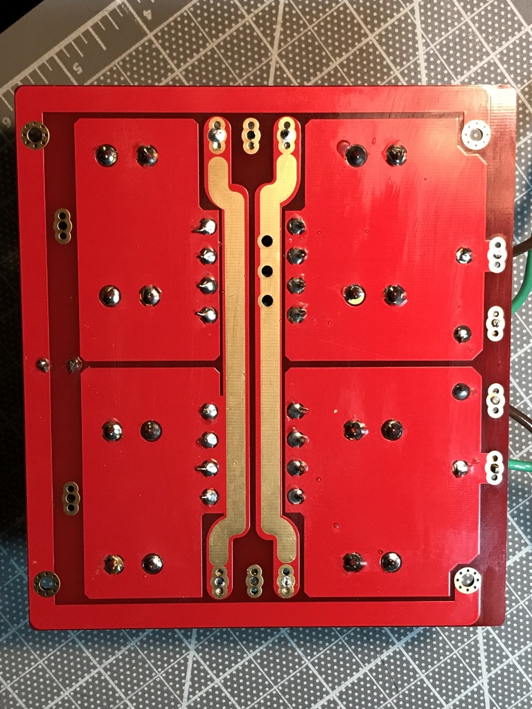

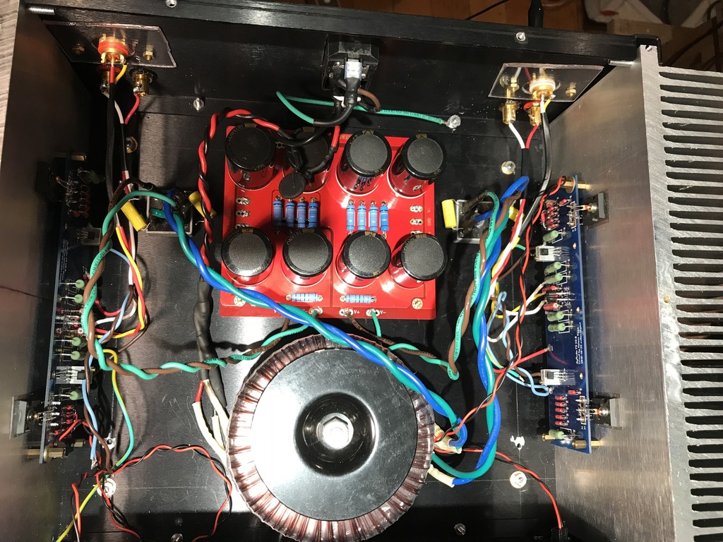

Attached are some photos of my F5 and Power supply board...
Sounds like a possible short between left / right on the filter board.

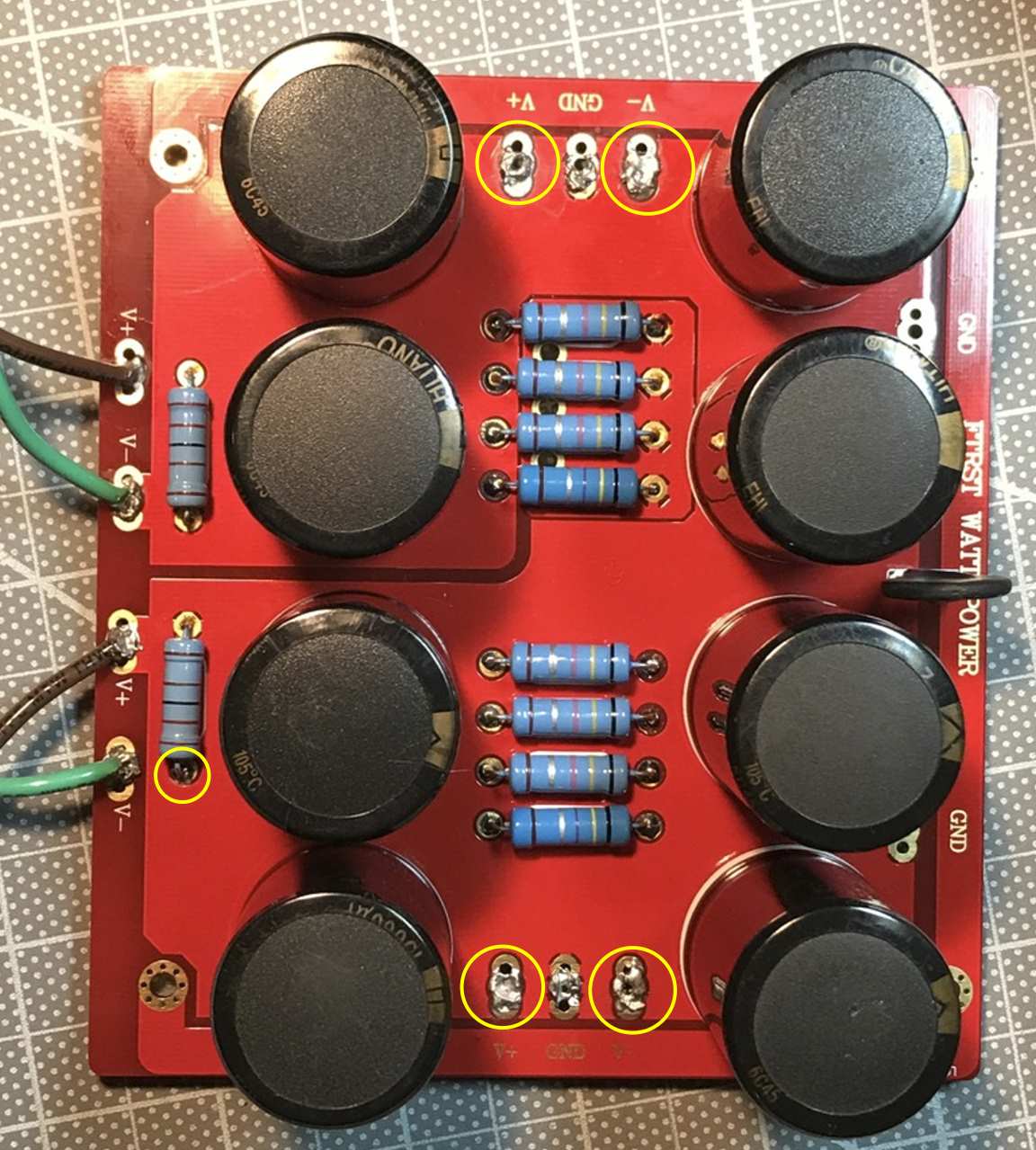

looking at the last two photos of the filter board, it looks like you might have possible solder 'bridges' shorting across too adjacent tracks.
So I'd start with a really good, close, well lit inspection, desolder, and resolder of the filter board.
Edit;
See pic, yellow circles, some of those look like they may be shorting to other tracks.
Edit 2.

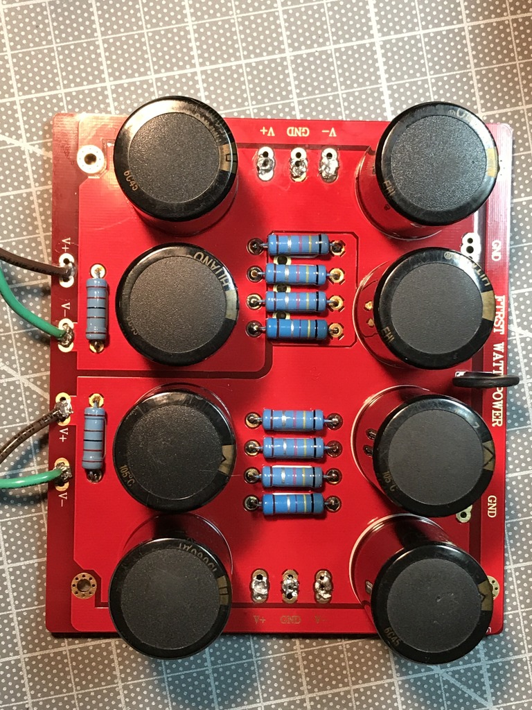

I also notice in the two strings of four resistors, that each string seems to have a single resistor with a different value, Is that correct for that board ?
So maybe double check the resistor values.

I don't like the big loop in the power thermistor wiring.
Can you rearrange the mains wires to minimise loop area?

Hello everyone and thanks for all the great advice! Read on, this story has a happy ending 🙂
OldNCranky- thank you for taking such a close look at my beginner soldering work. With the help of a jewelers loup and pright light I went over every joint and cleaned up everything. That last resistor on each side of the 4 sets is just from a different package so the bands are slightly off. They are all .47 ohm. After a careful inspection I hooked everything up and using a mains bulb tester (Thanks AndrewT, these fuses can get pricey!)... my short is still there.
So I decided to start from the start! What could I have messed up in my haste and excitement to get this baby running?! So Decide to measure my transformer secondaries and sure enough I had twisted the wrong pairs together! Swapped them and am now reading 25v on each side of the filter board! Whooo Hoo!!
