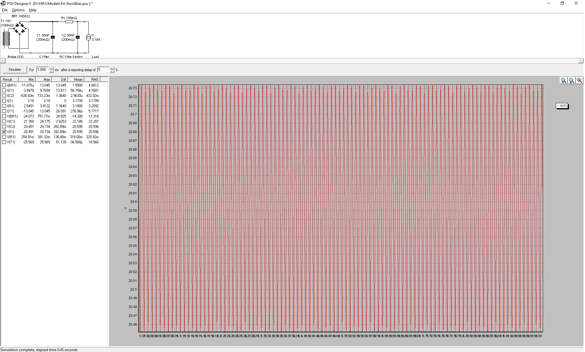

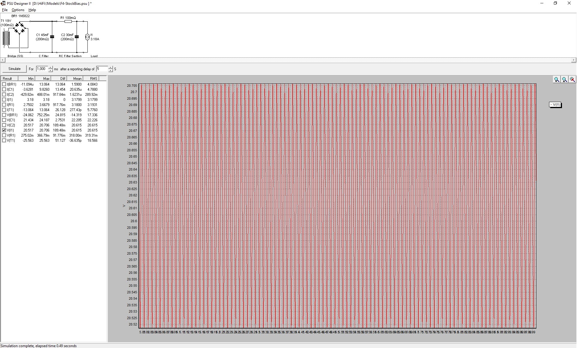

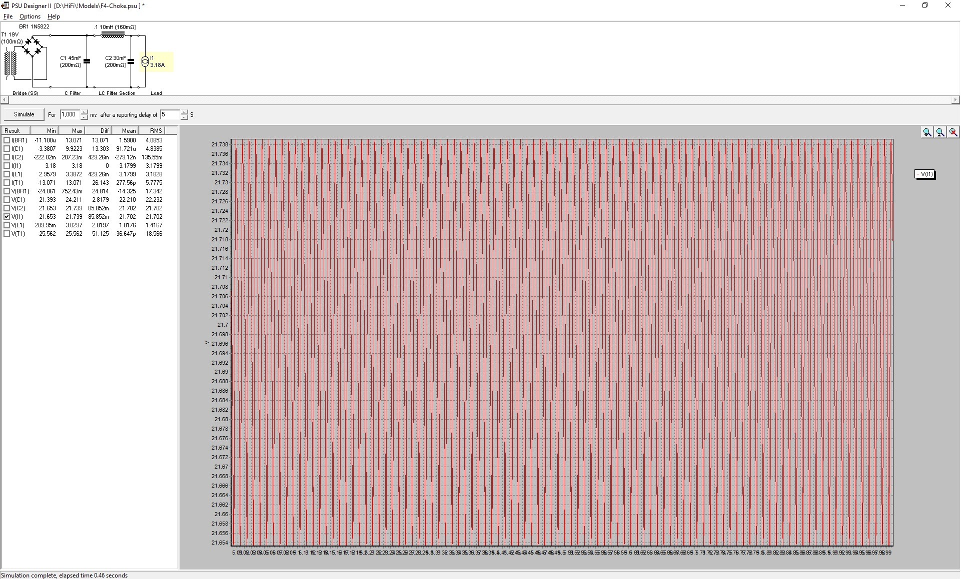

I had a few PSUD models saved from when i built mine, punched in your cap sizes and took a few screen shots for you, numbers are close enough to your measurements. The last one is with a Hammond 159ZJ chokes.I've got an F5, 0.61v bias

^ what he said. Putting the extra cap on the output side does almost nothing, only knocks off a few mv of ripple.Yes, definitely. The second C bank will have much less effect on the ripple seen at the rectifier output.
At some point there could be inrush current problems that will need to be addressed with a thermistor, etc.
Yes, there won't be much effect on the rectifier ripple, but it will still improve the sound in some cases.^ what he said. Putting the extra cap on the output side does almost nothing, only knocks off a few mv of ripple.

thanks for that McandMar, pretty close alright, only 20 odd mV out.. I need to get myself up & running with that PSUD2.
Hey could you run it again for me please with 88,000 uF capacitance per rail? Thats what I intend going up too so be good to see before I buy.

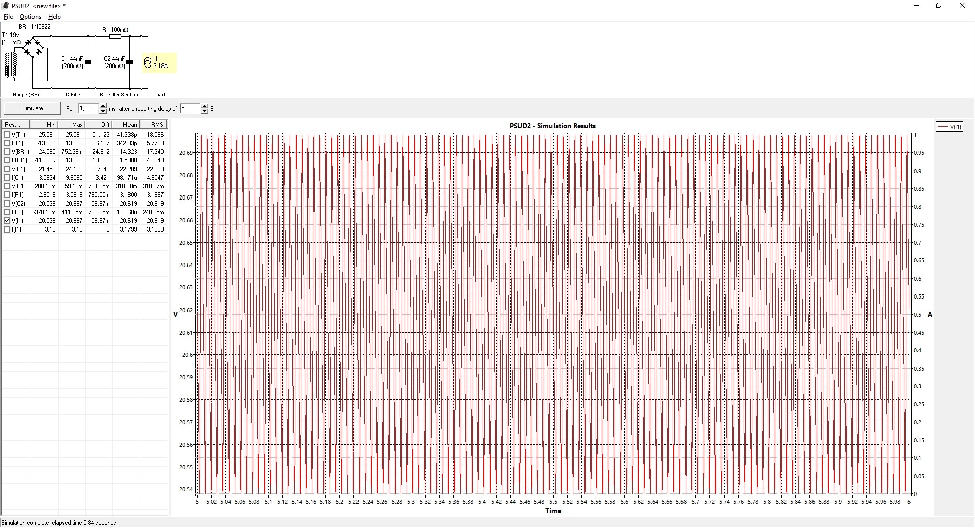

Sorry for dragging this somewhat off topic but I have been trying to get a handle on PSUD for a while now to simulate a CRCRC PS. Im sure I am messing something up in the transformer or current settings. Can you share the parameters you placed for the transformer, (nominal V and A, and primary V and offload V) and also the current source settings (stepped or constant and values). I am going to try and replicate your simulation and try an figure out where my errors lie. Lastly is the 1N5822 the actual bridge you used or just close enough? Ive been trying the GBPC3504. Thanks for any help, it just feels like I have one setting off which is leading to garbage data.
