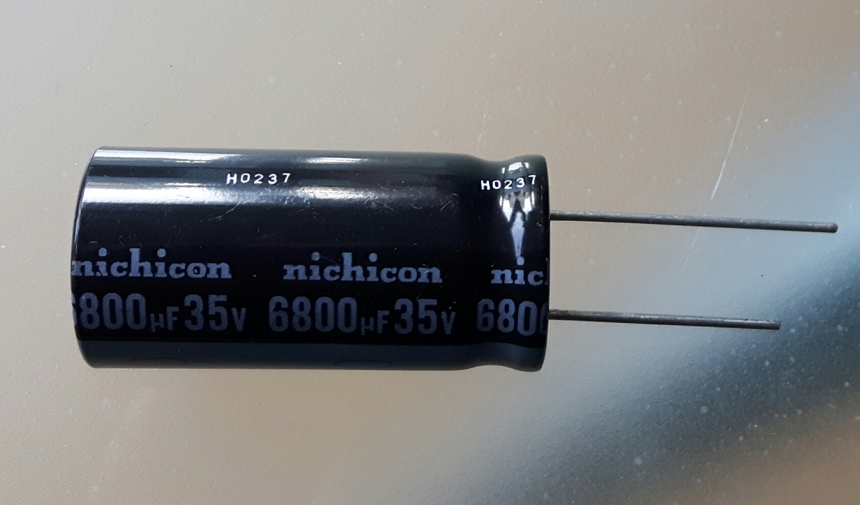

This one is a closer look at one from the last batch I ordered.
Someone who can say something about the date code H0237?
37 is the week number
02 is the year.
Reform them slowly right up to the 35Vdc rating.
Then check the leakage while holding that voltage.
Your cap should all meet the leakage less than 0.03CV.
But I would expect them all to be around 1% of that with a quite bit of variation.
If you have an esr tester then discharge them using 1k0 and hold them at that for at least an hour. Then check the esr.

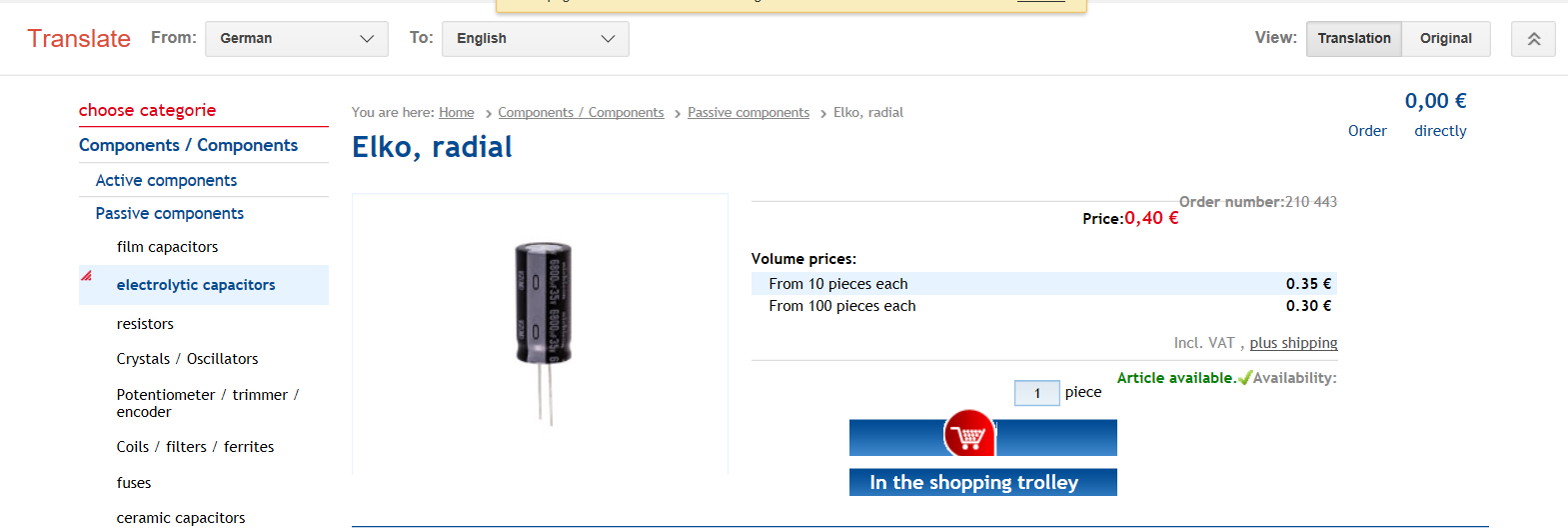

But I don't understand the language and there seems to be no english translation.
Can anyone help?
I tried to order some of these capacitors.
Can anyone help?
https://translate.google.com/translate?hl=fr&sl=de&tl=en&u=http://www.pollin.de/shop/index.html
It's work for you ?
Page nr 5 in passive electrochemicals section
I hope all OK now 🙂
I think ordering inthe google translator window is not possible. This will be no help for Andrew.
That's what I was afraid of. They are old. Hope it doesn't mean 1902...😀
no reason to worry ...... if they were stored properly , they're still greenhorns
I don't know what fields need entries because I can't read them.
I don't understand the address fields, they seem to be different from what we use in the UK. I got stuck (number of parts) & strasse (street)
Then the basket section has many fields and I don't know what I end up contracting to buy.
And of course I don't know how to get google translate to do that for me. I tried the link, but there was nothing there.
Try this. Enter the address of the site and click translate. Use two tabs so you can enter details on one page and see what the options are in English on the other.
