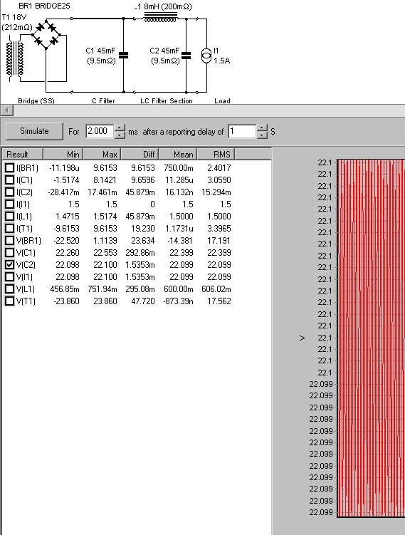

I'll give you a recipe for decent ~ 8mH chokes , good for at least 3Adc
when you measure what's asked for xformers , you'll see difference between CRC and CLC - I'll give PSUD files for both cases
considering amount of capacitance in which you invested , both approach will be overkill

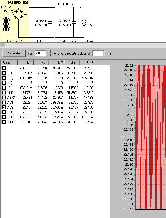

Rather than spending more money I would start off with the same supply Nelson uses, ie CCRCC, or since you have 24 caps you could try quite a few different variations eg CCRCCRCC or CCRCCCC etc.

as I promised :
PSUD sims for for CLC and CRC
in both cases assumed two bridges per xformer , each cap cell made of 3x15mF
choose whichever you want and don't loose your sleep over it
edit :
will edit files and repost , I made one mistake
- F5 monoblock power supply for 50Hz mains
