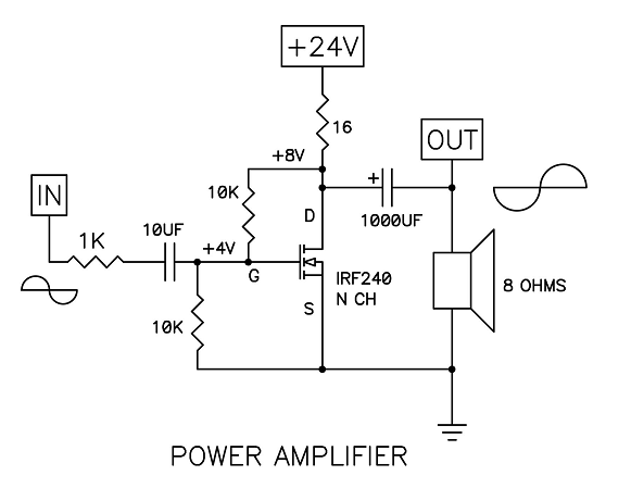

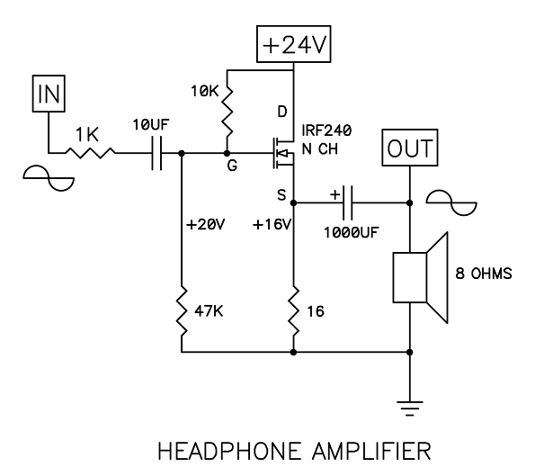

Hi all!
I'd like to play with the sample circuits shown on F5 Manual on this weekend and so I'd like to make a few questions:
1) I saw one of them is designed for headphones and the other is a regular power amplifier, but I'd like to know why this is so and what would happen if I use the headphone amp to power a regular speaker and vice-versa.
2) Is there any risk of thermal runaway on these circuits? If yes, should I limit their operation time to avoid it or is there any other trick during operation?
The circuits are attached.
Thanks in advance
Daniel

one is a common Source amplifier. The other is a common Drain amplifier.
Download the Pass tutorials that explain the operation of these basic one transistor amplifiers.

Heck,
go play with them, they are easy enough to switch around the parts or build both.
Be SURE to heatsink the Mosfets, they will get HOT.
Also, you do not need *exactly* the voltage shown... or exactly the cap values shown either.
Anything close will function, like ripped out of an old computer monitor or TV chassis? 😀
If you test them both, the difference between them will be instantly apparent! 😀

Hi all!
Firstly, thanks for everyone's answer! 🙂
AndrewT, I wrote F5 on the thread title because I found these samples at the beginning of the F5 manual, together with some basic explanations and examples about transistors/electronics etc.
I've simulated both on Multisim but just common drain seem to work. I'll post the common source output waveform here tomorrow to see if someone can help figuring out what goes wrong.
Also, what's the purpose of the 1k resistor between signal input and the input cap? Leaving it out removed some output attenuation in respect to input signal on simulation, but I don't know if it secure to do so in real life.

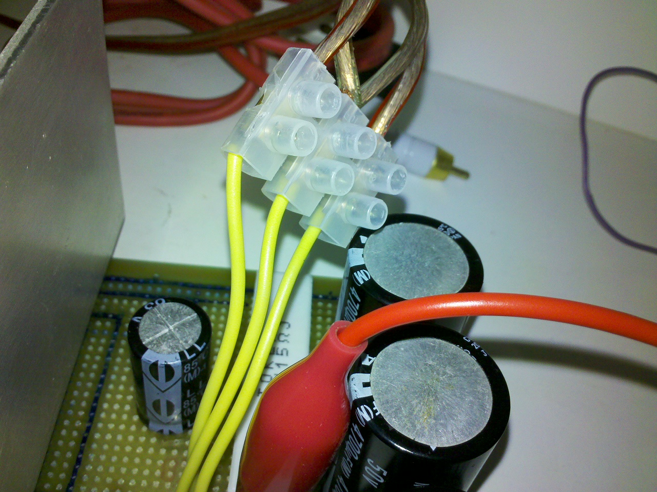

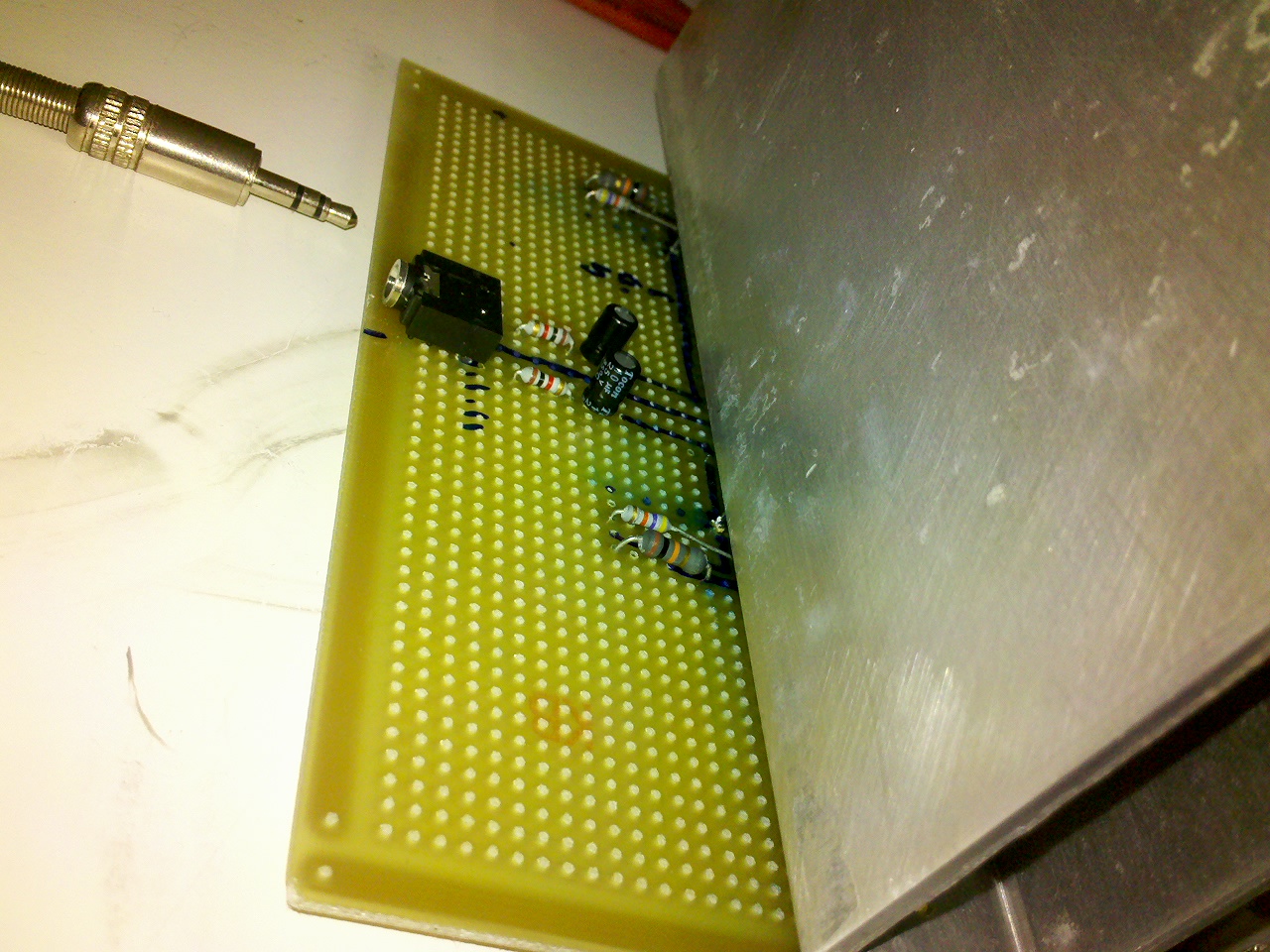

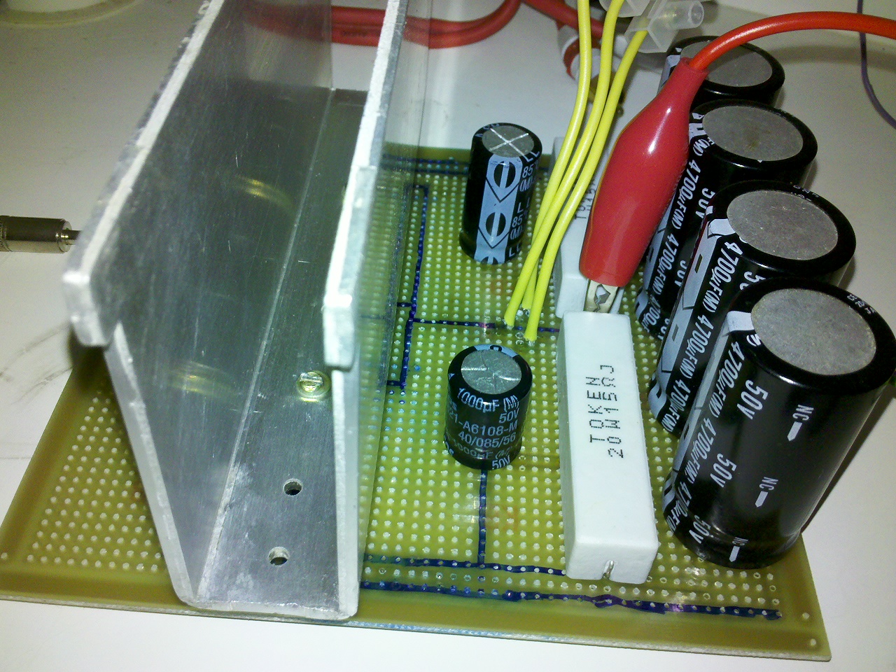

Hey guys 🙂
I'm glad to say it worked.
I've attached some pictures of the build.
First try was with 2SK1530 on one channel and IRFP960 on the other. I've supplied it with 12V and got ~500mA bias on 2SK1530 and ~300mA on IRFP960.
I was expecting better audio quality from the Toshiba, but I couldn't perceive any difference between the two, at least with my headphone (Technics RP-DH1200). I got a lot of hum, I don't know if it was because trafo rating was too small (1A) or 4x4700uF caps weren't enough. I have also 4x0,47uF on the other side of the board.
Then I replaced 2SK1530 with another IRFP960 so that both channels share current equally and used a 90W (19,5V x 4,65A) Dell Laptop PSU to feed it still with the caps. Noise was completely gone (except if input is floating), and both output devices run at ~750mA bias.
I could get 1.5Wrms per channel, being feed from a M-Audio sound card with high level output, on 4R speakers with 10" Woofers. That gave me a nice listening level without distortion.
