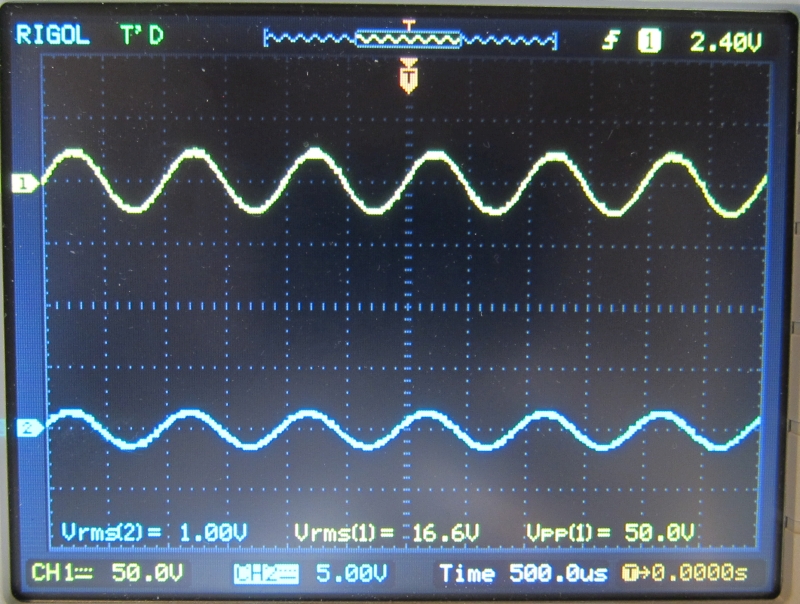

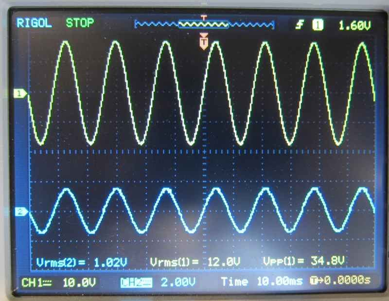

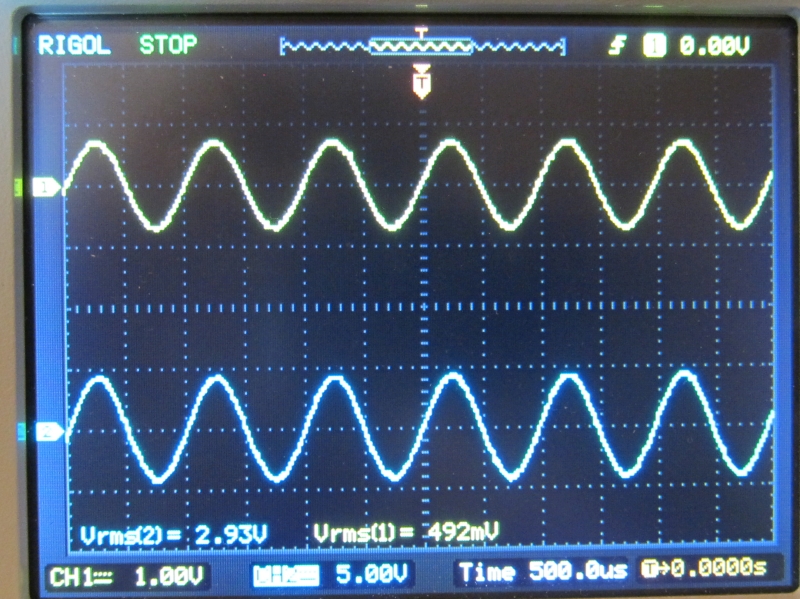

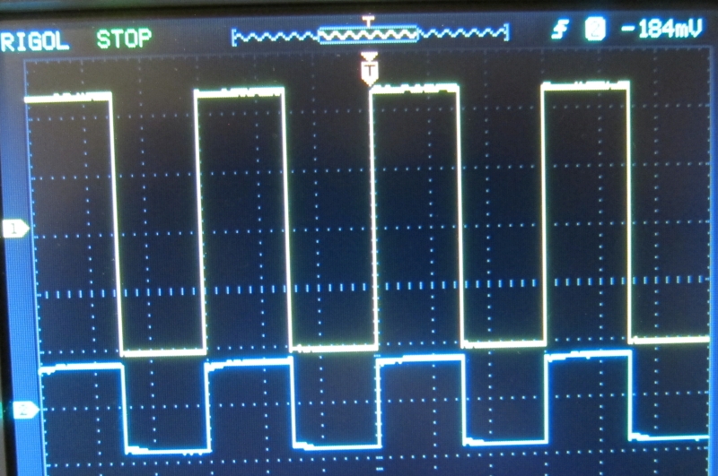

Some waveforms
I attached some photos. First is baseline on the L channel with input (yellow) on channel 1 and output (blue) on channel 2. Gain = 5.95 (2.93 / .492). Unfortunately, I never checked gain at baseline on the R channel, but a couple years ago it was 6, as expected.
Second photo is L channel after changing from 100 to 220 ohm feedback resistors - note that channels have reversed. Input in blue on channel 2 and output in yellow on channel 1. Gain = 11.76 (12/1.02).
Third photo is R channel after changing resistors. Input of 1V in blue and output 16.6V in yellow for gain of 16.6. Bias and offset were fine.
Fourth photo is R channel several minutes later, after which I powered down the amplifier.

Hi
Vpp on the output is noted as 50V in the third shot, what rails are you running? 50V doesn't seem possible from a 48V supply unless something is terribly wrong or you have a custom supply voltage.
Sometimes parts will test good with a meter and not work correctly when in the circuit, so no real way to tell except one by one. Obviously it is something to do with the feedback itself.
It just seems to me the amp was running open-loop (a dry solder, maybe, or a damaged via?) and the only reason you saw 50Vpp was because it was basically the limit of the voltage supplies. Perchance do you have 29-30V rails?
Interesting discovery, sangram. They are ±24V rails (about 22 to 23 under load). It is not possible to see 50, and I have rechecked rails since removing the board and both sides of the amp are reading about ±23.6 VDC. I wonder what that was about?

I wouldn't worry too much about the voltage measurement if you took it off an oscilloscope. The ADC resolution would be lower (and less accurate) at lower input voltage (much like DACs, actually - think of it as bit loss but in reverse). 12 x 1.4 = 16.97, which is 33.9Vpp and the oscilloscope is reading 34.8V. At a lower input you can expect the reading to be significantly less accurate. I understand that you may not have been able to fit it in a 20V/div window, which is why we don't use digital scopes to make measurements.
A True RMS meter would give you a better 'picture' of the actual output voltage. Obviously it is not a small difference but not one I am startled about. Maybe it's an unrelated fault?
12V RMS is also a lot of output, close to -3dB of total amplifier power. If no dummy load was connected the output devices are put through a lot of stress. You didn't indicate if there was some load or not and what it was.

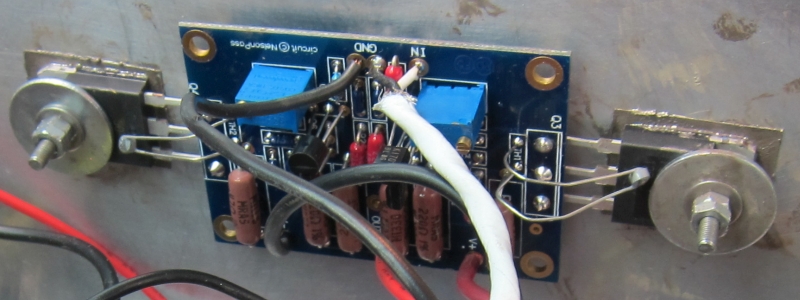

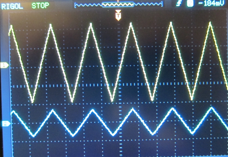

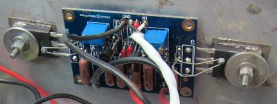

I finally got back to this amplifier. I built a new board with completely new components, but used the same 220 ohm feedback resistors, and installed it back in the amplifier (first photo - please excuse thermal paste on the heat sink). It biased up fine after an initial power-up with a light bulb in series (as always). I biased both channels to 1.2A without difficulty, and they held quite steady.
Wave forms on both channels were excellent (without the addition of a capacitor across feedback resistors), and I've shown the new channel in the photos, below. These were at 1 KHz, 1 watt output (2.84 V RMS into 8 ohm 100 Watt dummy load).
I then measured gain at both 1 KHz and at 60 Hz using digital volt meters and using the scope. Both methods gave identical results. Voltage gain in both channels was identical at 11.4.
I still am not sure what was wrong with that bad board, but it must be a JFET or MOSFET I would imagine, though I suppose it could have been a problem in the current limiting circuit. The board looked fine and all resistors measured fine when I disassembled the board. All transistors measured identically to new, identical transistors, using a diode checker and ohm meter. When I have some time, I'll put those transistors on a couple different transistor testers I have and see how they perform, but I don't have a curve tracer.
