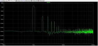

I have a question.
A quiet room measures about 40dB.
If I listen to music with peaks never exceeding 100dB would it be fair to say that harmonics that sit below 60dB down on the FFT are completely inaudible (100-60 = 40dB Silence)
