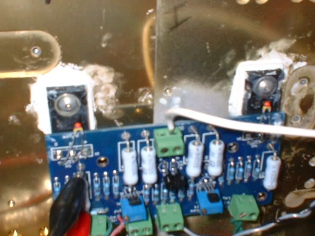

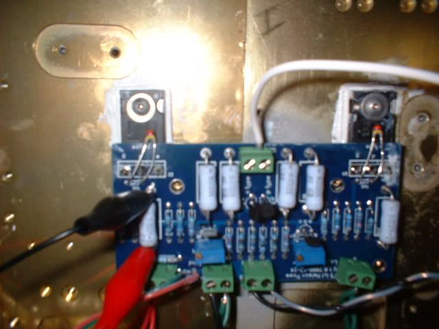

Some pics...not good. BTW- I used IRFP9140 P-ch (100v 21a) and IRFP140 N-ch (100v 33a)
Used 2.2k for R3 and 4 from Fig 6. Should I go higher than 2.2k?
http://i145.photobucket.com/albums/r216/vdinenna/Audio Projects/DSCF0100.jpg
http://i145.photobucket.com/albums/r216/vdinenna/Audio Projects/DSCF0101.jpg
http://i145.photobucket.com/albums/r216/vdinenna/Audio Projects/DSCF0102.jpg
http://i145.photobucket.com/albums/r216/vdinenna/Audio Projects/DSCF0103.jpg
http://i145.photobucket.com/albums/r216/vdinenna/Audio Projects/DSCF0108.jpg
http://i145.photobucket.com/albums/r216/vdinenna/Audio Projects/DSCF0109.jpg
http://i145.photobucket.com/albums/r216/vdinenna/Audio Projects/DSCF0110.jpg
http://i145.photobucket.com/albums/r216/vdinenna/Audio Projects/DSCF0112.jpg
As you can see, I added board connectors this time for quick removal!! 🙂

Its hard to see cos the pics are a little out of focus, but it kind looks like you have the jfets reversed? Its probably just the blurry pic, but thought I'd say it anyway........ yes, you guessed it, guess what I did with my first attempt at building!!
Fran
Fran

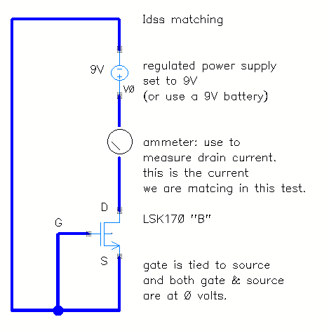

When you measured those JFETs, what do you mean by
.29 and .18 ?
.29 and .18 ?
The .29 and .18 values are from the Idss matching when I built the B1.
I have jfets with higher Idss values.

Doh! I suppose I screwed up rather badly is what that is. 😱
I was measuring DC instead of current.

The Q5 and Q6 - yours look really flat like ztx parts. but IIRC, cviller boards were made for BC550/560. If thats the case, maybe the pinout is different?
Just clutching at straws here.
Fran
Fran

Yes, I used the ZTX450 and 550. They were to go in backwards compared to the BC transistors.

Well, that might mean that you haven;t matched them, but dosen't mean that they are not working!
