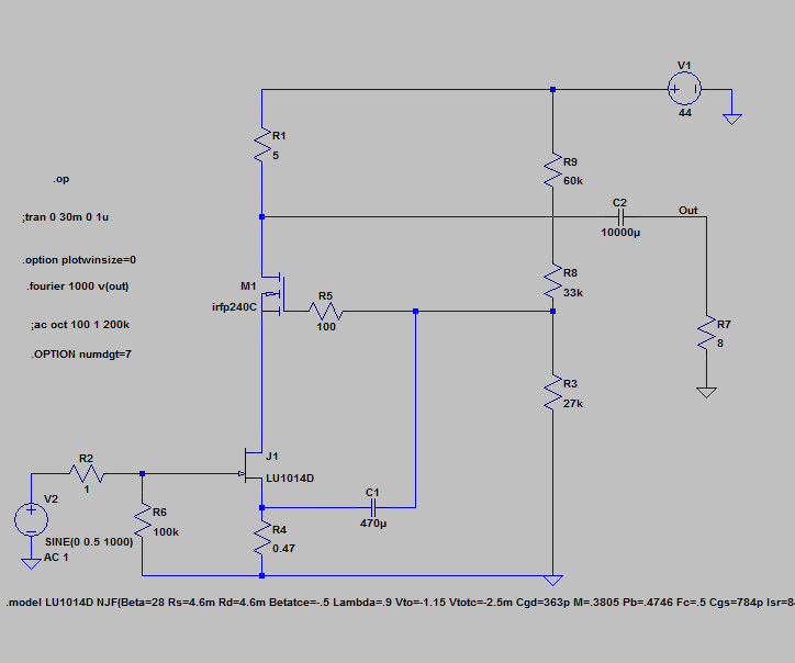

2 circuits based on F3 design.
The first one is Zero Feedback and gives excellent performance but highish output impedance (11 Ohms if I am not mistaken).
The second one is the one that interests me most but what are my options for lowering output impedance without adding feedback?

Ok going to build this one first. Don't need much gain anyway so this will do the job.
Might even drop the drain resistance to 3 Ohms.

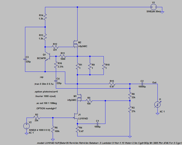

While I am at it I may as well build this Circlotron circuit.
Looks like a bridged amp with 2 power supplies, not circlotron. 😉
Check out the "new-tron Isotope 1" or something like that. A Grey Rollins creation.
Looks like you are correct. It appears to current clip.
I built a circlotron many years ago, source follower though, it worked perfectly after some time messing around with it.
I referenced Mike Rothacher's basic circuit. Does this mean it is incorrect?

I used your lu1014d model, are you happy enough with it to believe the simulations.
You have a good eye.Except for the P ch symbol that has N next to it 😀

This one is dedicated to Zen Mod
The Choke loaded version.
Extremely good performance from a simple circuit. The choke is 30H with a series resistance of 5 Ohms. Hopefully that won't be too difficult to either purchase or build. Might be able to reduce inductance some to get the 5 Ohm DC resistance value. I'm totally inexperienced when it comes to building chokes
Lu1014d is at 11 Watts dissipation (Rated as a 69W part) hopefully 11Watts is ok. Either way I can easily reduce it if needed.

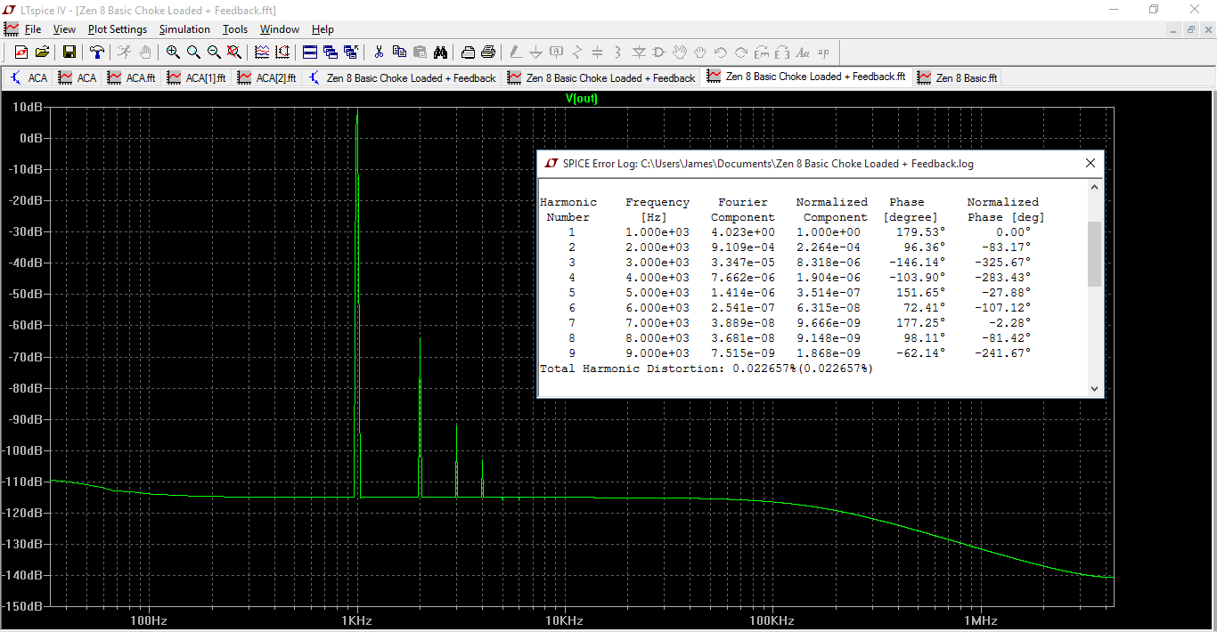

Here is the distortion at 1W rms. Fairly impressive. A lot to like here.
I don't need a lot of gain so that is why I chose those feedback values but if you need more gain, R2 can be changed to 9k and R6 to 50k

Must have been smoking some of Dutchies finest product, 2H is more than adequate on the inductor.
