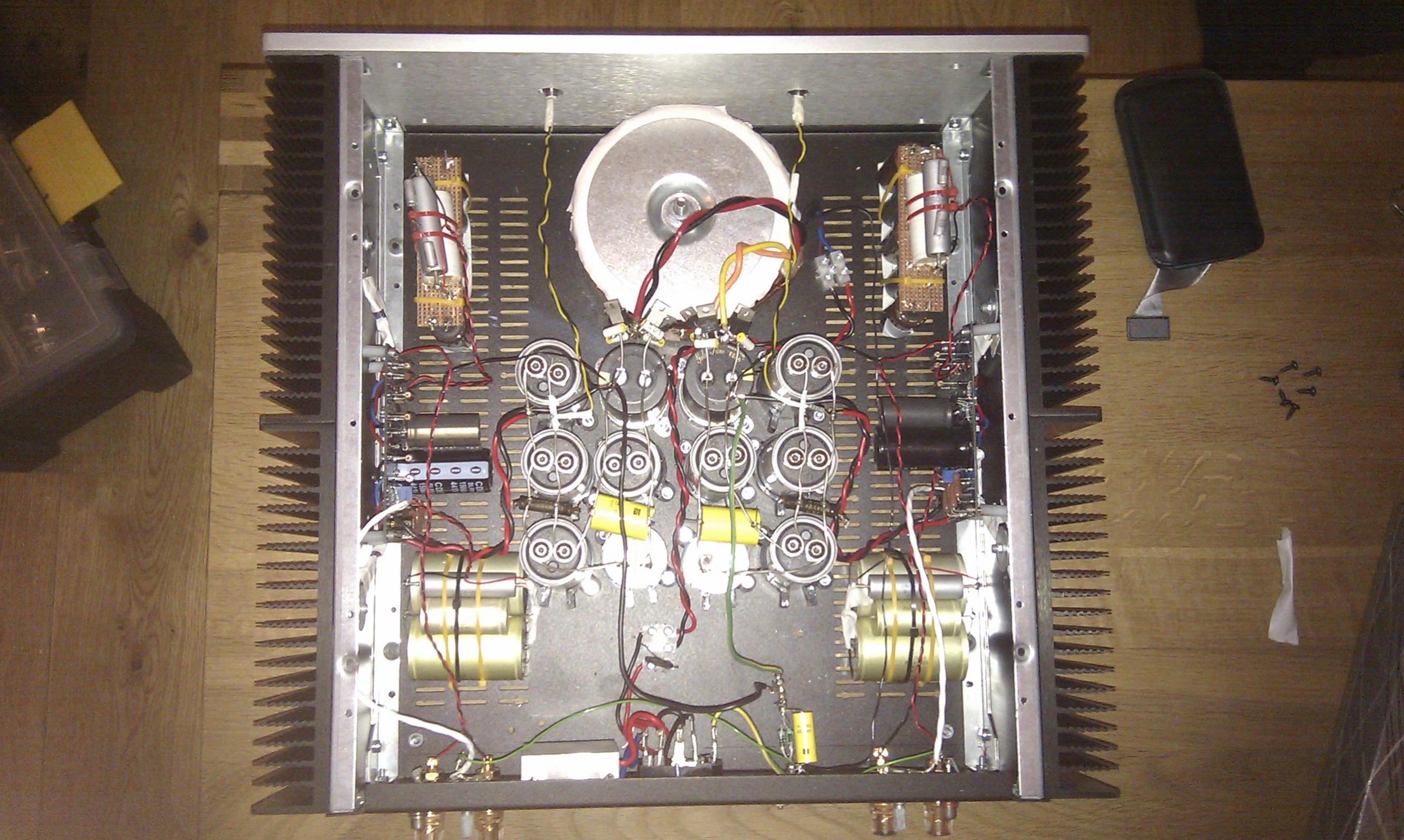

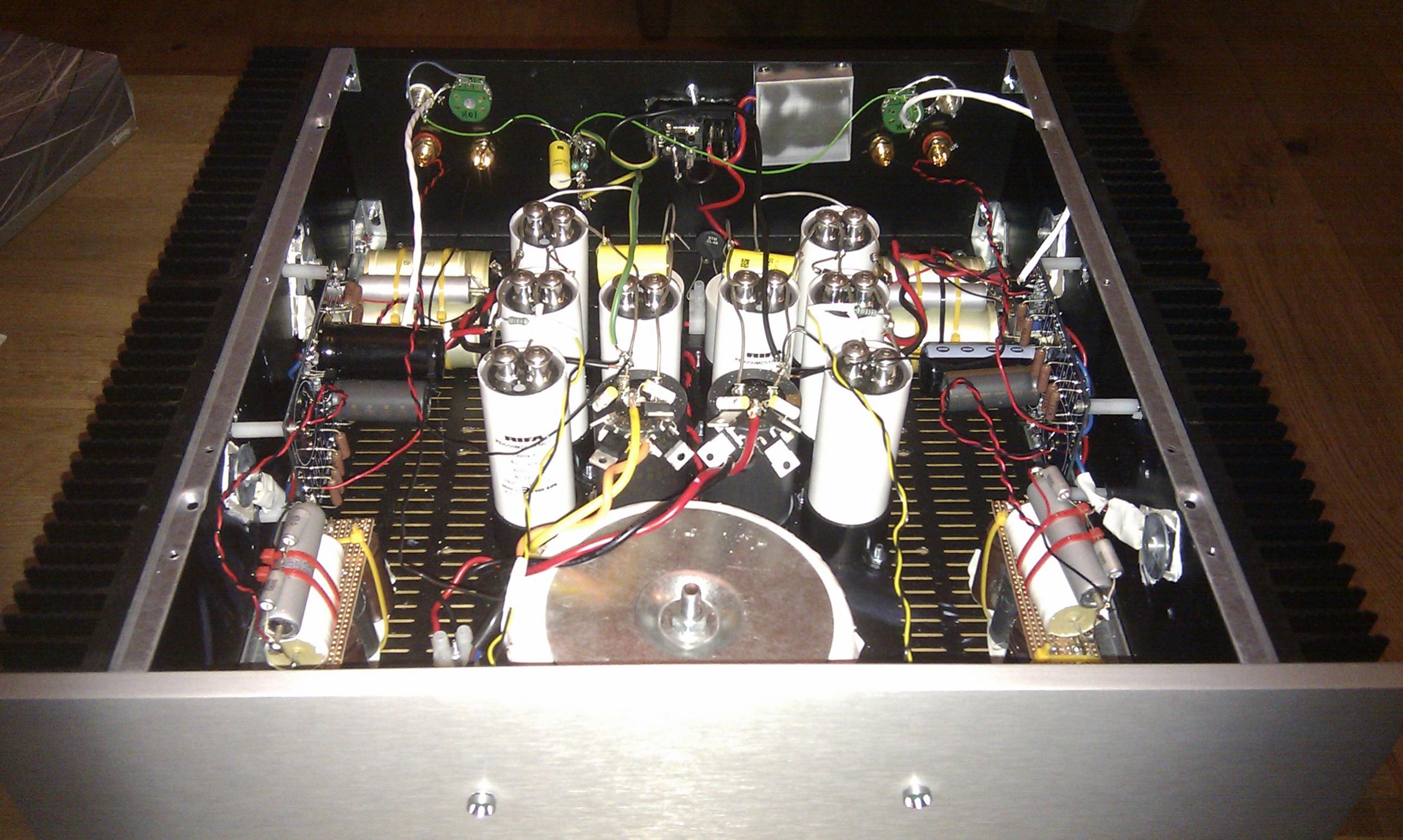

So, I finally finished wiring up the F2J with the LEDs and added a electrostatic shield to the transformer. I wish I had the foresight to get the transformer company to fit the shield, that would have been much, much easier!
Some photos of the inside.
My F2J soundstage bests the F5 (IMO). I build it using as cheap as parts as I had around and it sounds amazing. I am stuffing another PD board and getting some better parts to see if actually sounds any better.
The new parts are low PPM Mills resistors, PRP signal resistors, 10Uf Auricaps for input ,Mudorf New 10,000uf E-caps for the output.
I use 25R Mills-MRA-12 on the output running into a 15R Lowther PM5T with copper VC.
I was lucky enough to have some more 'exotic' parts in my parts bin from some previous valve projects, so I had a load of Elna Silmic IIs, Russian surplus teflon caps and some bigger Russian surplus polystyrene caps. Needless to say they all got used.
I can't compare my F2J to any other version, but it beats my F5 (that it replaced) on my single driver speakers hands down. The F5 was no slouch either.
The mids and highs compare with my PX25 single ended mono blocks and the bass on the F2J just blows them away.
