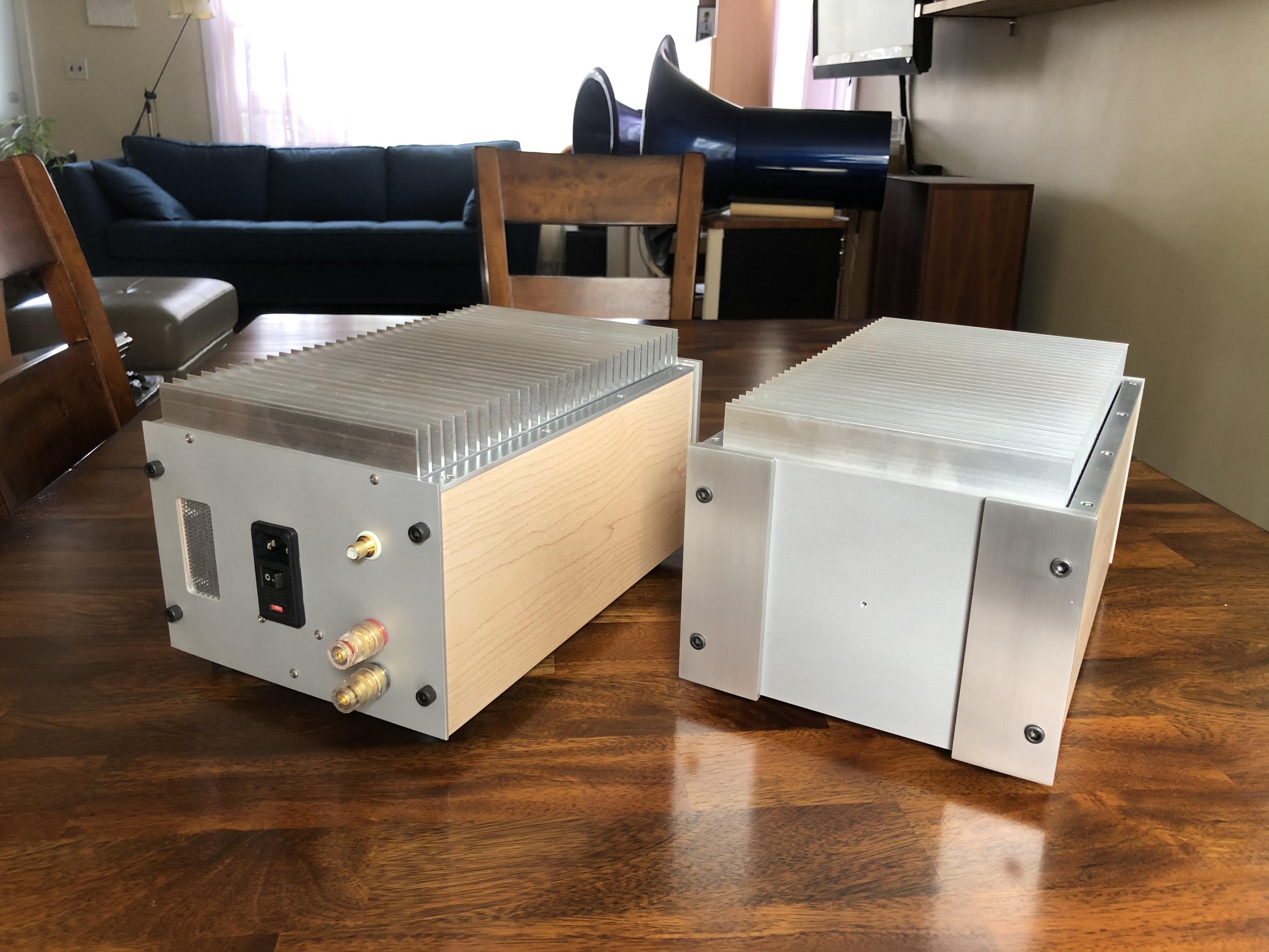

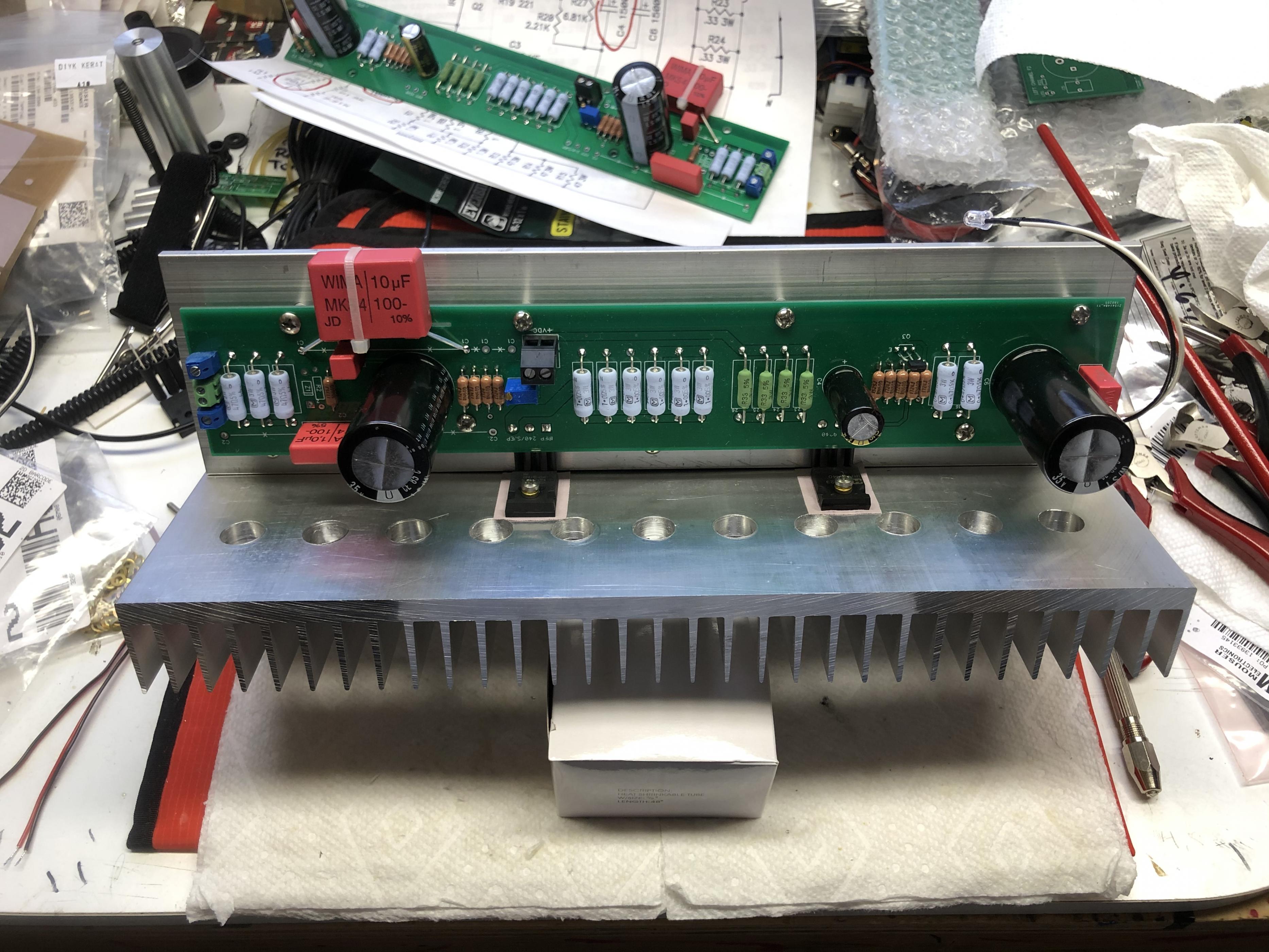

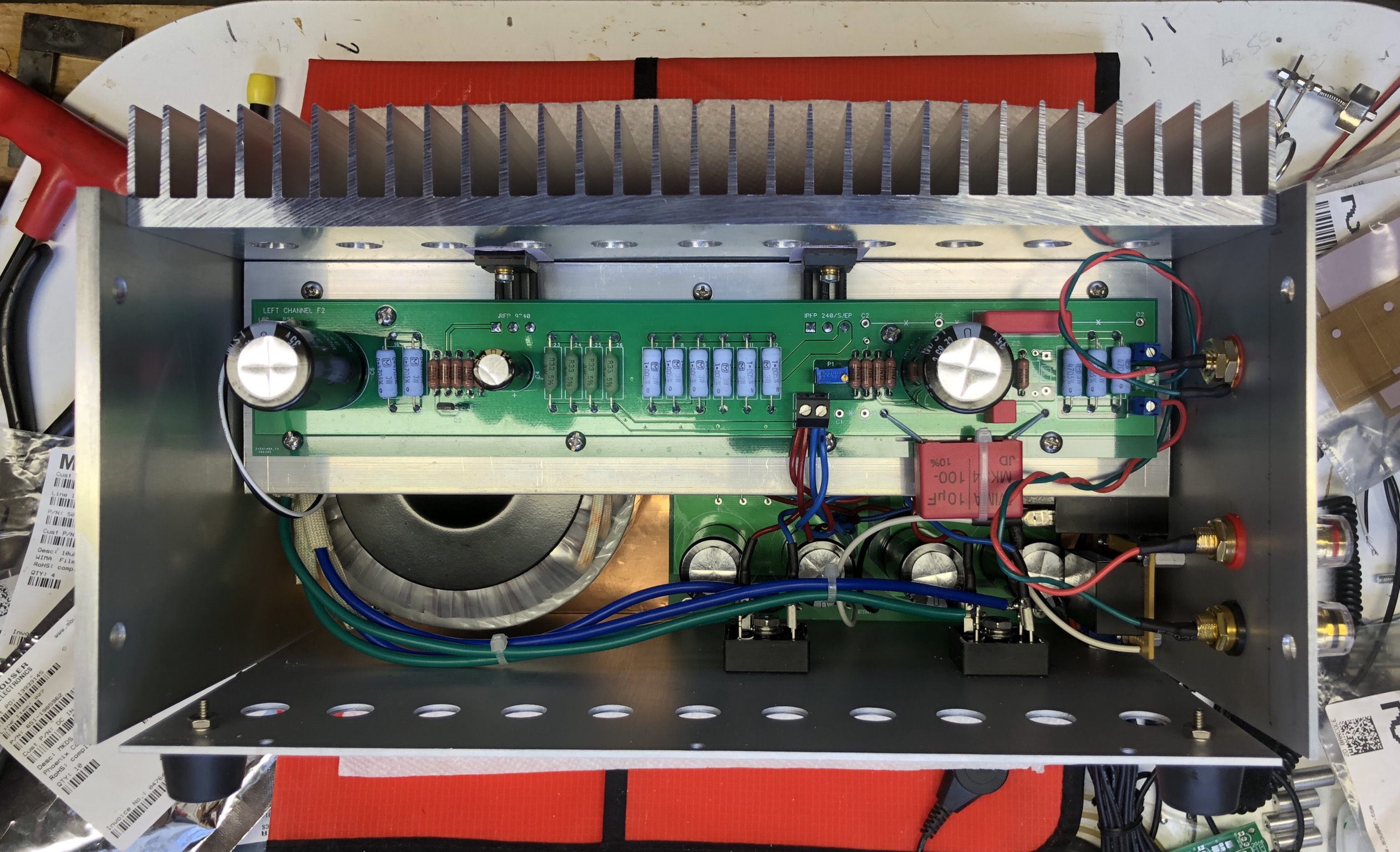

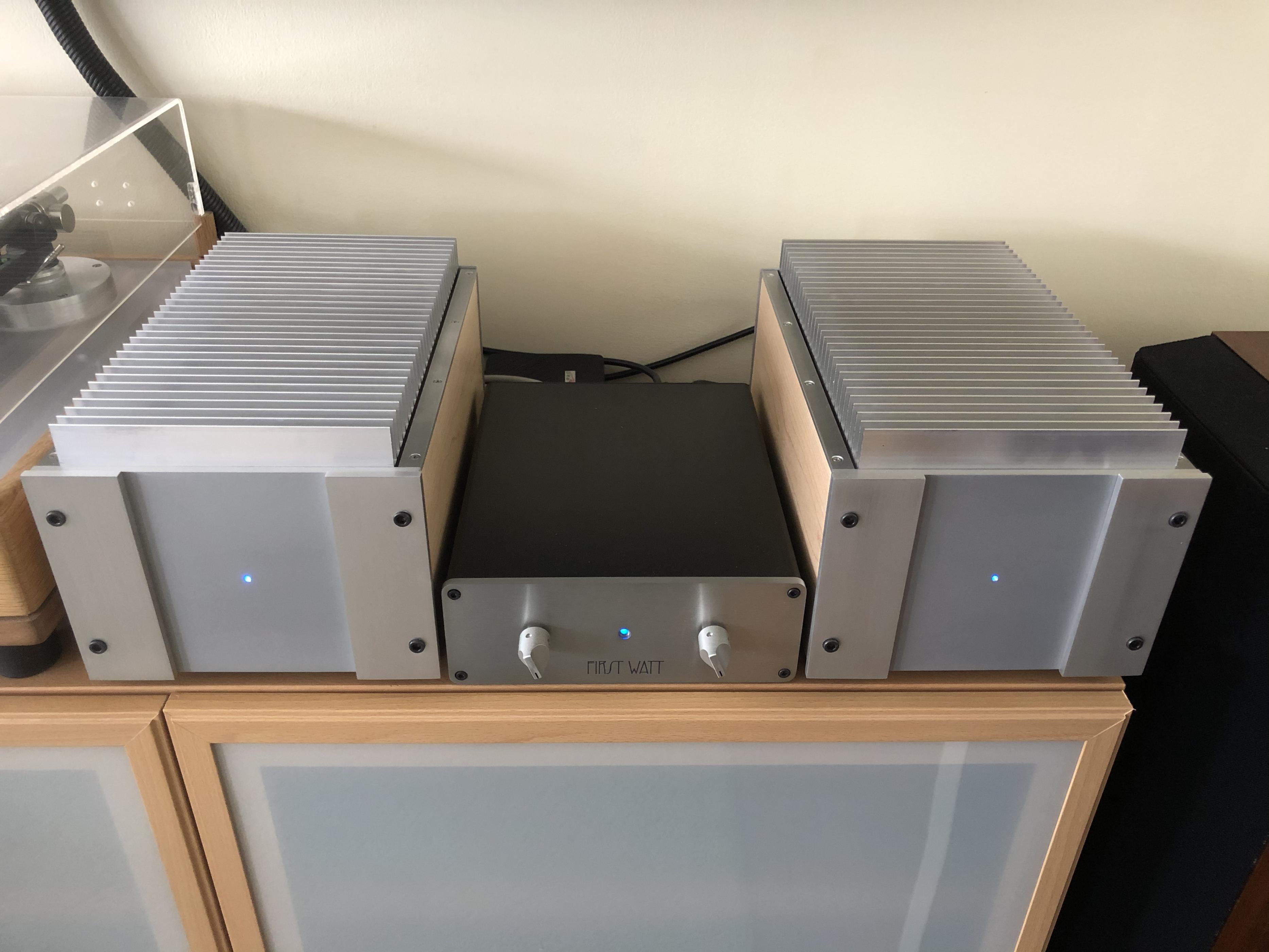

Kinku set me up with boards and some Semisouth a while back.
The boards are great.
My F2J monoblocks went together and fired up without a hitch.

Yes, I made the boards with a friend who designs microwave PCB for sophisticated applications. I wanted him to make another one but he is into AI now and left everything else.So as long as you are not positioning them to cut flux lines from a transformer it should stay very quiet. Ideally it should be mounted in such a way that underside shielded by heatsink surface.
Also I mentioned in the build thread, and in Firstwatt pages their distortion spectrum is similar to a tube amp. If you want to add some color to it ,bias them at higher voltage above the midpoint, like if it is 24VDCsupply, bias at 13V.
Their output power is low but it is made for high efficiency drivers. Those who are happy with such systems won’t look for another amp ( in Solid state amps)
