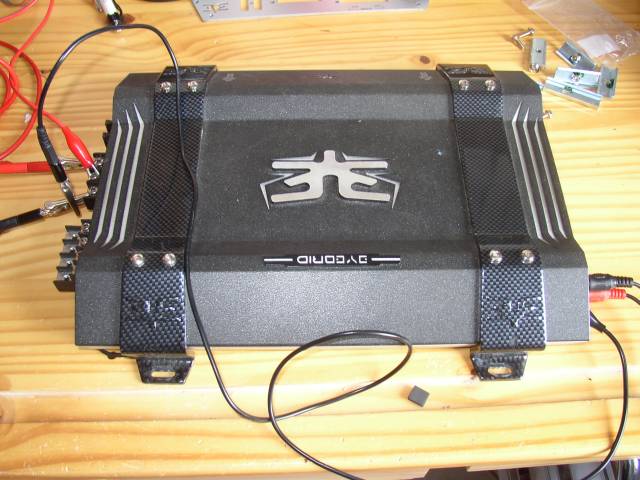

Hello, I have a problem with the eyebrid. sorry for my bad english, but it is very difficult to explain the mistake because I didn´t know all english words.
On all 4 channel the music ist bad. There are disturbance when the music is playing and the music is distorted. I found out the it is a mass error. On the platine there was a cable connected to the radiator box. The cable was connected with a screw to the radiator box. This cable was broken and I repair it. After that I put at the cinch connection a mass cable direct to the minus power connection of the amplifier. at that moment the music was great. No more distrubance. If you want, I can sent some picture what I have made. When I put away the cable from the cinch terminal the disturbance are back. The cable at the cinch terminal is NOT the cinchcable. It is an new mass cable so that the distrubance are away.
My question now: where comes this disturbance. I have check the cinchterminal and this is ok. There is no broken line or something like that.

Hello Netlist
Yes I have repaired that broken cabel. It was killed before. I don´t know why.
But the broken cable cannot be the error, I think.
Before I opened the amplifier, I get a dicription of the error. The guy said, that the amplifier was installed in the car and on all 4 channels he has got the disturbance. but the LED was lightning green.
when I connect it at home at my power supply, the LED shine not green. After I put the cable from the cinch termial to the mass the LED light green and the music play great.

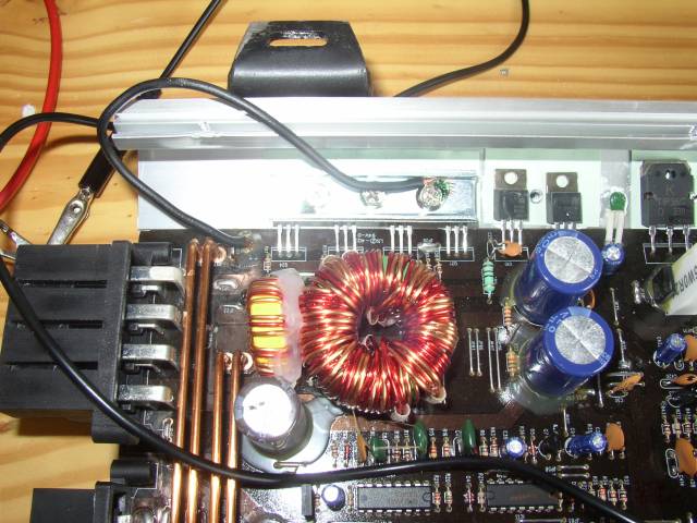

Here is a photo of the killed cable I repaired. I put it under the screw.

If the cable was broken, I suspect it was melted.
If it was melted, it is very well possible that a mass trace on the platine is broken/melted as well.
Mass=earth or ground in English and I think you mean print or PCB for platine.

The wire that's connected from the circuit board to the screw (that's used to clamp the FETs) is not needed for normal operation. It is used to shunt electrical impulses from the aluminum heatsink to earth/chassis ground.
If the amp works with the ground in place, look for open/burned traces and broken/defective solder connections on the circuit paths between the earth/ground terminal and the third lef of the FETs.
If there is a screw that connects the ground circuit path to the heatsink, it may be the reason operates properly with the wire in place. Remove the wire you replaced and check for continuity between the ground terminal of the amp and the third leg of the FETs (the FETs near the wire you replaced). If there is no continuity, find the open connection. The two long copper wires near the terminal blocks look like they connect the ground terminal to the FETs.
In the car it was likely bolted to the chassis of the vehicle which would have served to ground the heatsink and therefore allowed it to play.

Thanks for the schematic, I had a quick look and found on page 5 in the lower left corner the resistor/cap network connecting input ground to supply ground. (R77 // C14). You might want to check these parts as well.

Hello, the amplifier is still working. I have found the mistake. It was a narrow conductive strip. I send a photo from this defect. It was 5 cm away from the cinch terminal. So I solder a new conductive strip.
