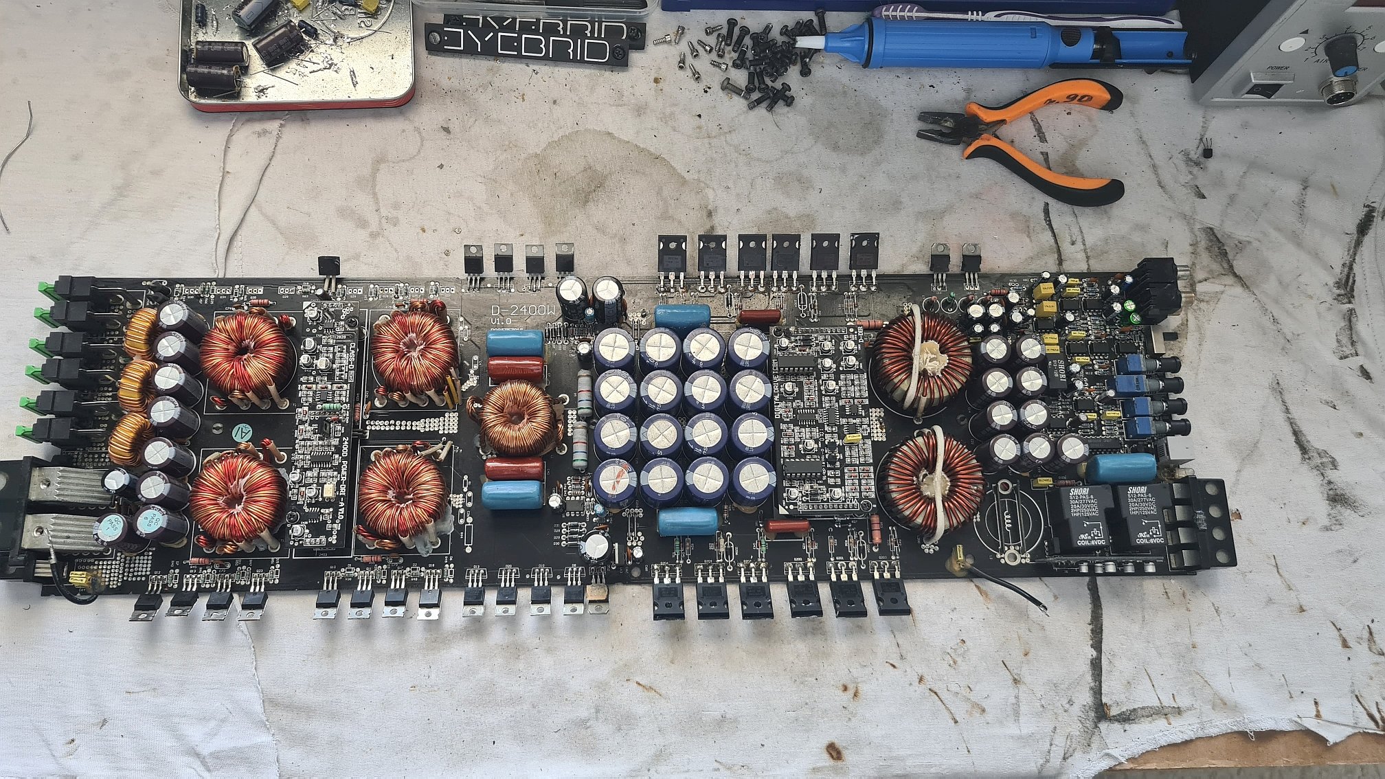

Repairing this amp over here: https://amp-performance.de/en/453-Eyebrid-1Y2000D.html
It has been butchered badly from previous repair attempts.
I'm missing Q4 and Q6....I found another thread here that says Q6 is J108, but not sure this is true.
ZD1 also have been swapped and messed around,
I've tried looking up everywhere online if there is high quality picture whereby i can read the transistor markings but with no avail.

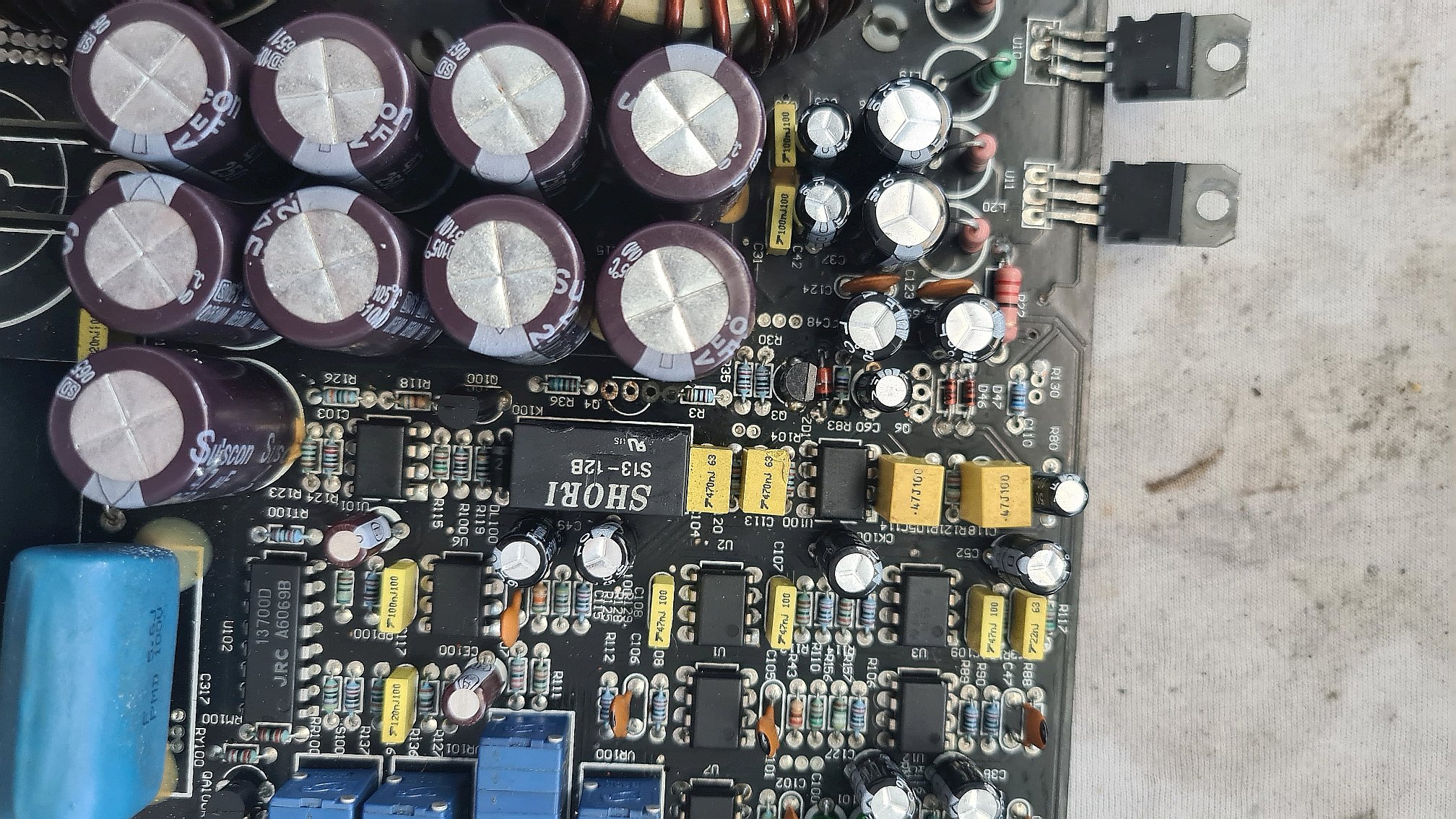

i am working on an Eyebrid 1Y2000D monoamp.there is missing one transistor.you can see it on the photo.it is Q6
the transistor Q3 is a MPSA56.
does anybody know what Q6 (in the red circle) is?
Q4 still a mistery. But for Q6.

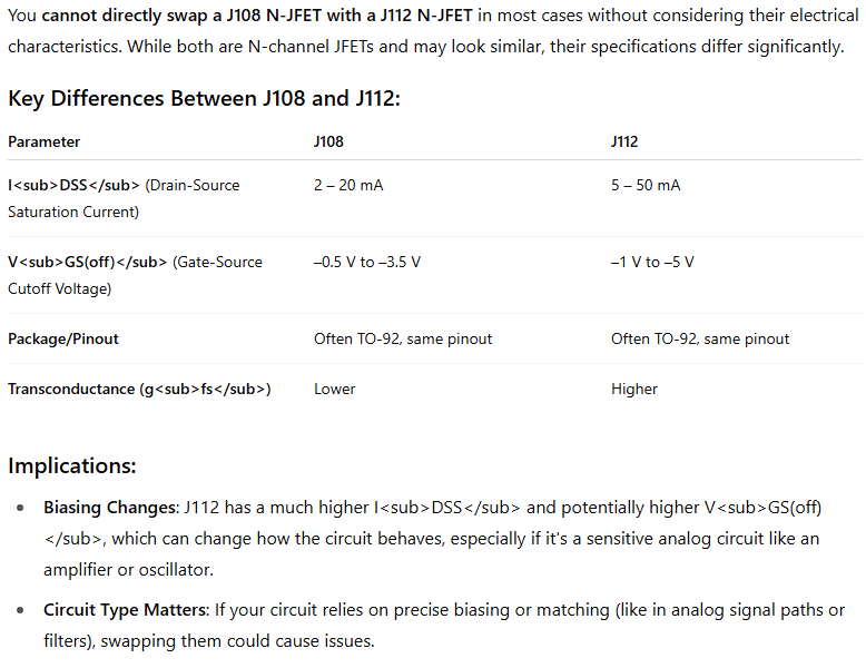

I don't have any J108 JFET this one seems to be obsolete, can I use the J112 ?
According to ChatGPT I cannot:

Is the J109 available?
Those JFETs are typically used for muting and if used in that way won't be critical to be in the circuit for general troubleshooting.

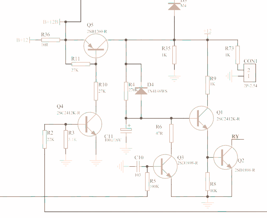

The polarity (from the voltages you posted) looks wrong for a PNP with the pin configuration of that transistor.
Q4 voltages are referenced to GND:
So this is not correct below
pin 1 = 0 connects to GND thru 10k resistor = Emitter of PNP
pin 2 = 0.45v connects thru 10k resistors to base on the 2SD669 = Base of PNP
pin 3 = 12.3v from Q3 = Collector of PNP
Should be a NPN like MPSA42 ?

I know you said the diagram I posted wasn't close but is there possibly a transistor that corresponds to Q3? That transistor would be used to prevent the relays from engaging. It would be used for protection or for the initial mute delay.

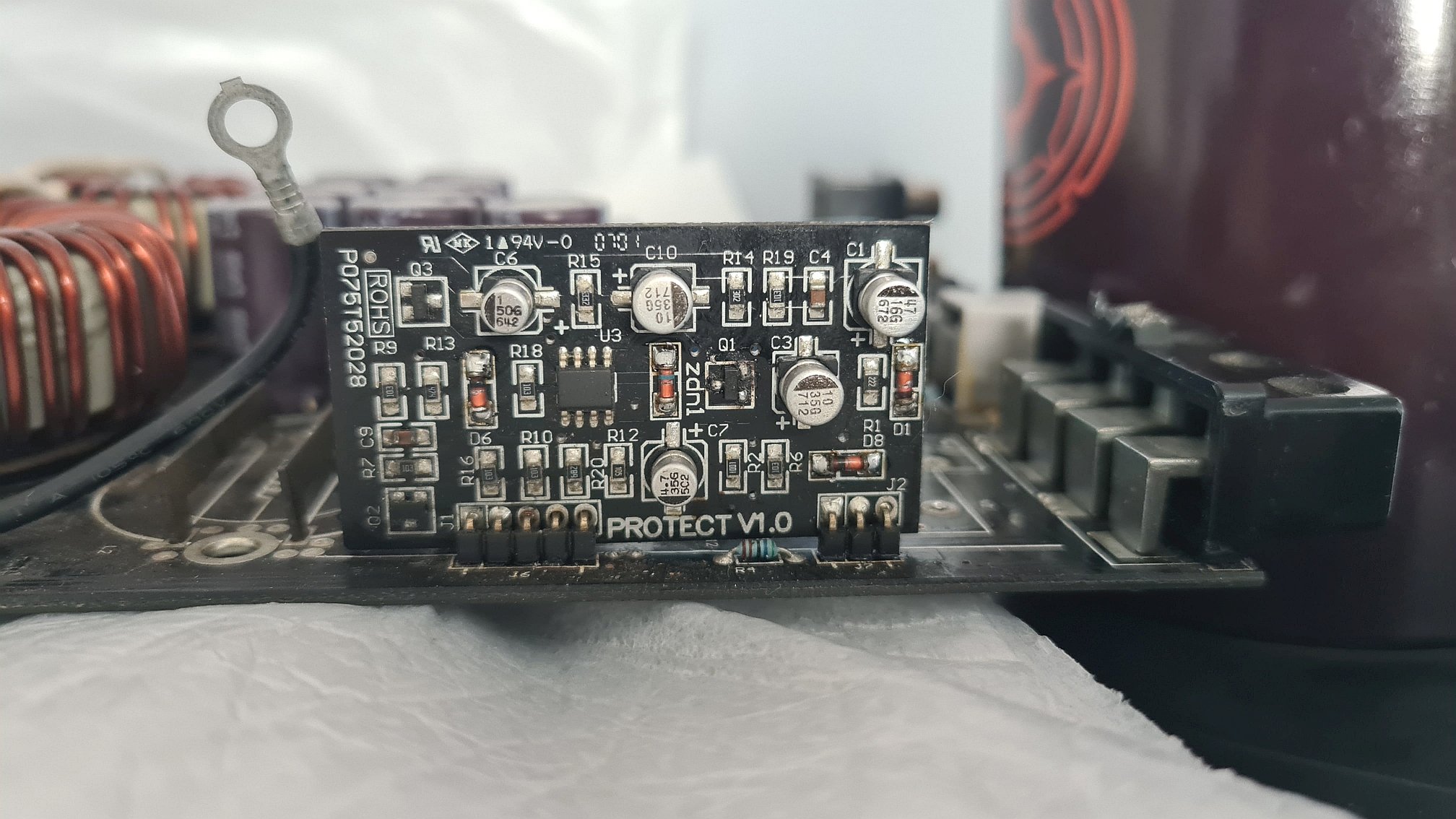

This is my line of thinking too. As this 2SD669 connects to various parts of the amplifier I've checked the PS driver board, the Protect board and also the part whereby we have had the missing transistors Q4 and Q6=J108 (which we swapped to J109 as J108 is obsolete) but nothing else is shorted, burned, open or give me any odd readings.
The amp does not go into protect, there is green light, produces output, etc, so it's just the part with the relay engagement. Even if it's a leaking transistor without a schematic I would not know where " corresponds to Q3? " would be located.
I may re-check the Protect board once again as Q1 being there shorted it may have cause some other damage too, but i cannot see anything wrong or odd at the DMM,
EDIT: It's not the Protect Board, I fitted brand new transistors over there and check the resistors if they are in tolerance....same. No shorted or open diodes.
