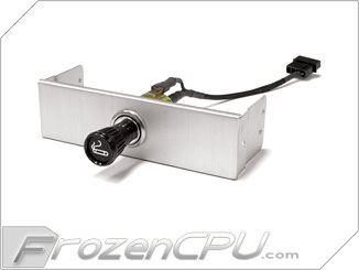

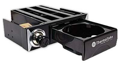

If you put an external 12V power socket on your PC near the audio output, it'll be quite easy to use.... And using the computer's 12v? You mean directly from the PSU? That sounds crazy and unconvenient. ...
Or just get a cigarette lighter for your computer. That way you don't have to vandalize your PC or void it's warranty, and you can use the same power cord at home or in the car.
Googling "cigarette lighter drive bay" found these (and lots more):
Cigarette Lighter Panel w/Cup Holder for 5.25-Inch Drive Bay
PC 12V Cigarette Lighter Adapter Lian Li 5.25" Drive Bay - Silver - FrozenCPU.com
Cigarette Lighter / Beverage Holder Drive Bay - SlipperyBrick.com
See pics below for an idea of what's available. I like the ones with a drinks holder in the side.😀
Cheers - Godfrey
