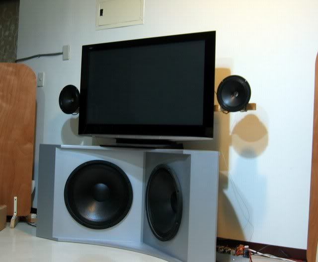

The system I'm playing consists of a pair of 8" paper cone fullrangers and a very simple chip amp kit with STA540SA. I put them together and applied EQ by DEQ2496 temporarily. I used 2 shelving filters. The overall shelving spreads across 80Hz to 1.5kHz with 6db/oct slope (so, almost 30dB difference between the LF plateau and the HF depression).
With no baffle, the 8" cones struggle to make any bass. Within very short distance and on axis, I did get an acceptible tonal balance. However the available SPL was way too small. During passages with low bass energy, the available SPL was only more or less at normal conversation level. "Clipping noise" appears when louder than that. I'm not sure it's the amp or speaker, yet.
Adding a steep HP filter at 40Hz improved the SPL ability somewhat, but still not enough. More experiements to come....

The EQ is not finished yet. The picture shows the temporary installation.
The baffle-less drivers diliver a clear sound I expected, much better than the speakers in the TV set. When watching TV in the late night, I can hear the sounds clearly at a lower volume.
The EQ circuit needs more work, though....
