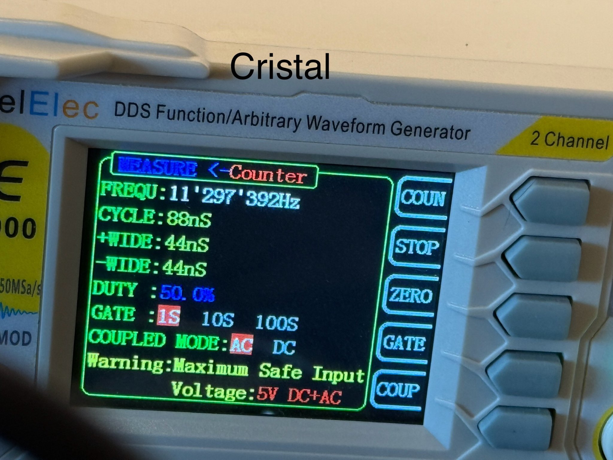

- Followed the provided instructions from Guido from Tentalabs, installed the module and no audible difference.
- Then I decided to measure the clock frequency on the digital section.
- On the input XTi pin 8 of DIR1703 I have 11.289.583hz coming in from the XO clock module.
- But on the output pin 4 of DIR1703 - SCKO - that sends the clock frequency to DF1706, etc all the way to the DAC chips - I get a deviation. I measure 11.297.397hz ( a 7.814hz difference !!!) all the way up to the DACs.
- What I observed is that when the CD is NOT playing ( just idle) I get an accurate clock reading - 11.289.583hz - on the whole digital section up to the DAC chips. This means the input clock frequency is equal to the output clock frequency on DIR1703.
- When the CD starts playing the clock frequency that comes out of pin4 of DIR1703 changes up to 11.297.397hz . And this clock frequency goes all the way up to the DAC chips.
- If I hit the STOP button, frequency moves back to 11.289.583hz on the whole circuit.

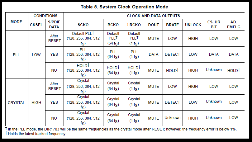

The DIR1703 is doing what it is supposed to do. When there is audio data MCLK is derived from the incoming data. When there is no audio data the attached clock is used to provide something for the downstream equipment to lock to prevent noise. Bit and serial clocks are provided but the data output is muted.
The DOUT column says it all. The only time data isn't mute is when the SPDIF signal is present at the input in PLL mode.
