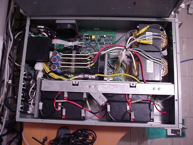

ill post a pic of mine so you can see it could handle it. wires and all

heres one lets have a boo inside

karma said:
hopefully it a older ups. the new ones with smart charging go all
stupid when you mess with the batterys. thay read under charged
or over charged or turn off when the bettery is good and full:xeye:
one ups that would work is a old rack mount u can put a big honkin battery on that. i am soon
you can put bigger batterys on the small ones but there not made
to run that long. and likelly will die when you need it most😉

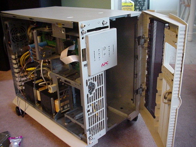

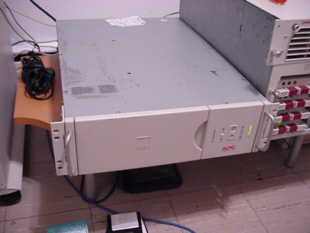

Thats the same one Im going to use for my 5 channel gainclone 🙂.
Although it looks like yours is the 1200VA version, or maybe more! Mine is only 700VA (times two transformers).

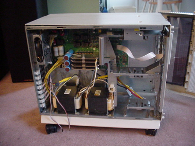

Here is a picture of the top, with transformers in the battery comparments: Top
Front of case
In having experience with these large transformers, you have to be carful that the surge, the current taken to initially saturate such a huge core, can sometimes cause a breaker to trip. Adding a SMALL resistor in series with the primary coil may help this problem somewhat. or maybe a power factor correction AC cap. You can find these on things like ceiling fans and appliances with AC induction motors in them.

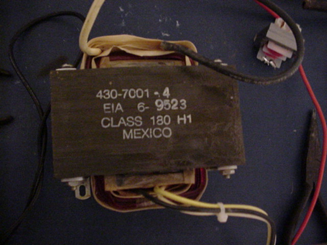

i started my mod i used a old server case that would hold the
huge gell cell battery i tested under load with a full charge
5 hours:bigeyes: and some. and that with one cell. used for boats😀 . it has wheals so i can move it .better than when it was a rackmount. just need to finish cooling fans 😉
