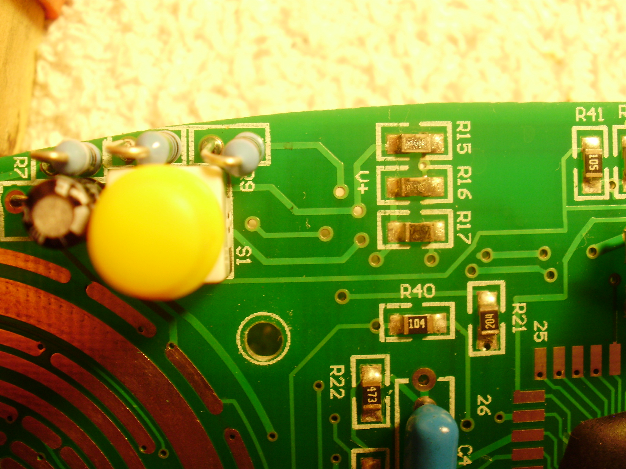

Just looked at it again, thru magnification,,, seems there are 3 of those little square resistors open on a V+ trace,,, don't know the values tho.. I checked the two transistors, they seem OK...

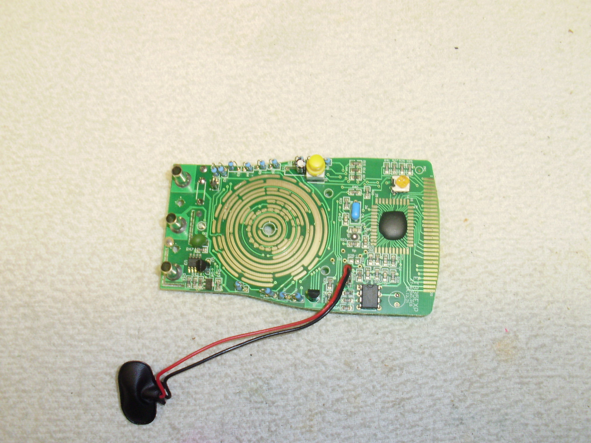

Post some clear focused pictures of the entire pcb and then a close of the R15-17 area. We can probably deduce what the resistor values are since most of the manual range meters have similar network resistor divider values.

Here ya go,,, The 3 resistors are along the top edge of the pic, arranged vertically about 1/2" to the right of the yellow hold button, and 1/2' above the blue cap...R15 is next to the edge,,, these resistors look burned, the numbers are no longer legible...
I'm assuming they are open, the meter I checked them with has a 2M max ohm scale...

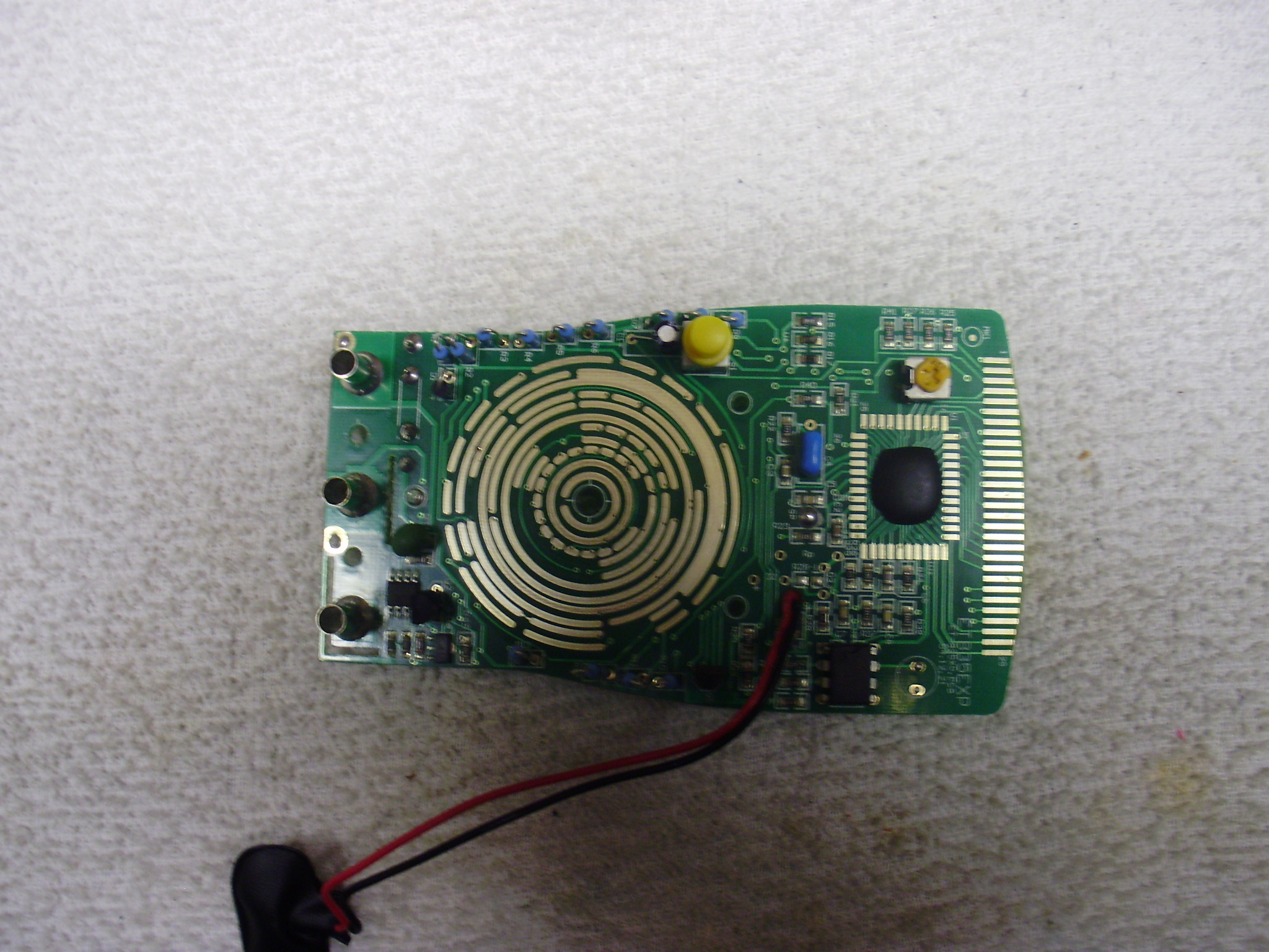

The pictures are too blurry and not enough resolution (zoomed out too far).
Take the PCB outside or next to a sunny window ledge. Put your camera on macro mode and take more pictures. Please also take a close up of R15, R16 and R17. Maybe try to clean the surface of these 3 resistors with some isopropyl alcohol to make it more readable.
Try these,,, best I could do under a floodlight, getting dark here...
Thanks for helping...

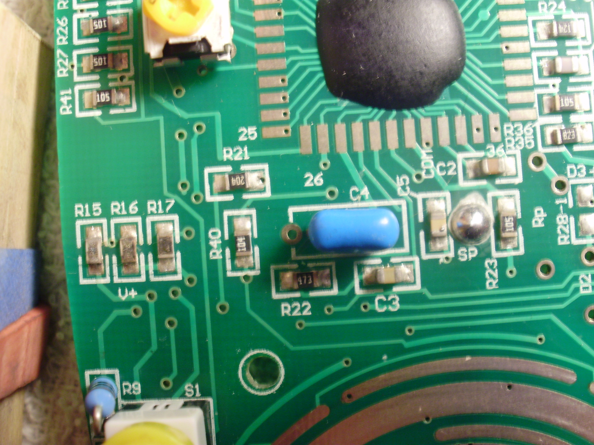

Regarding the R15 connection, aren't all three in series, with vias in between? Looks to me like the top of R15 is connected to the top of R16.
Thanks for replying,,,
I can see the trace between R16 and R17... and the pic looks like there may be a trace between R15 and 16, thru the hole, now that you pointed it out... However, there isn't a pad under the top of R15, but I can easily jump it to the top of R16 with wire... Would they have used three 470k in series?
The only concern I have is the value of the resistors,,, didn't want to try too many different ones, as I don't think the PCB will survive much more soldering!
Since the top of R15 was obviously soldered in the photo, maybe you lifted the pad in the de-soldering process?
It is fairly common in DMMs to find several resistors used in series instead of a single resistor. It's an effective way of increasing the voltage rating and power dissipation capability. These got smoked, so they could be part of the voltage divider, or low-range current shunts, who knows. I can't really tell without having the thing in front of me to laboriously trace out where the connections go, sorry.
The pictures I find of the MN35 suggest that its underlying design will be very very similar to 830-style meters like the Hazard Fraught DMM. But it looks like a bit more effort went into this PCB (I even see some isolation cut-outs), so I would not expect the layout to be similar. The fact that the 470K resistors were in a corresponding location doesn't mean all that much. I suppose that for experiment's sake, 470K is about as good as the 10K earlier suggested, just to see if functionality changes/improves with something in there. Yep, pictures inside a working unit or schematics sure would help!

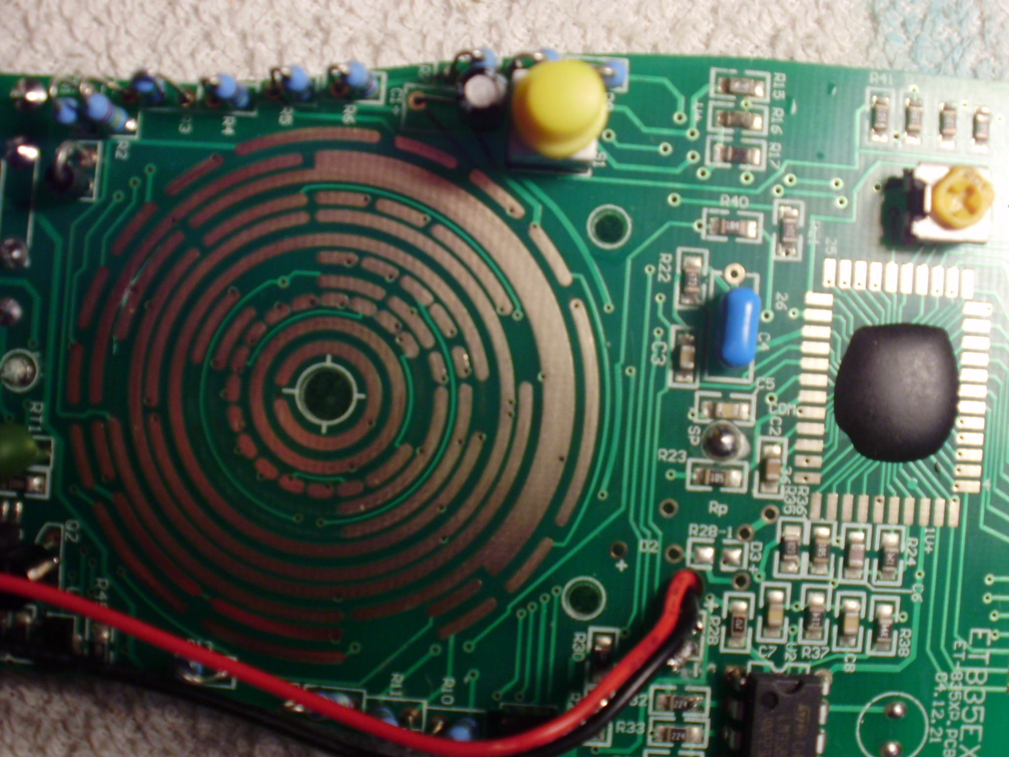

PS. With regards to tracing out what R15, R16 and R17 do, take the pcb and shine a very bright light behind it. Alternatively, put the pcb facing the sun and take a picture of it like how I did. The transparency photo might help you trace out the layout.
