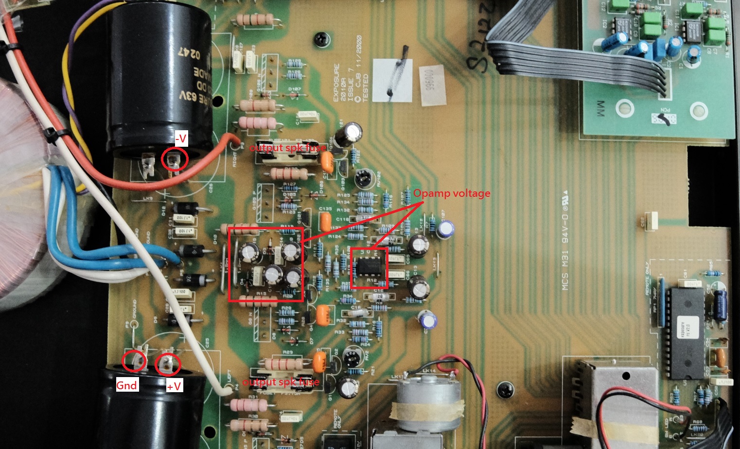

I just went to check voltage levels on board. Before plugging in I checked fuses and reinserted them. Plugged in and leds are working. Before I only checked 3.15a power fuses and changed them, now I also checked 315ma fuse, didn't change it tho'. My guess is there was a contact problem on 315ma fuse.
Now how should I test it before connecting speakers?
I forgot to mention in previous post, remote started to work as well. I tried to check speaker output connectors voltage, in AC mode of voltmeter, left channel showed 7.6V Ac and right channel showed 6.8V Ac, no input connected btw. These values didn't change with me increasing volume knob. I decided to check if it works with my old speaker and everything seems working fine now.
While everything opened up I checked some voltage levels for future reference. I'll use patrick101s drawing and opamp pinout to refer pins I'm measuring. I am writing on the phone sorry for any mistake, and I'll try to write it down as table. On table Ref means where I put my black cable of voltmeter, target means red cable.
Do you see anything wrong here?

You can check output safely with a speaker by putting a non-polar capacitor in series. Say a 1000 uf 50 vnp, or two 2200 50 v capacitors series minus to minus. This would protect your speaker from DC out, at the cost of sounding a little funny. Bass will be missing. Low wattage (1 vac) with series polar capacitors just sounds funny, perhaps due to chemical events. DC voltage on speaker is very bad for them, make sure the amp is not doing that before taking the cap out. 200 mv max on speaker.
The "opamp V-" of 29.2 v sounds extremely wrong. Why are there two readings next to the name? One channel A one channel B?
Also "opamp out" of -14 to -13 sound extremely wrong. Your meter ground was on the speaker ground wasn't it. Or on the common terminal of the two rail caps? (the big ones). opamp out pins 7 & 1 should read on DC scale about zero, the same as the + and - inputs. If the power pins DC voltages are centered around the speaker ground.
There are a dozen caps around the op amps, "cap gnd" doesn't mean a lot to me. There should be one + one and one - one but which are connected to the power pins of the op amp is undetermined.
We all have the pinout of the ne5532, no need to reproduce it. Datasheet available on datasheetcatalog.com

If you found the speaker fuses blown, it is worth checking power off the output transistors with diode scale or 2000 ohms scale. B-E B-C either .450-.700 v (ohms) plus or minus depending on polarity. These are the transistors on the heat sink, and base is the one on the left with the writing facing you & up. Blown OT's is a very common fault. Zero is very bad news. Emitter resistors often blow with them.

Right now amplifier seems to work fine with my Monitor Audio Rx1. I had 1.6a fuse instead of 3.15a fuse so I used them but I will change them asap with 3.15a. In the end I only changed fuses so I assume nothing wrong with the board. If a fuse would blown soon I would check transistors as well. Thank you indianajo and patrick101 for your help.
@indianajo I guess I didn't explain it clear. When I write [Opamp V- , Opamp V+ , 29.2V] it means I measure the voltage between V- pin and V+ pin. There is two big Capacitors I assumed negative side of these would be connected to ground. As far as I understand board ground is 0V, opamp Vcc- is -14V, opamp Vcc+ is +14V.

You can just check the amp output DC voltages, if the voltages are small and the amp case(part of heatsink) temperature is not so high when idling, then your amp should all ok.
If your output is below 200 mv dc, probably nothing else is wrong. 3 a fuses will be inaudibly different than 3.15 amp fuses which you won't find. The ear is logrithmic, look at the decibel scale.I'm trying to get capacitors from reputable sources as well. However we don't have farnell or mauser here unfortunately. Most seller do sell cheap chinese caps. It's hard to find panasonic caps for me. Ordering from abroad is not favorable because of the shipping fees and customs process.
