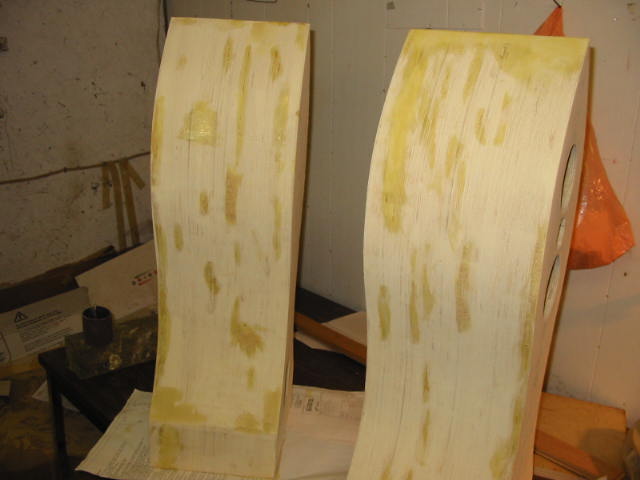

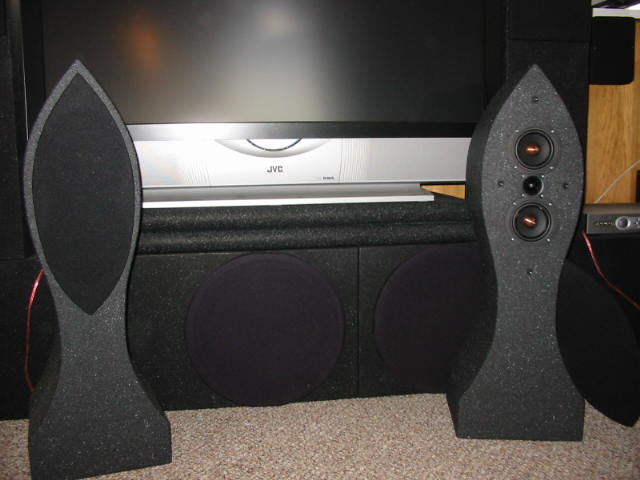

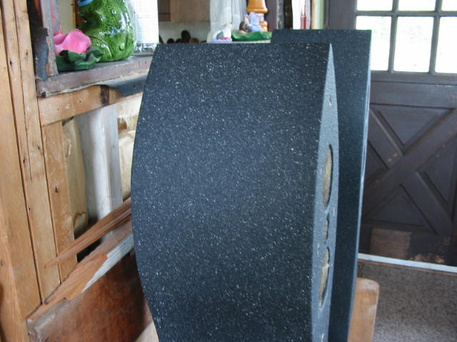

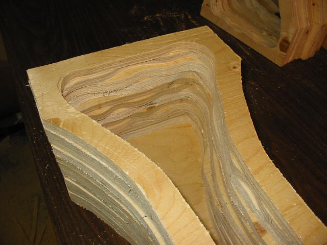

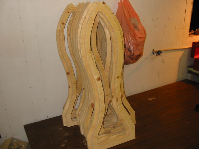

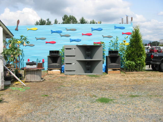

Yes many have made them including moi. I too used the front to back laminates rather than stacking them and the purpose was for the funky shape. I cut them wavy on the inside thinking that would help with standing waves. Turns out to be incorrect
The inside leftovers I repurposed by cutting them into fish shapes and mounting them on a cruddy old wall in back that I painted first.

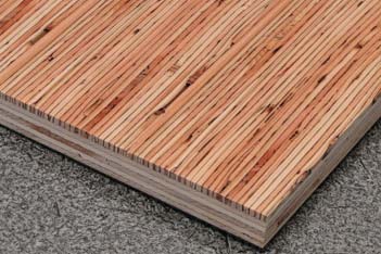

The easiest way to get the exposed ply look is to simply buy it, as pictured.
Your access to this site has been limited
If the link doesn't work (they are rebuilding the website), look for "MAXI EDGE PLYWOOD PANELS"
The cheapest and least wasteful way to get the exposed ply look is to DIY it from a bunch of scraps and offcuts. I did exactly this for round-overs on a current build, see post 61:

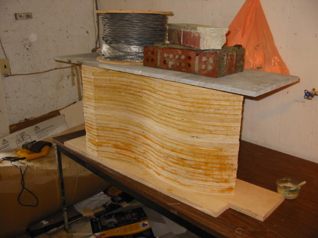

I made a translam cab a while ago. If I was to do another I'd make the 1st layer to size and cut all the rest 1mm bigger all round. Then each layer can be glued and flush trimmed with a router. This would have saved me an awful lot of sanding / finishing.
Rob.
Rob.
I wasn't talking about excess from assembly, but the -1 layers of the plywood(12 in 13 layer,etc). Squeezeout is a doddle.
And Rob's method above pretty well takes care of any size mismatches. Again, I see no reason to have to resort to excessive sanding with a well thought out build plan.

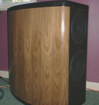

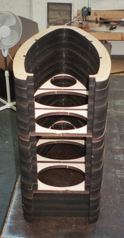

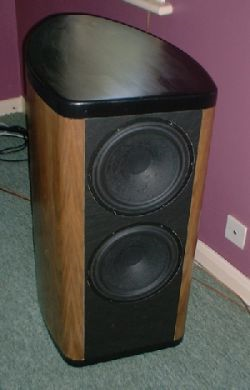

I did vertical braces in mine by cutting slots into the inner sides and then sliding the braces in once glued.
Dug up some old pics I can't believe it was 16 years ago! Finish was walnut veneer. You can see the slots in the 1st pic I hadn't put the braces in yet.
Rob.
Rob.
