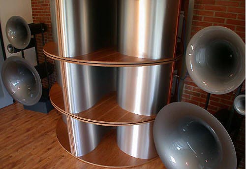

Take a look at this image. I think you are on to a clever design but suspect that it is the same that goes on inside this commercial offering from AvanteGarde. In this case they take what you have (apparently) and at the mouth they form an opposite roll to produce a good diffraction free mouth opening which is what I was about to suggest to you as well for your design.
