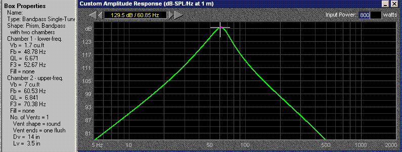

The people who told you that the horns are too short are right, what you end up with is closer to a bandpass enclosure than a horn, that doesn't stop it producing bass, but it does stop the acoustic gain that you would get from a properly sized horn.
If you want spl and have the space build a big bandpass enclosure, I took the liberty of modeling you an example; (see attachment)
I could use hornresp and model that design but I can gurantee it won't match this bandpass design for pure spl.
[edit] don't forget to add ~15db to that model to account for cabin gain:smash:

WHats killing me is that this enclosure does killer bass for my ten inchers. I have 2 infinity 10s that just pound, hitting over 126 db with 230w a piece. I just don't know how to scale it or even model it.
I am gonna try hornresp.
