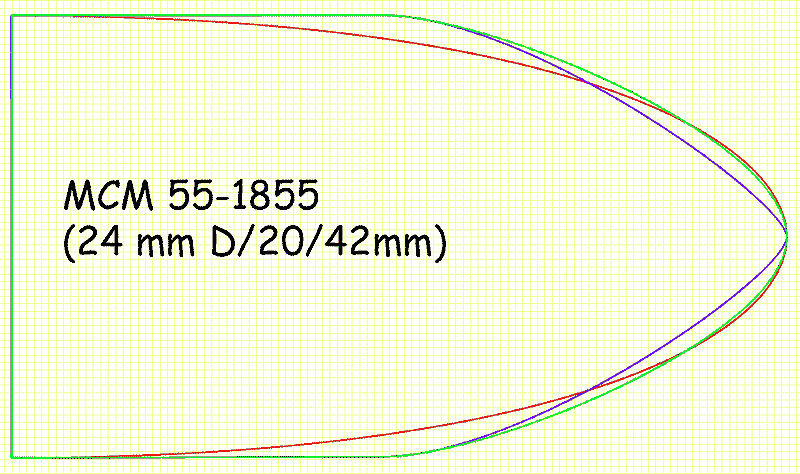

PS--where can I learn how to make a plug for the MCM 15-1855?

kneadle said:PS--where can I learn how to make a plug for the MCM 15-1855?
Here is a drawing i did for 1855 phase plugs (made from anything you can put in a lathe). The green or blue lines are the ones to follow, the red was for reference. The grid is a 1/2 mm i believe.
If you imbed a steel washer in the base it will stick to the pole piece for temporary attachment.
I haven't actually built these yet.
