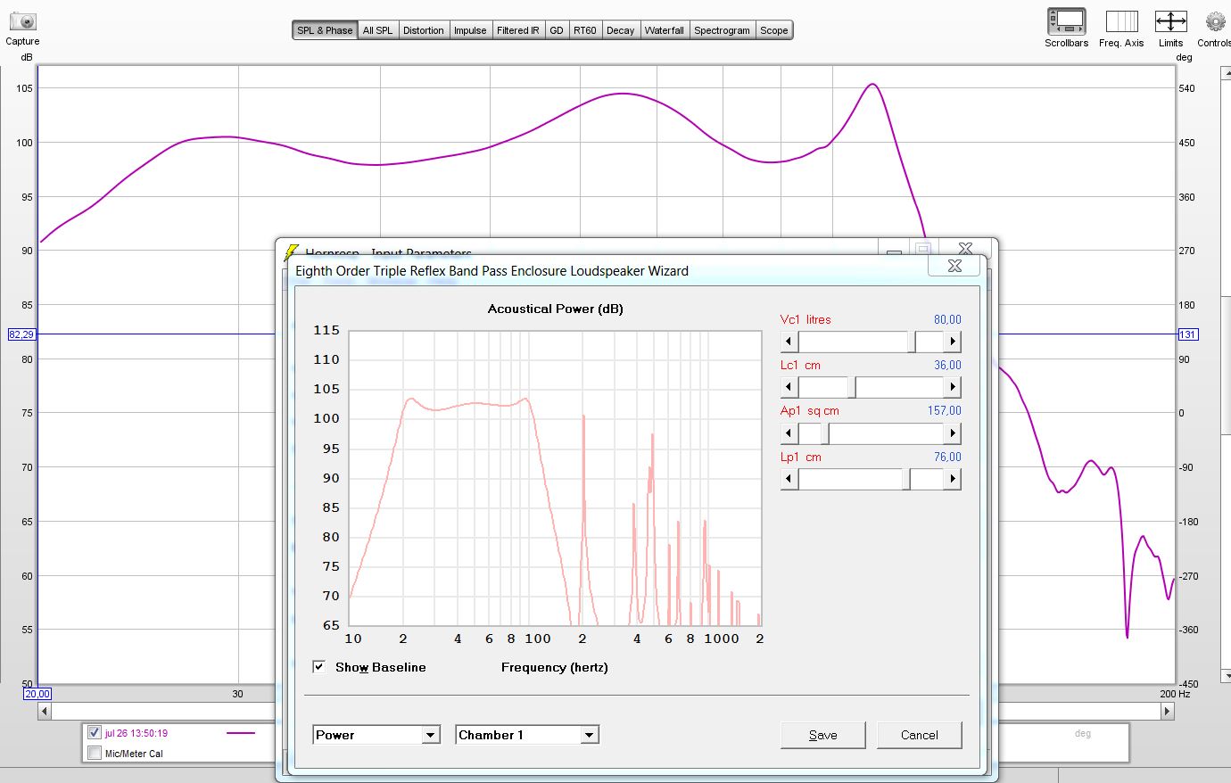

I think such a design is only good for very narrow band
An adventure with 8th order BP
It is not easy to get good punch and attack from a normal Helmholtz based 8th order BP, but they can be quite wide band and have a great efficiency.
I prefer the sound quality of a quarter wave based 8th order BP over the port-infected Helmholtz version.
