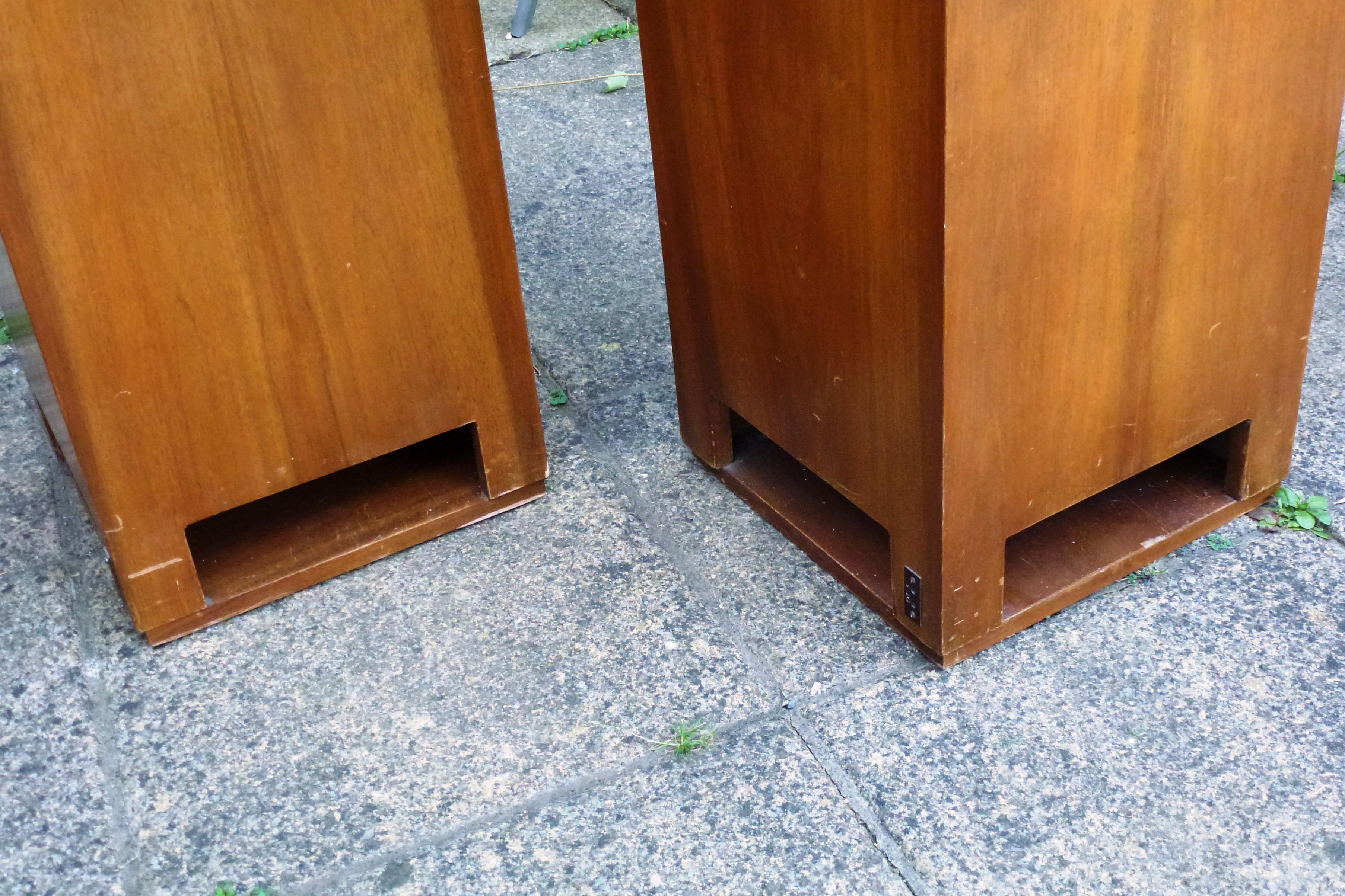

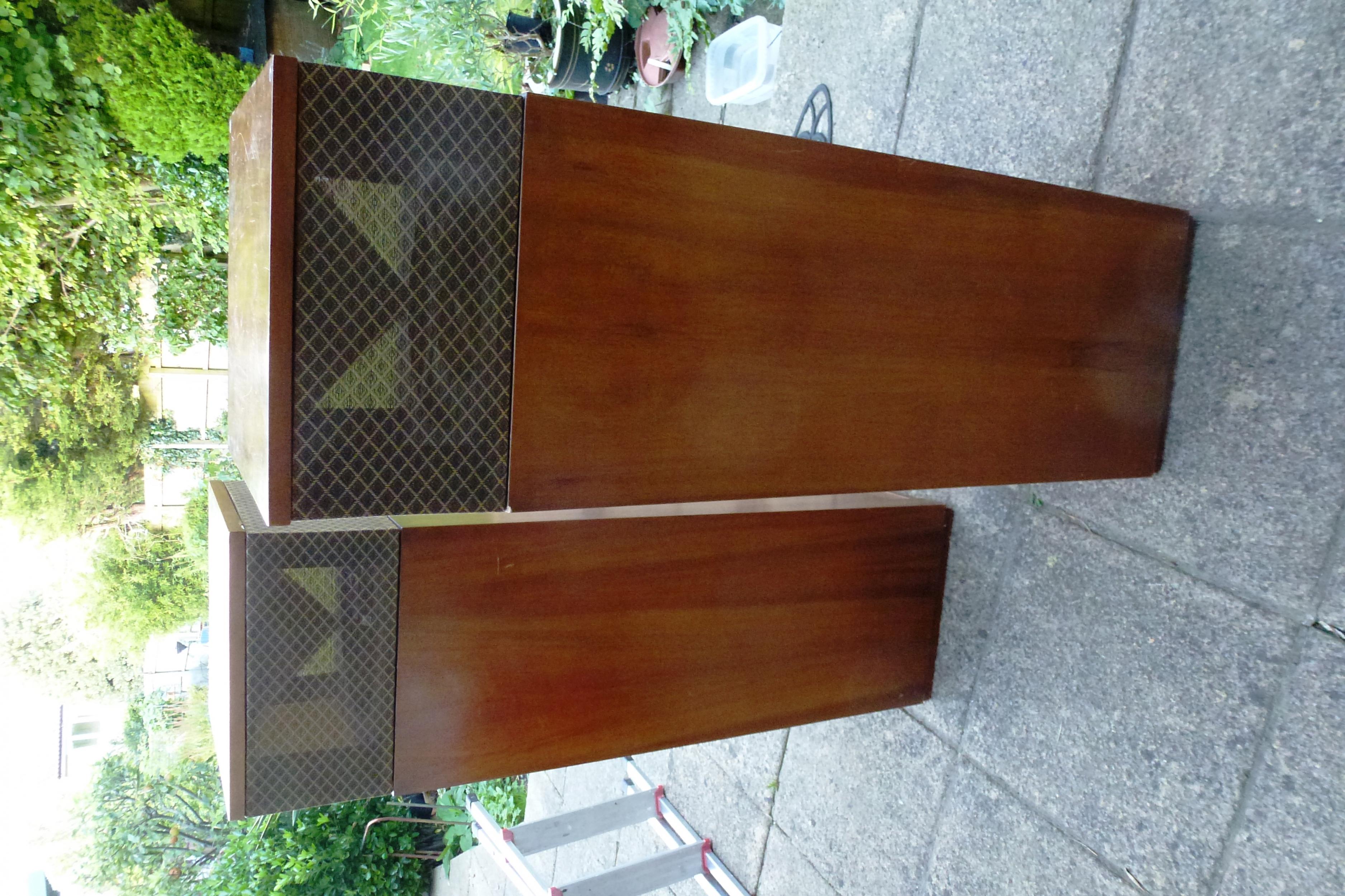

This is a rare pair of Expert Acoustic Column (formerly EMG) cabs, c. 1960, I am restoring. Originally fitted with Baker Selhurst 12" + Lorenz cone tweeter filtered by a 2 uF cap.
I am very hazy about modern drivers and I am seeking advice on what to buy. Currently I have fitted Kef B200s and cheap Peerless tweeters + a simple 1st order x-over to try them out - very nice too!
I assume the cab with its two vents at the bottom was optimized for 12" drivers, so I am looking for something with a low rf and reasonably good MF performance. As for a tweeter - something that sounds like the old Celestion HF 1300 would be nice - physically small as it will be mounted over the 12" driver. Suggestions very welcome.

If you want to keep the cabinet ported as is, an overall cabinet volume and tuning frequency might help people suggest a suitable driver.
