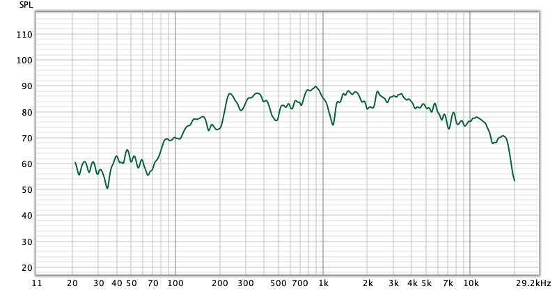

Baseline Test: Full Volume
No internal Wall, internal Volume of 600" cubed

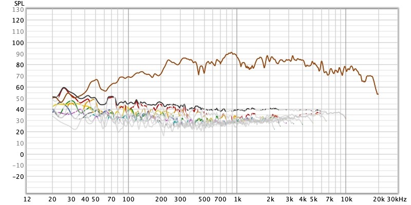

Frequency Response
The frequency response of the driver in the box with full volume doesn't look great. There are two large peaks in the 900-2khz region that can cause sounds to be shrill.

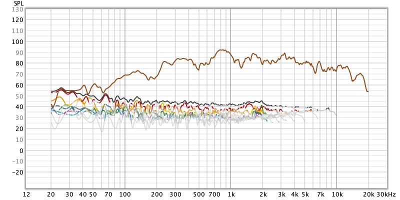

Distortion
Since this is a planar driver, distortion values were quite low. In the usable range from 300hz to 6khz, the THD is below 1% at its highest and there is no audible distortion past 500hz

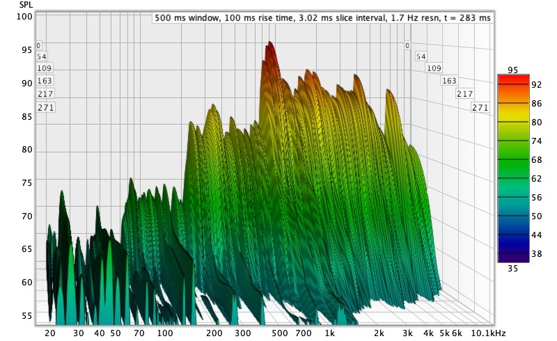

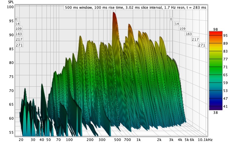

Waterfall Plot
Also as expected of a planar driver, the decay time is very fast. No real issues with stored energy here. We do once again get to see the large volume peaks at 900hz and 2khz.
3/4 Volume
The box now has an internal volume of 450" cubed.

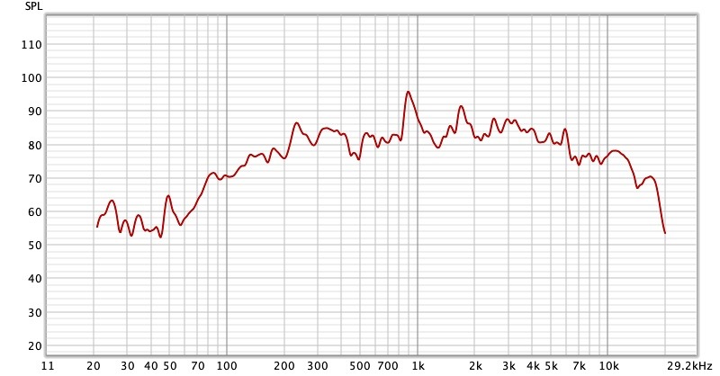

Frequency Response
Compared to the previous enclosure with full volume, this has a slightly more linear response.
Distortion
The total harmonic distortion appears to be lower than the full volume by 0.3% on average across the useful range from 300hz to 6khz.

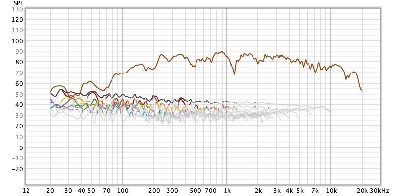

1/2 Volume
The box now has an internal volume of 300" cubed.

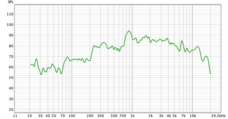

Frequency Response
Reducing the enclosure size seems to once again have smoothed out the response very slightly. Some of the dips around 1.4khz have filled in and some of the smaller peaks above 3khz have been reduced.
Distortion
The total harmonic distortion does not seem to have any significant differences compared to the 75% volume measurement.

1/4 Volume
The box now has an internal volume of 150" cubed.

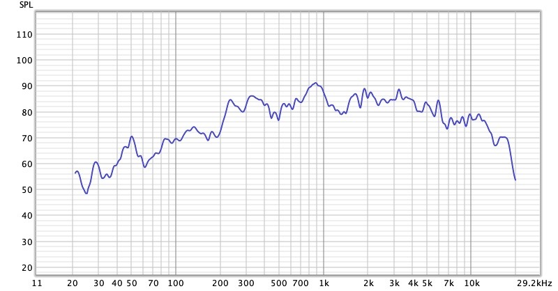

Frequency Response
Compared to the box with half volume, the quarter volume box seems to have a few deeper dips and higher peaks.
Distortion
The total harmonic distortion has increased by about 1% across the usable frequency range from 300hz to 6khz compared to the box with 1/2 Volume.

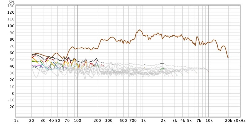

Minimum Volume
The divider board was pushed as close to the back of the driver as possible. Not sure exactly what the volume is, but there is barely any space behind the driver.
Frequency Response
The response for the minimum volume is quite interesting. It appears that across the usable spectrum the response is the flattest out of all of the previous measurements. However, there is a steep rise in SPL at around 800hz. One could speculate that due to the small width of the baffle, the increased volume after 800hz is a result of baffle gain. IT could also be a result of other causes.
Distortion
While the response of the box and driver has become more linear, the total harmonic distortion has increased in a few areas. The total harmonic distortion increased significantly between 300hz to 700hz giving an average of 3%, while the remainder of the frequency range kept a fairly low average of 0.3% THD. These problem areas may be a result of having a hard surface parallel to the driver and also being so close to the driver. the back wave of the driver may be bouncing back and affecting the sound produced by the front of the driver. if you have other theories on why this may be the case, feel free to let me know.

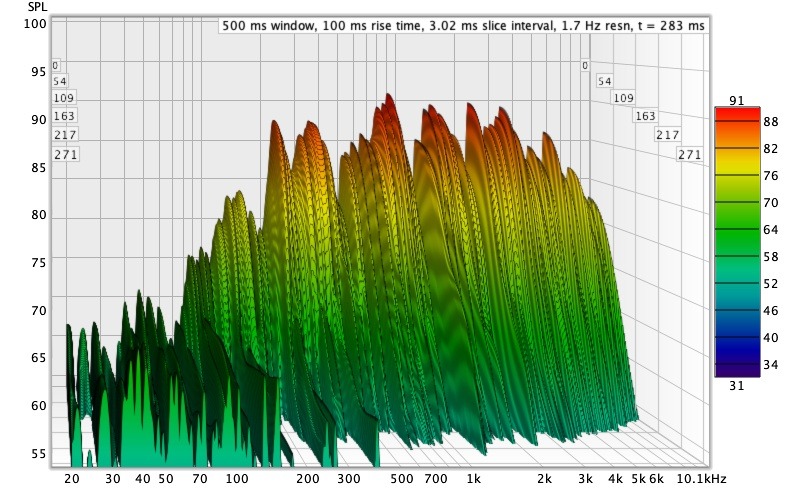

Waterfall Plot
Still no appreciable differences.
Conclusions
The smoothest frequency response across the entire frequency range was produced by the box with of 300" cubed volume. The best distortion characteristics were also exhibited by the 1/2 Volume box. However, in the upper frequencies beyond 800hz the minimum volume box performed best. The box with minimum volume had some strange interactions and produced both the highest distortion values and lowest distortion values, perhaps other methods of damping the box may help to solve those issues and make it a viable option. In terms of the waterfall plots or stored energy, in each scenario, the drivers seem to have no issues staying fast, and dissipating energy instead of ringing.
