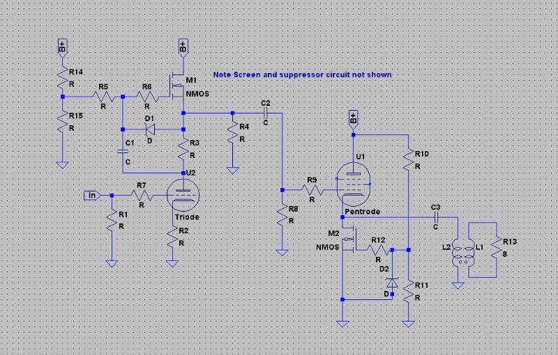

I drew a quick sketch of what I have in mind. The use of the Mu-Stage is for linearity more than for the gain advantage. The same applies for the output stage. If Zout is improved by the CCS this is fabulous but my main goal was maximum linearity without interstage feedback. The use of MOSFETs is a practical consideration. The sand is not providing any signal amplification but it should provide high performance CCSs at minimal cost, maximum reliability, and minimum bulk. I am not so much of a heathen that I would consider putting sand in the signal path of a tube amp.
Sch3mat1c; I like the idea of modulating the screen with the output (or input) signal. I suppose that either an RC network or Zener string could do this. Your recommendation?
Looks good, you need source resistors to set current though. Plus the signal across R3 is shunted by D1 through C1, thus no signal appears for the CCS. And R11 is superfulous because D2 has a constant voltage to ground.

Sch3mat1c said:Looks good, you need source resistors to set current though. Plus the signal across R3 is shunted by D1 through C1, thus no signal appears for the CCS. And R11 is superfulous because D2 has a constant voltage to ground.
Tim
Thanks for taking a look at it. The idea with the Zeners is to protect the gates of the FETs. I thought that as long as the voltage from gate to source was between 0 and the zener voltage the diode would not conduct at all. Since the MOSFET is enhancement mode the source should never be more positive than the gate (unless I really goofed up somehow). If the zener diode is chosen with a voltage significantly greater than the signal across the signal sense resistor (R3) it should not conduct in the reverse direction in normal operation either. Am I missing something there?
Is the source resistor that you mention just so that I can measure the current when adjusting the current source?
The Mu-Stage is taken directly from Kimmel. The gate voltage is set to B+/2. I think I understand the AC operation of the stage but I am a little weak on the DC biasing. My understanding is that the current through the triode is set by the self bias arrangement of R2. The current through M1 will split between the triode and the source resistor (R4). So I think that the current through M1 will be set by R4 since the excess current beyond that used by the triode will develop a voltage across R4. When that voltage aproaches B+/2 the voltage between the gate and source will be reduced to limit further increases in current. Am I close here?
Also note that I neglected to put bypass caps on the bottom resistor of the bias voltage dividers.
Oops
I just noticed that I have not biased the pentode signal grid. I probably need to do the too.
It appears to me that direct coupling between the stages would be possible. If so you don´t need any additional bias for the pentode.

BTW: Watch out for the limits of the cathode/heater isolation.
Are you really sure that you want to use 6BM8´s here?
Not saying that they wouldn´t work fine but I can think of some combinations of separate triodes and pentodes that might suit this application better.
Low Rp tubes allows lower turns ratio in the output transformer which leads to better frequency response. EL86 (hmm, 6CW5 I think) might be an interesting candidate for the output stage.
