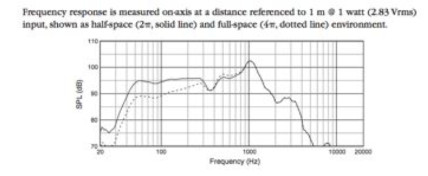

The measurement is from the JBL ASB6112 12" subwoofer spec sheet.looking around for some real measurement, here very nice from a scientific paper comparison 2 pi and 4 pi space, gain of six decibels(!)
https://jblpro.com/en-US/site_elements/asb6112-spec-sheet
It is interesting to see that the 2 pi (half space) condition imparts no gain above 1000 Hz, where the speaker baffle dimensions already create a half space condition similar to low frequencies on the floor.

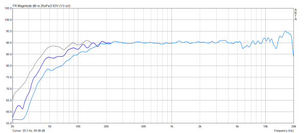

Looking further for someone who really did do measurements
https://www.jobst-audio.de/artikel/messtechnik-entwicklung/groundplane-nahfeld
light blue is fullspace
dark blue is halfspace
grey is quarter space
not measured is corner placement
Here what he wrote in german:
Hier sehen wir eine 2-Wege-Box im Vollraum (Hellblau),
im Halbraum (Blau) und im Viertelraum (Grau) - (Letzteres leicht unsauber gemessen, aber zur Veranschaulichung tut's das).
Wir erkennen ab wann es die +6dB gibt und bis zu welcher Frequenz hin wir Pegelzuwachs erhalten.
Die Schallwand entspricht hier 35x50cm.
in english
Here we see a 2-way box in full space (light blue), in the half-space (blue) and in the quarter-space (grey) - (the latter slightly uncleanly measured, but for illustration it does). We can see when the +6dB exists and up to which frequency we get level increases. The baffle here corresponds to 35x50cm.
Full Space - Actually like free field, we don't have a solid angle.
Half-space - There is a solid angle (e.g. the floor), the sphere (radiation from the bass) becomes a hemisphere.
Quarter space - 2 room angles, e.g. the box is on the floor and against a wall, the ball becomes a quarter sphere.
These are the solid angles, per solid angle we get +6dB level.

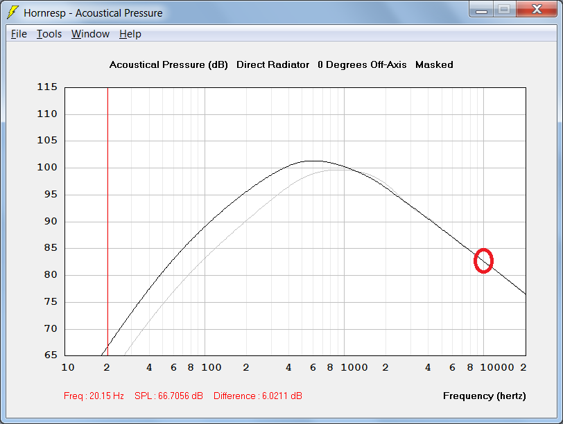

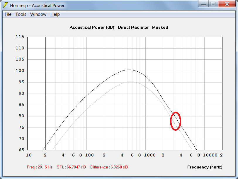

At very low frequencies where the radiation is non-directional there is a theoretical +6 dB improvement in both power and pressure response each time that the solid radiation angle is halved. 3 dB is due to the improved acoustical loading conditions (enabling twice the power to be radiated), and the other 3 dB is due to the doubled power radiating into half the space. Going from free space to eighth space therefore results in an 18 dB increase overall.
At very high frequencies the acoustical loading conditions do not change when the solid radiation angle is halved. There is a +3 dB enhancement in power response due to the same power now radiating into half the space, but there will be no gain in pressure response once the directivity pattern becomes narrower than the solid angle.
The chart below compares 2 Pi (black trace) and 4 Pi (grey trace) power responses:
The chart below compares 2 Pi (black trace) and 4 Pi (grey trace) on-axis pressure responses:
