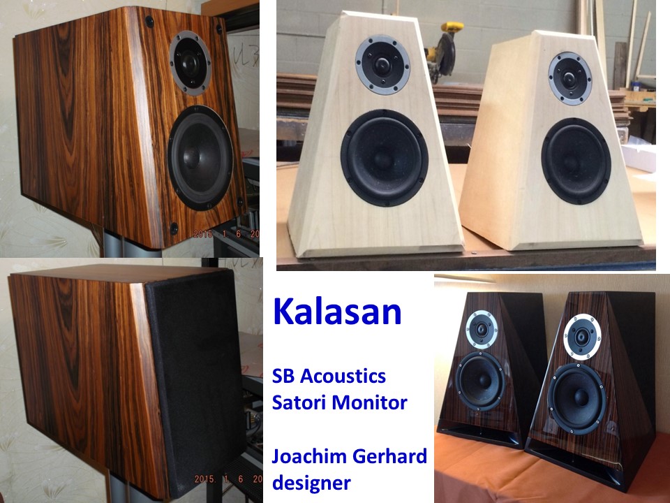

If you do not already own the 12mu-4731t00, you should consider building the Satori KALASAN. You will get a proven excellent sounding slanted baffle design with LR2 crossover circuits. You can later experiment with 1st order crossover circuits against the Kalasan. Add-on woofers are also discussed.
World Expert Joachim Gerhard created the Kalasan as an open design for SB-Acoustics.
The $52 SB29RDC-4 tweeter measures almost identical to the $132 Satori TW29R-4 tweeter used in Kalasan.

There are two common cabinets with slanted baffles for time and phase alignment: box with 6-degree slanted baffle; pyramid shape with slanted baffle.

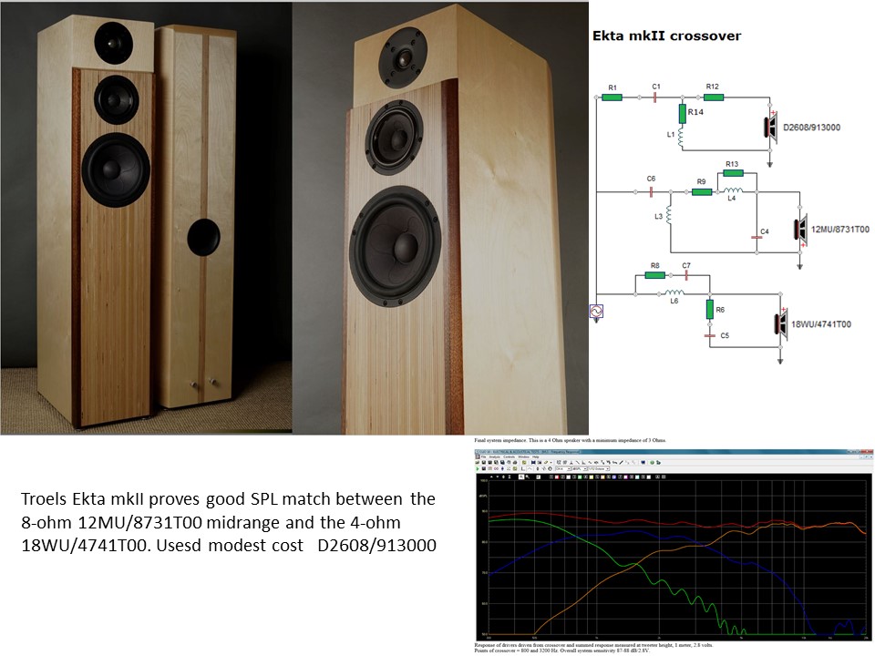

Troels Ekta mkII proves good SPL match between the 8-ohm 12MU/8731T00 midrange and the 4-ohm 18WU/4741T00. Uses modest cost D2608/913000 tweeter.
Troels uses physically stepped baffle with LR2 crossovers to achieve time and (good) phase coherence.

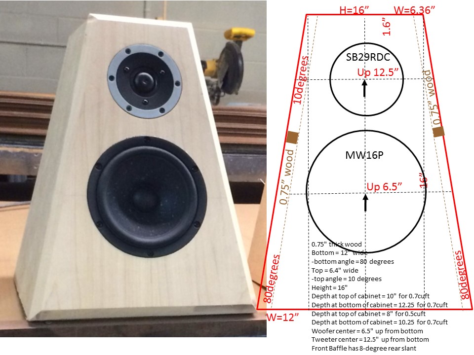

I saw the Satori KALASAN a while back - but no drawings for the pyramid enclosure. Do you know where / if they can be found?
The Ekta mkII is probably a good compromise, just a shame there's no information regarding if it's minimum phase or how the group response performs.

Joachim reports the Kalasan as being 'on the light and airy side but also liquid and low in fatique' - by what I read this seems to be the characteristic of SB acoustic drivers. So I think the SB acoustic drivers being so neutral would need an additional woofer section. This is one reason why I was looking at the 12MU(Illuminator), 18W(Revelator) and 18H (Acoustic Technology) mid ranges - all slightly warmer by what I understand.

The Kalasan slanted baffle box dimensions are 30cm wide, 40cm high and 24cm bottom-deep (11.8"W 15.8"H 9.5"D ~0.7cuft internal volume). There is a 25 - 32mm thick baffle. 8-degree baffle tilt
The Madisound Facebook pages on pyramid Kalasans suggest that no supplier for the cabinets was available. Pyramid Kalasan cabinet dimensions: Using the speaker diameter as a reference, you can put the pyramid cabinet pics on a grid to get the front baffle dimensions. 8-degree tilt. Adjust depth to produce ~ 0.7 cuft internal volume

Kalasan pyramid cabinet dimensions gleamed from pictures of light wood example cabinet with edge bevels. A starting estimate for your 3D CAD tools.
0.75" thick wood used
Bottom = 12" wide
-bottom angle = 80 degrees
Top = 6.4" wide
-top angle = 10 degrees
Height = 16"
Depth at top of cabinet = 10" for 0.7cuft
Depth at bottom of cabinet = 12.25 for 0.7cuft
Depth at top of cabinet = 8" for 0.5cuft
Depth at bottom of cabinet = 10.25 for 0.5cuft
Woofer center = 6.5" up from bottom
Tweeter center = 12.5" up from bottom
Front Baffle has 8-degree rear slant
The 12" bottom width can match a 10" or 8" woofer cabinet.
