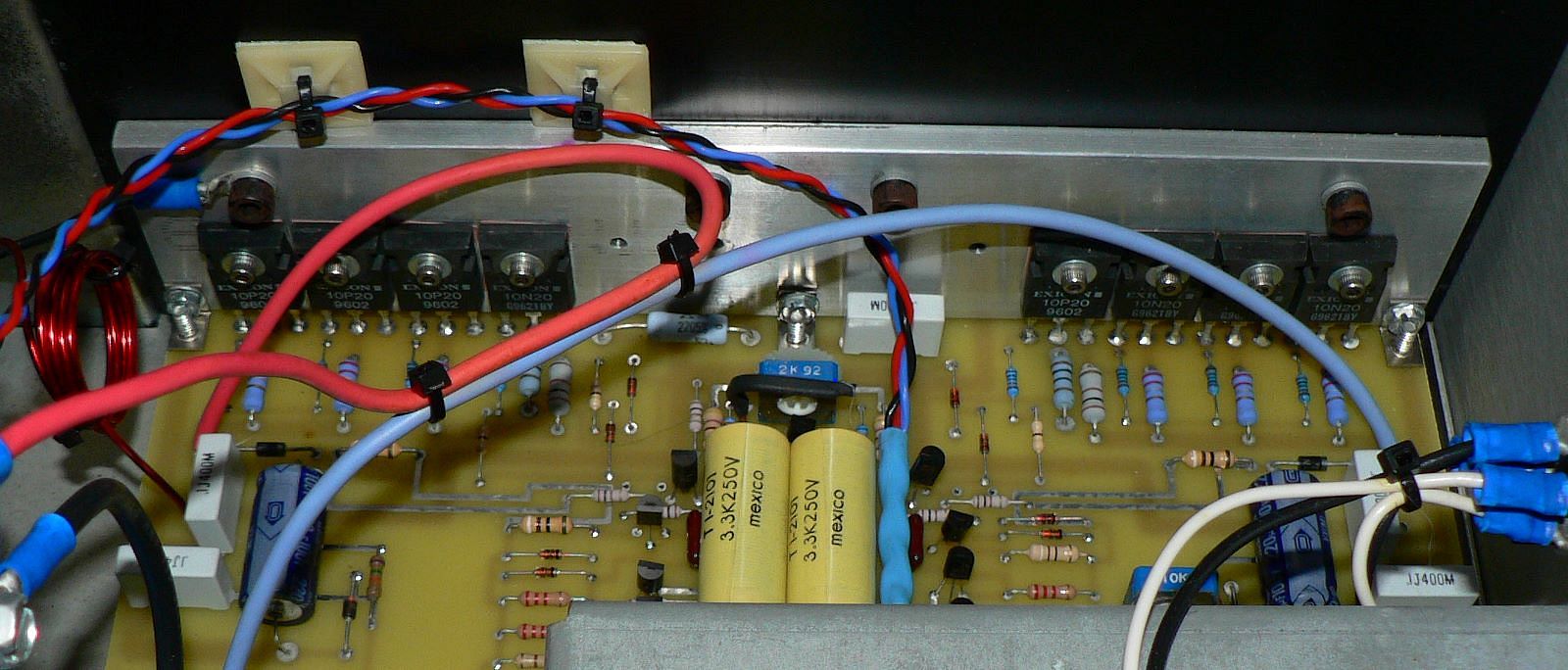

afaik the profusion laterals were diffused by semelab, element14/farnell stock quite a few of the semelab stuff under the different brands like alfet. profet i think are too, but regardless you should be able to find something suitable here
your links are broken btw, but i gather they were a 10A 200V part? unless you were really pushing them, the ALF08N20V and its complement might do the trick, but there are higher power double die devices like ALF16N16W
hope that helps
Rod Elliot recommends these in his P101 project. He shows them as an alternate to 2SK1058 and 2SJ162. I have ordered from Profusion and their service and packaging is great. Their standard shipping is fast but expensive. You could phone them and see if they will go with regular air rather than courier. I hope this helps. ( :

stoc005: Many thanks !!! Yes I see them - that's a weight off my mind. I still don't know why they 'went' in the first place ... all I was doing was checking DC offset with nothing at all connected to the Muse amplifier and when I reconnected the speakers there was bad distortion. 😕😕😕

mike, i linked you directly to 2 of them at farnell/element14 that could be substituted provided you can handle an: 8A rated device or a 16A rated device vs the 10A rated devices you linked. they are otherwise diffused by the same larger company: semelab but sold under a different name by a different company. the devices themselves are the same lateral fets
Sorry qusp, I was still 'rattled' as I hope you can imagine and stupidly didn't realise they were links :snail: Since these transistors are expensive (by my standards anyway) can you (or anyone) tell me how to test them. I tried a quick check in-circuit but got confusing readings so will drop them out of circuit this afternoon to check them. I have DMM with diode check facility but don't know what numbers to expect from these transistors. What should I read on a good one from:
PIN 1 Gate to PIN 2 Source or to PIN 3 Drain ... in easy baby talk please, like positive lead to X and negative lead to Y (or any combination as required) should read XYZ figure approx. I know I'm slow but really appreciate all help and I do learn (albeit slowly) from it.
Is it a requirement to change out the whole set (all 8 per side) or just the faulty ones?
By the way, what is the benefit of using lateral fets? I don't know a thing about them compared to 'ordinary' transistors.

Anyway, Mike. You can't really test a MOSFET like a simple bipolar with a multimeter. Google how to build a test fixture. Be VERY careful as they are ESD, as in static, sensitive. What makes a lateral MOSFET better than any other device seems to be up for discussion and I am not qualified to answer. Mr. Curl seems to hold different views from Mr. Self, than Mr. Pass, than...... All very bright gentlemen. As I am repairing a DH 120, I am using Lateral MOSFETS. It is what it was designed for. Will I when I try and build my own? Not a clue. I suspect the execution is far more important than the part until you get to the level of the folks fore mentioned. I like my MOSFET Hafler and B&K, but also my BJT Rotels.
These are lateral MOSFETS. No need to replace all if only one is broken. They have such a tempco that they will "equalize" themselves regarding the quiescent current even if you do not match them.
I bought from profusion recently, no problem for them shipping to Switzerland. And in my case way cheaper than Farnell.
In the ALFET, Magnatec, Exicon lateral mosfets, it's always the same chip.

Would appreciate your comments on an email I just received from a company whom I asked to repair the Muse 160 amp:
The Big EXICON 10N20 and 10P20 MOSFET transistors are no longer made and there are very many fakes available on the net.
One or more of these MOSFET transistors is defective, which is causing an extra load on the small driver transistor (causing it to overheat). As much as we would love to repair this unit for you, we would not be able to due to the obsolete MOSFET transistors used.
There are no equivalent matching units that we have come across and some folks on the web sell these for $40+ per pair.
In your case, the complete set (8 units) would need to be replaced to maintain a balance.
I then sent them info from this post and get this email back:
HI Mike
Thanks for the followup. We have been in touch with Profusion PLC and they informed us that the MOSFET was no longer made. The alternatives you suggested will work but are not the exact replacements.
Therefore, if you want to go ahead with the 8A modules, then you should replace these on both channels to balance the audio.
So if Profusion is out of the original Exicon's is the rest of the info okay to go on - and would you go with the lower power ones: SEMELAB - ALF08N16V - MOSFET, AUDIO, N, 160V, 8A, TO-247 or the higher power ones : SEMELAB - ALF16N20W - MOSFET,AUDIO,N CH,200V,16A,TO-264
