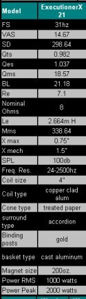

the executioner? well i really don't know much about how these numbers translate to sound, since i really can't afford to hear every speaker on teh market, but i do know, the executioner has an xmax of .75 inches (way more air moved than most big brands,) is rated 1000 watt rms and 2000 max, and has an efficiency of 100 w/db/m or whatever the unit is. it is rated to go from about 25 hz to i think 3000 (?.) and from what i have heard they are pretty strong and don't get damaged easily, unlike most other large drivers. compared to what other numbers i've seen out there for high end subwoofers, this is probably one of the loudest subwoofers there is. if only i had an amp strong enoough to find out... i barely ever see an RMS of 1000, and when i do, it usually has an efficiency of 88 or maybe 90. every 3 units of efficiency translates toa double in sound, right? you can do the math... i saw something called the "b52" (?) that was 750 watt rms and efficiency of aobut 104, i would imagine taht speaker is is louder, but it only goes up to 240 hz... anyway thats how they perform.

Find the T/S parameters for the Madison Executioner X, then use WinISD Pro to model an enclosure.
Do you have lots of space available? These beasts will need maybe 10 cu.ft each.

Since the Qts is so high, it's not so easy to design an enclosure to get flat FR. You'll need to use an EQ and a rumble filter if you go ported higher than 20 Hz.
You could go with 27x39x39 ported (deeper bass and 2 dB louder) or sealed (better driver protection).

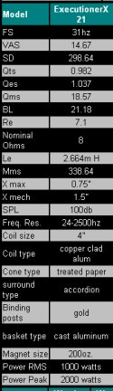

argh this program is frustrating, i can't make a spec sheet for my speaker because a group doesn't match (no, spl, rho, c) when i have it calculate thoe numbers for me, the spl changes to 92.71. thats not the 100 they posted on their website! someone please tell me how to figure out whats wrong...
That's because alot of manufacturers are lying about SPL.
It's not 100, it's 93, believe the program hehe!
They got that number by putting the driver in a small box so it's peaking and they measured 100 dB/w/1m, but that's not right because they'll achieve 100 dB only at 70 Hz.
If you use a box big enough, then you'll get around 93 dB/w/1m across the whole range, not just at 70 Hz.

Not everyone lies. Madison is kind of a "seedy" company - their stuff is made really cheaply. My favorite company for subwoofers is AE Speakers, but they don't make a 21". If you've got your heart set on a 21", then go look at a Precision Devices PD2150. Take a look at a recent thread here on the subwoofers forum, where "Geenius" uses a pair of PD2150 in u-frame dipole baffles. Those are some serious 21-inchers. But anywhere you go to get your 21" woofers, they will be expensive. So I recommend taking a look at a dual-15" configuration.

Not to further exacerbate the situation, but my Madison Executioner x21 actually measured lower than 93db -- mine came in around 89.5db with SpeakerWorkshop. Also, qts was higher (1.2) and fs lower (around 28 if memory serves me). These numbers are pre-breakin, so maybe after they're run in, both fs and qts might go down, but spl should be about the same. Also, the re on both of mine were high -- something like 9.8, I think.
With a qts around 1, I gotta believe open baffle or aperiodic are the only ways to go. There are a couple of guys on AA using these on 3'x4' baffles and say they get to 30hz flat. That's pretty big, so I think I would recommend linkwitz's dipole subwoofer and maybe a 250w and up plate amp.

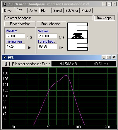

ok i have gotten the specs and played around in winISD. Not only do they seem to have an spl of 93, but they also are looking to be REALLY loud in this bandpass housing i designed. It gets an spl of 108 at around 70 hz, and close to that in surrounding frequencies. It also does pretty well down to around 55, but after taht it tails off, but still does ok at 35, then its just sorta lousy. (so yea i pretty much boosted the bumps and booms of a bassdrum, and got as much rumble as i could squeeze out of these things.) my crossovers are gonna be 4th order crossovers at 25 and 125 hz. 2 108 decibel speakers become 111 db of bass (141 max or something liek that but i don't know what max spl means,) i don't know much about how all these numbers translate, but i assume thats a looot of sound (for a pretty small housing too, 27in x 27in x about the height of between my nipples and neck.)

ok so maybe this will give you all an idea what its like, so if anyone has feedback, please tell me!

but usually i only go for ones with large spectrums of sound reproduction and good efficiencies
Precisely the two things that you can't trust when it comes to specs.
The usable frequency ranges from both speakers you mention are probably sucked out someones thumb (as they say in Holland 😉). The stated sensitivities could be true but are highly suspected to be false as well.
The way your simulation looks, you're probably creating a one-note-monster, which can be very impressive in making things rattle or for dB-drags but leaves you on your own when it comes to reproducing music. Most people will favor a more or less flat frequency response over a high SPLmax and most of the times this is the recommended strategy.
