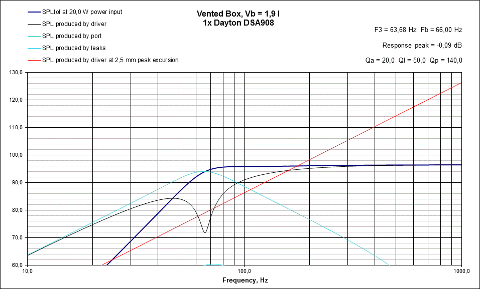

Hi all,

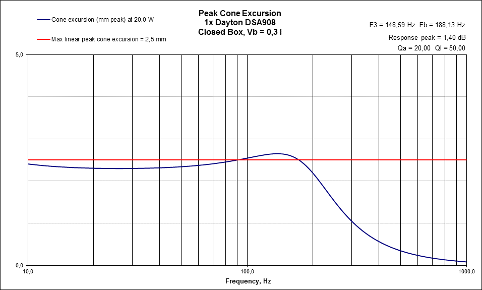

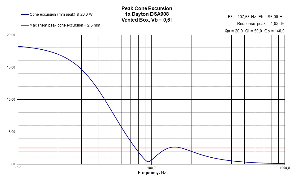

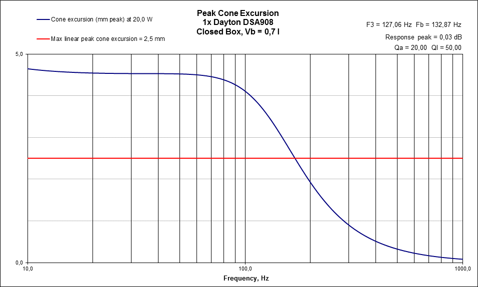

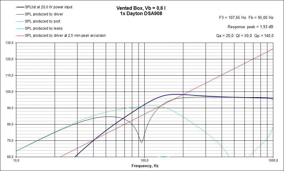

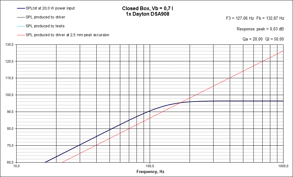

Long time reader, first time poster here. I've been reading up on loadspeaker theory for months now and finally decided to start my first project. As per advice of this and other fora, I'm starting out small with a simple 2-way speaker to start learning the ropes. I picked the Dayton DSA90-8 to be my low-mids / bass speaker for this project as its Fs of 66Hz is quite low for its size (3"). I couldn't seem to find one that goes much lower, but I'm running into trouble with modeling the enclosure. While the manufacturer states that Fs is at 66Hz, and that its usable range is 66Hz-15kHz, I can't seem to end up with a box that comes anywhere close to making this happen (safely).
Below, I've attached images (8) of the response and cone excursion for a sealed box, sizes 0,3L (1&2), 0,7L (3&4) and two vented enclosures at 1,9L (5&6) and 0,6L (7&8). Naturally, there's more options, but I used these to illustrate my issue:
I can't seem to get anywhere near 66Hz with a speaker that doesn't exceed Xmax, or inversely, to get the driver to work at 66Hz without exceeding Xmax.
Now, I realise a sealed box will always produce an F3 way higher than the driver's Fs. However, the apparent need to go down all the way to 0,3L of enclosure volume seems a bit wierd to me. 0,3L is rather small, and it also ruins the flat response. In contrast, the 0,7L sealed enclosure exceeds Xmax by nearly an additional 2,5mm. This can't be good for the driver, right?
Alternatively, looking at the vented enclosures, I can only get down to an F3 of 107Hz as well. From what I've read, shouldn't vented systems be able to at least get the driver's Fs into the flat portion of the response? In trying to design a maximal flat response vented enclosure, I end up with the 0,6L design, which produces the same problem as the 0,7L closed one. Am I doing something wrong? Is the driver just rubbish? Too small? Shouldn't I expect to get such low frequencies with drivers like this? If so, how do manufactureres of, say, bluetooth speakers do it with even smaller drivers?
T/S parameters Dayton Audio DSA90-8:
Thanks in advance!

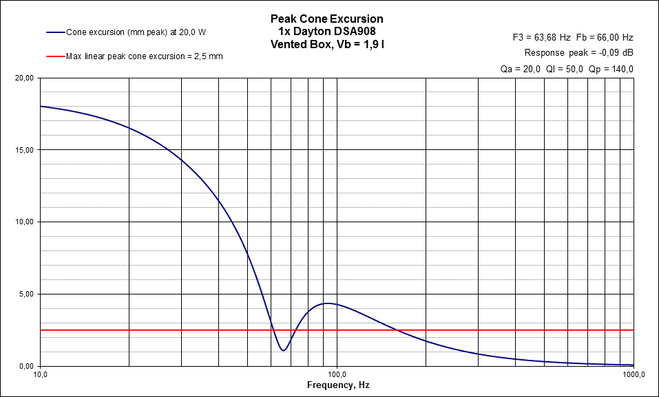

1.9 L vented enclosure looks OK (F3=63.68 Hz), in spite of 4.5 mm membrane amplitude. The driver will survive that.

I figure you mean cone excursion by membrane amplitude?
Anyway, how is 4,5mm OK? Won't the speaker distort if the voice coil starts going non-linear after exceeding Xmax? And how are you sure that the driver will be allright?

The distortion increases with the excursion, it's not suddenly switched on at reaching the maximum linear excursion. With great excursion you'll get increased distortion (especally intermodulation) before the Xmax is exceeded if you use the driver in the mid aswell or fullrange. If you go over the maximum linear excursion, it gets worse also in the bass.
On a ported enclosure the membrane swings 'free' below the port frequency, which increases the distortion vastly. If it is forced to play below the fb, you get practically no higher loudness but all the disadvantages of the high excursion. To prevent huge excursion, a low cut filter a bit below the tuning frequency should be in place, and especally no +EQing below the fb! Sealed enclosures will profit from a lowcut greatly too and both will be able to play much louder undistorted.
Edit: A driver with a Qts of 0,37 is usually not suited well for a sealed enclosure anyway.
Right, that makes sense. Thanks. However, this doesn't answer my question. How is it that 4,5mm excursion should be OK?
I mean, 2mm beyond Xmax is sure to cause distortion right? So is this normal? Seems a bit weird to design a speaker that's going to sound shitty as soon as you turn it up half way or so.
Moreover, how are you certain 4,5mm won't cause mechanical damage? There's no limits listed on the sheet, so isn't that asking for trouble?

Yes, 2mm beyond Xmax is really sure to cause distortion. With 4,5mm excursion you'll get intermodulation distortion already. The Dayton DSA90-8does not have 4,5mm excursion, the Xmax is just 2,5mm. You've listed it yourself, it's not 4,5mm.

The Xdmg is always quite much higher as the Xmax and some drivers got a progressive suspension which usually prevents them from crashing the VC into the back pole plate - which would damage the VC.
Very high membrane amplitude surely will cause mechanical damage ("bottoming" voice coil against plate), but usually Xmech is about 2 times Xmax, so you have about 5 mm living space. Of course there will be more distortion above 2.5 mm. By the way, you don't have to turn on all 20 watts. With 10 watts input power membrane amplitude will be less than 2.5 mm.Moreover, how are you certain 4,5mm won't cause mechanical damage? There's no limits listed on the sheet, so isn't that asking for trouble?
ICG gave good advice - use low cut filter below tuning frequency.
Yes, is the short answer. Driver is small so in order to reproduce LF it has to move further, and then your Xmax problem. There's no free lunch with sub freq, bigger is usually better.Too small?
But if you really want to use it, you can exceed the Xmax quite a bit without hurting it, as others have said.
